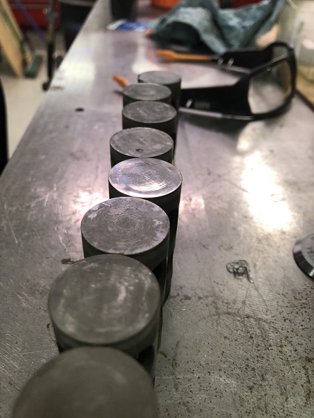

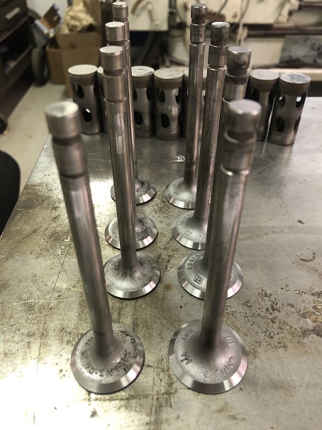

Bead blasted and ground the valves today. They cleaned up pretty nice. The worst wear on the stems was a little over .001". Most of them were about a half a thousandth so I think I'm OK there. I am planning on replacing/relining the guides.
Next up will be resurfacing the tappets.

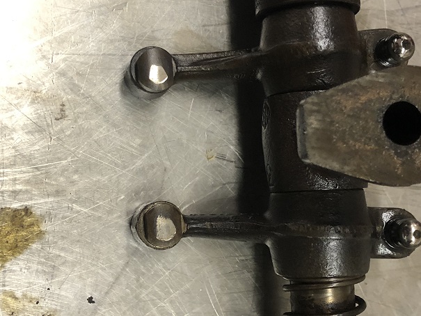

I know some people will Dremel the rocker surfaces to clean them up but I am thinking about dressing a wheel to the correct radius and cleaning them up on the surface grinder. Am I overthinking this? IMG_1842.JPG
13,275
7,484

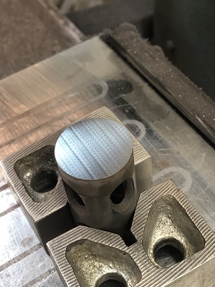

Not if you have the grinder and dresser. What geometry is used on the tappets?
Yooper
3901 LA525
May 31, 2015
1,766
945
NE Wisconsin

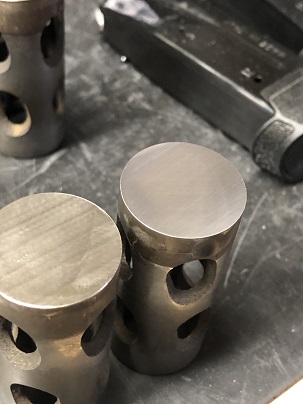

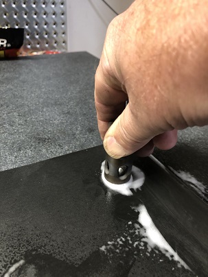

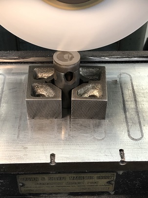

Ground the bottom of the tappets. All cleaned up at about .002"
Then on to the surface plate with some 600 grit to polish them up a bit. I use glass cleaner for lubricant.
Before and after polishing

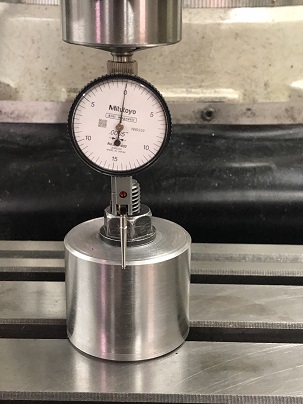

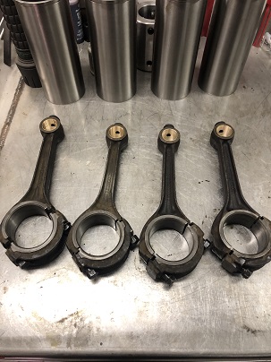

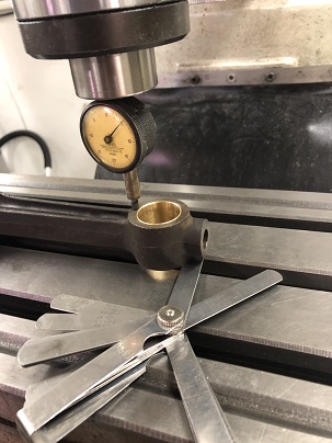

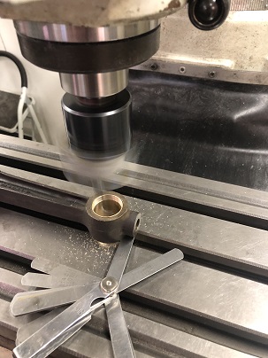

Today's project is replace the wrist pin bushings and get them ready for honing. I pressed the old ones out and pressed new ones in. The new ones were about .014" undersize after installation so I made a set up in the mill to bore them out perpendicular with the crankshaft and leave about .005" for honing. I machined out a piece of round stock on the lathe to plus .001" of the rod crank pin journal and mounted this on the mill bed. Then I indicated it in to within a tenth.
Then I torqued the rod to the fixture and then used gauge blocks and feeler gauges to shim the wrist pin end to take out any deflection from the boring head tool pressure.
Set up the boring head with a new high speed steel boring bar because the light cut would not agree with a carbide bar.
All came out well and made for a fun day! Just waiting on some tooling for my antique Sunnen hone to finish these up.
