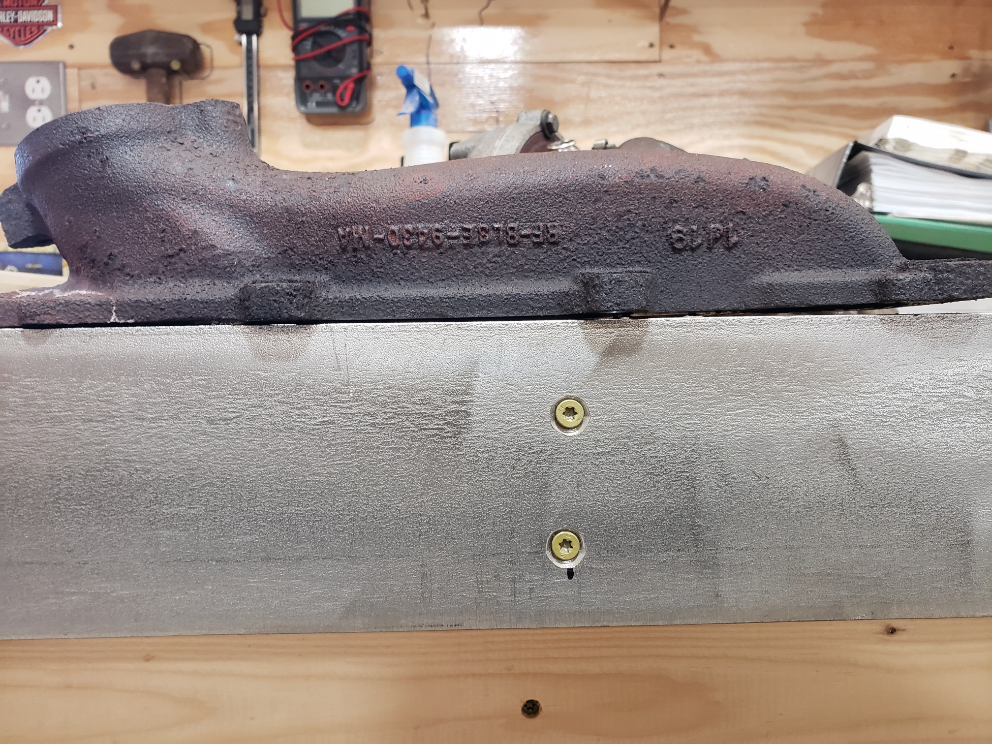

You can see how warped the manifold is on the right. Both were like this. 10 year old truck

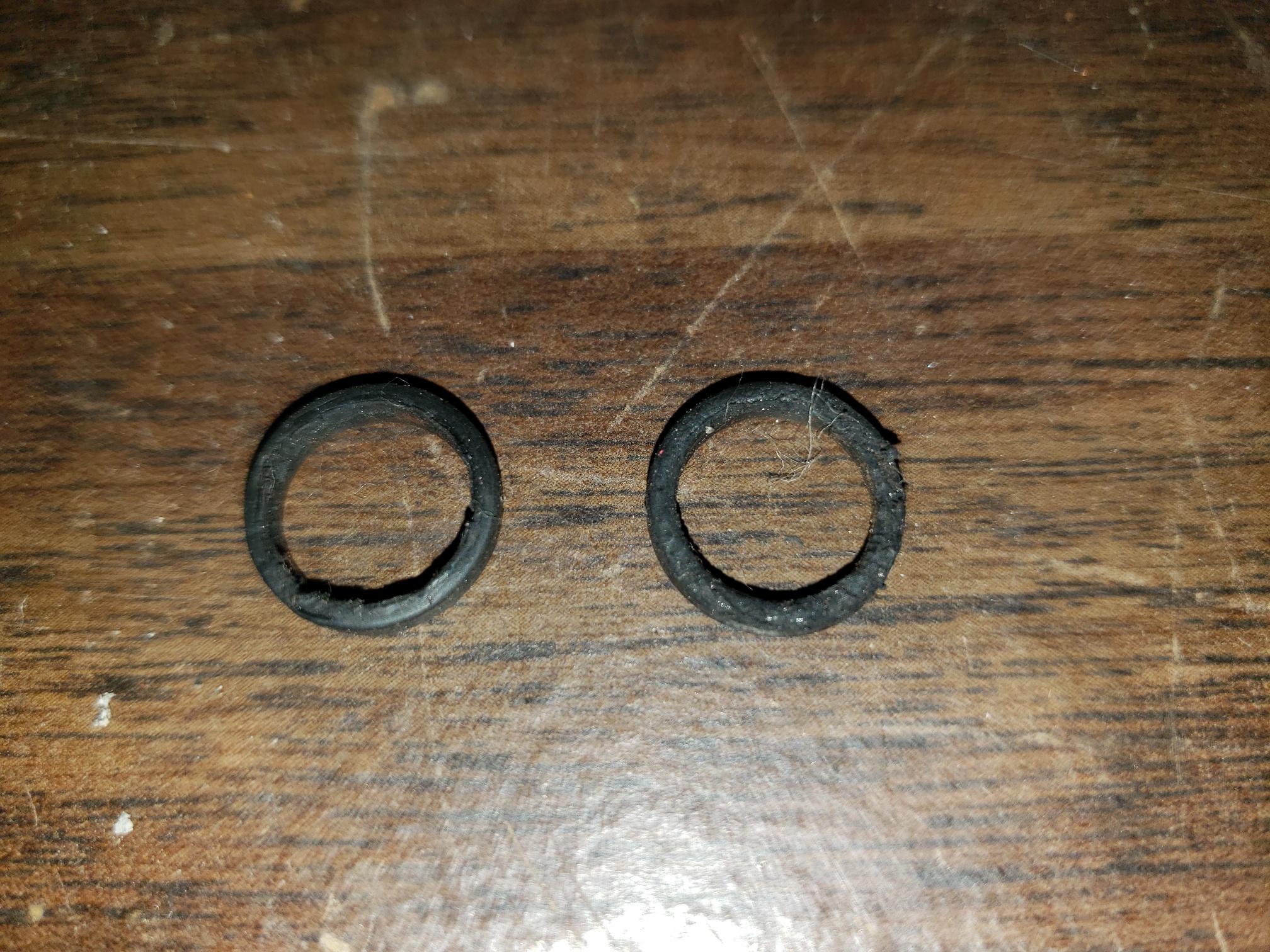

These where the sealing orings inside of 1/4" coolant line fittings. Look how messed up they are. only one of these was leaking but the other was on its way. only 10 years old.

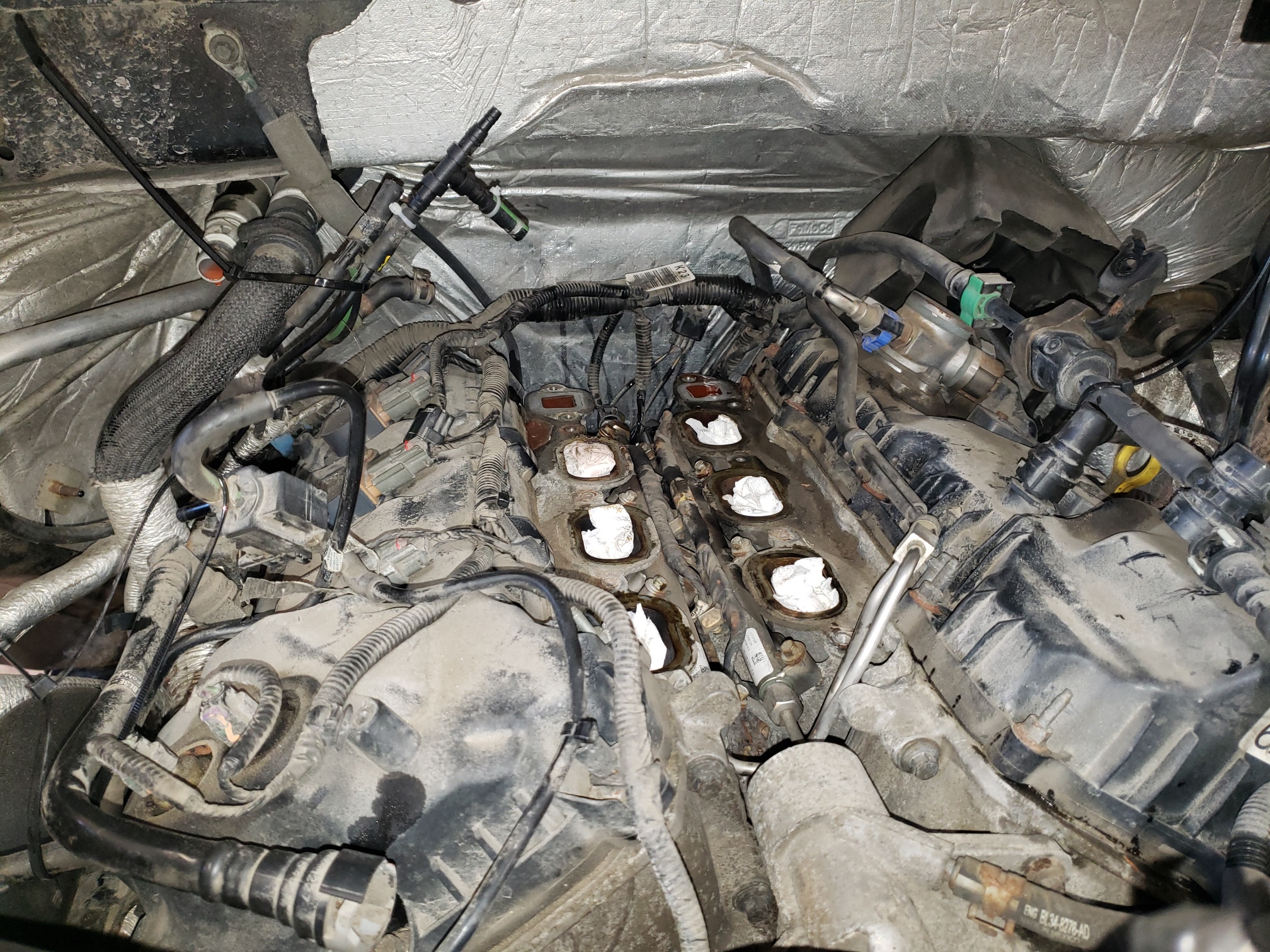

Got to tear the engine down just to reach a coolant fitting....on a 10 year old truck...ughhhh what a PIA

hmm, is the warping due to not retoking the bolts every year ??
no its a bad design, too few studs where it matters resulted in broken studs. The new oem manifolds are different and utilize more studs because they know the original design failed. Wish they would pay me for thier failure.
Well, I am no Ecoboost expert but with that much warpage, you probably had a lot of air being ingested that would make the A/F ratio oxygen sensor add more fuel. I am not sure how much hotter the turbos would get due to the extra air and fuel but the catalytic converter tends to melt inside with the high temperature. I would check the turbos and the cats before reassembly to avoid additional headaches later on.
Turbos looked ok, one is newer than the other so changed before i bought the truck. Never threw any codes
