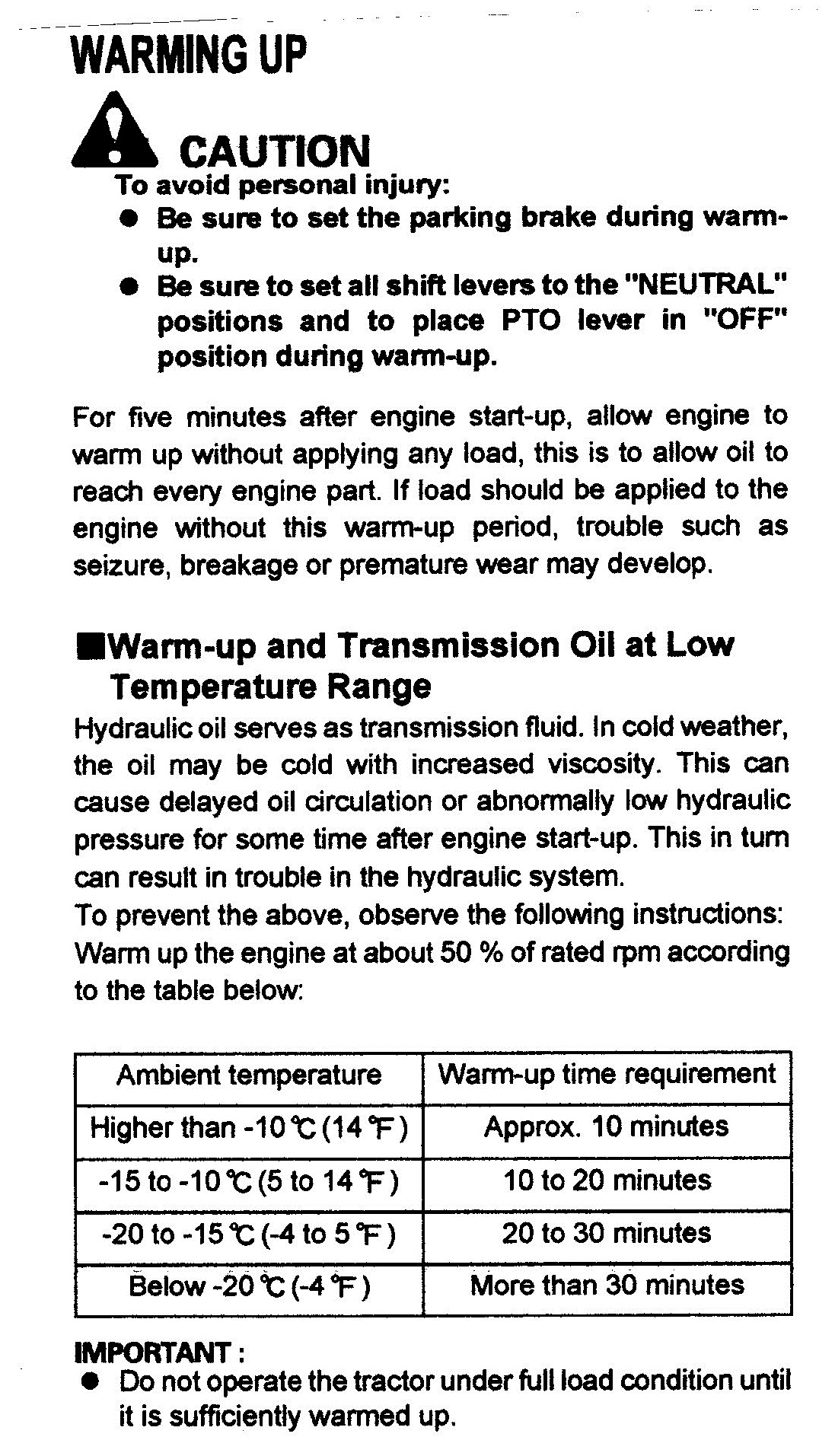

Kubota manuals contain a chart about getting the tractors ready to use in cold weather. Their concern is with the transmissions and hydraulics not the engine.
In your situation I would leave the block heater powered up during the warm up.
