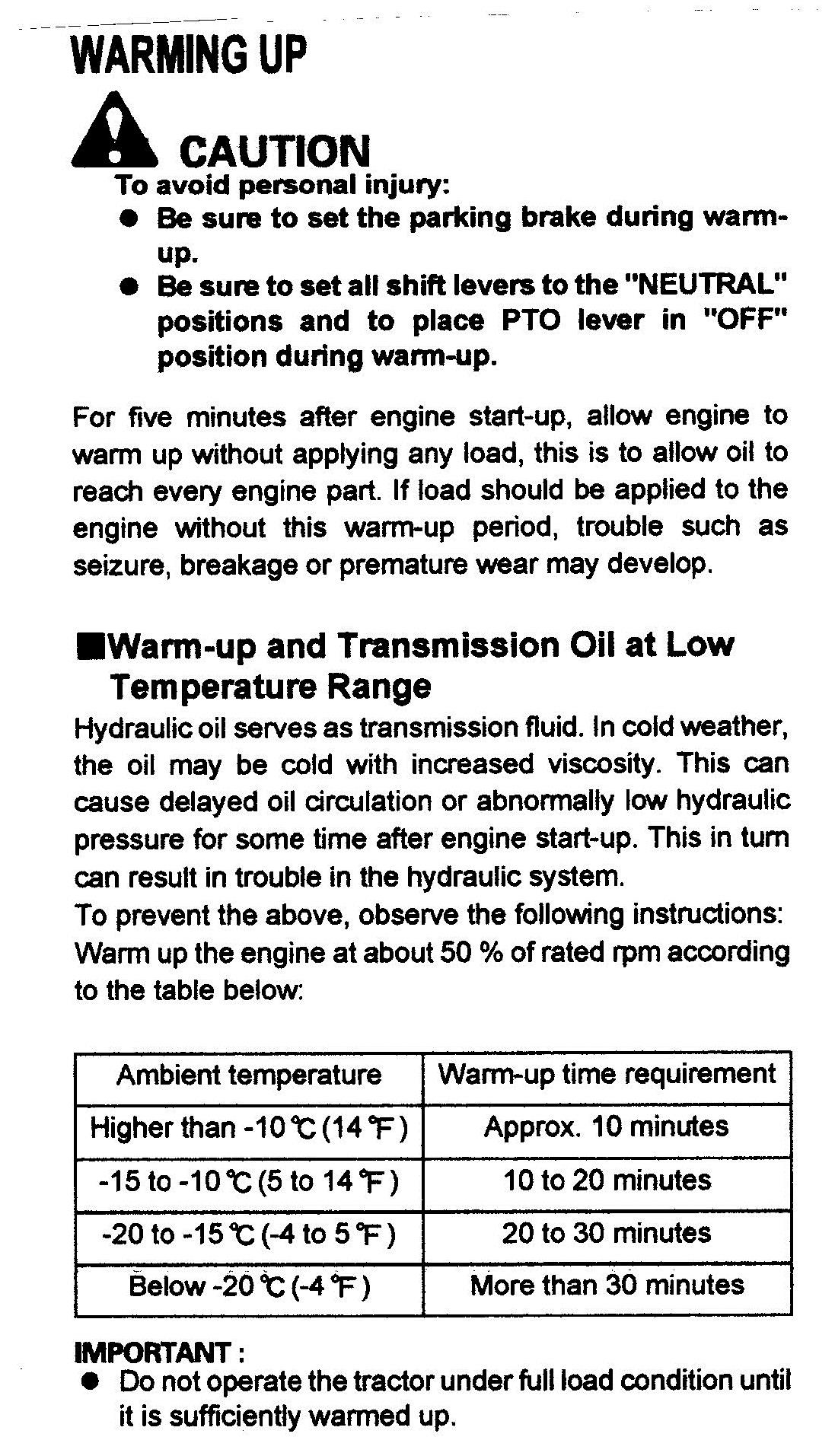

Kubota manuals contain a chart about getting the tractors ready to use in cold weather. Their concern is with the transmissions and hydraulics not the engine.
In your situation I would leave the block heater powered up during the warm up.

From the chart above, what is considered 50% of rated rpm?
50% of PTO rpm ?
50% of PTO rpm ?
I take 50% of rated to mean if rated engine working rpm is 2500 rpm then 50% of that is 1250rpm.
I like to start and warm my B2650 at a strong idle, around 1250 rpm, anyway.
To that end, when I park the tractor after use I set the throttle lever to hold rpm around 1250 rpm, then shut it down there. Then when I start it cold, it's already at a strong idle.

Thanks nbryan , You also answered another question I had about shutdown rpm.
That is close to what I've been doing.

They don’t recommend warming it up at idle. The instructions indicate to warm it up at approx half-throttle.
I've been warming up the engine at 1,600 rpm before heading down the driveway but maybe for not as long as I should. I'll increase the warm up time before engaging the snow blower.
