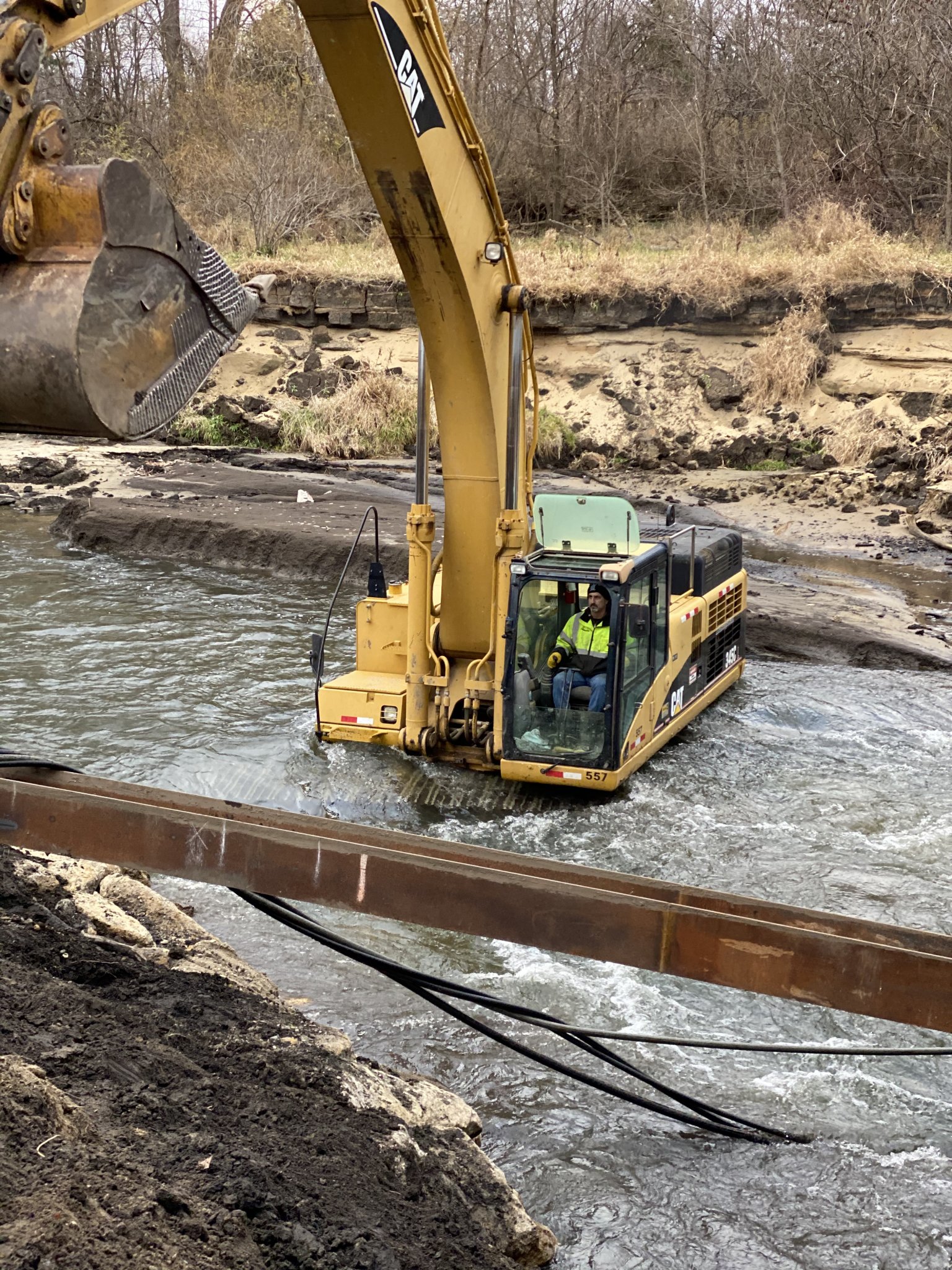

Agree with everyone’s comments. I spend a good portion of my day at a local hydro dam demolition site. I am totally in awe at the skill of these union operators. Several of us are looking at uncovered relics and earlier this week I spotted a 12oz can in the mud at bottom of an excavation. I asked “Jerry” if I could climb down to look at can and he said he would bring it up to me. Wish I would have videotaped it. Using the bucket teeth on his CAT 345C he picked up that can and delivered it to my feet!
My BIL is an operating engineer and when I watch him operate equipment it’s like a smooth “dance”. I think I’ve learned lots from just watching these guys and gals.
Here’s a photo of “Jerry” working in the river.
