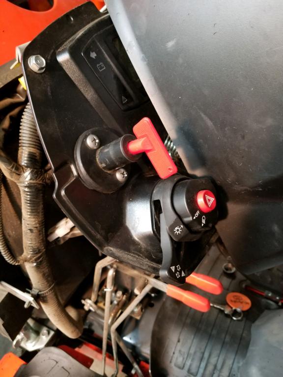

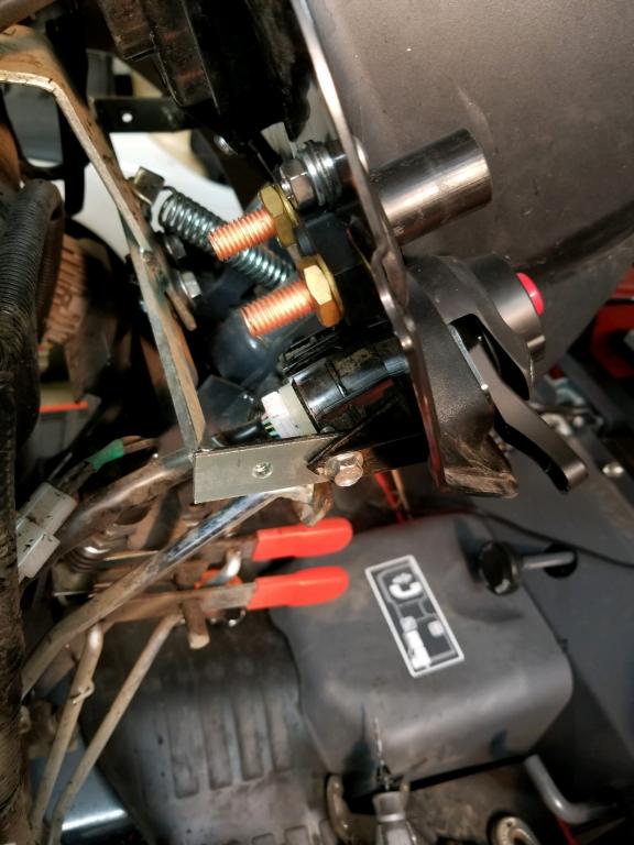

I use a 1/4 turn battery kill switch wired to the battery side of the starter.
When the red key is not inserted and turned, trying to start the B2650 makes a clicking sound like a dead battery.
I have a small white pvc pipe cap that fit's over the 1/4 turn key hole and looks non-de-script when parked.
