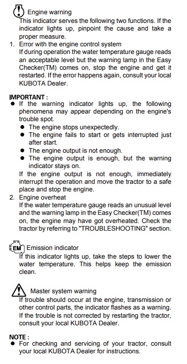

Harrlee,
I was looking through the manual. What light is actually on? Is it number (10) in the attached diagram for "Engine Warning Indicator" ? Or is it perhaps (6) "Master System Warning Indicator" ?
If the Master System Warning Indicator was the light you see, it should also display an error code in the hour meter display location, according to the owners manual. I'm assuming the light you are referring to here is the "Engine Warning Indicator" I scoured the entire manual regarding this light, and every reference to it is regarding the DPF regeneration. Im not sure how familiar you are with the DPF systems on these new tractors. They have to run a regeneration cycle every so often to burn off the particulate matter collected in the filter. You can however cancel this process if it begins at a time you do not wish it to run. However, if you keep cancelling it, you can start to run into problems. You should however have also heard a buzzer warning at some point leading up to this light. First the light would flash with the buzzer, and then the last warning is the light stays on permanently with a buzzer sounding every second. You didn't mention any buzzer sounding though so Im not sure if you may be talking about some other lamp on the dash, or if perhaps this indicator could come on for some other reason. I will attach relevant pages that cover the instances the manual mentions this light here.

I told you wrong. There is one other mention of the engine warning indicator in the manual here:
