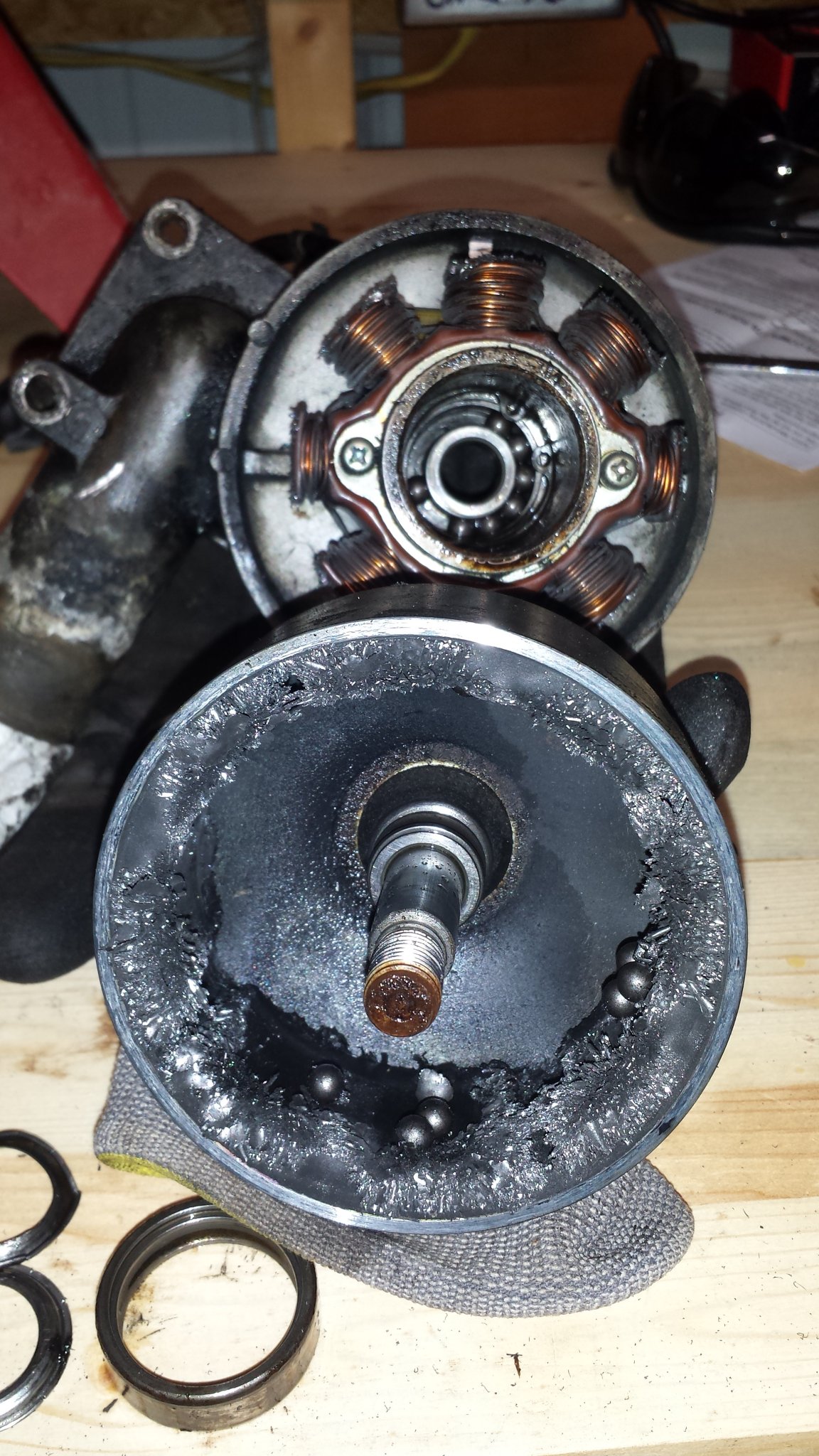

as Jay say - cheap and easy to produce. These devices are almost bullet proof - the only thing that goes bad in these devices are the set of bearings ..... BTDT!
Here is the inside of a "dynamo" that the bearings decided to exit stage left!
Notice the filings and bearings and how they are "stuck" to the magnet.
EDIT - In Utopia beat me to it!!!

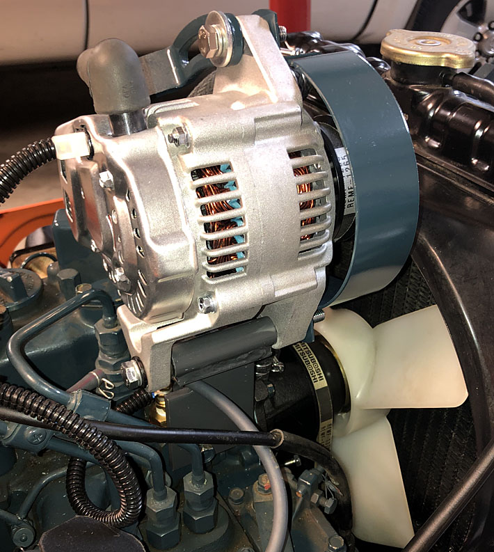

You can upgrade to a standard alternator, pending you find (or fab) the necessary bracketry. Here is a pic of my setup:
