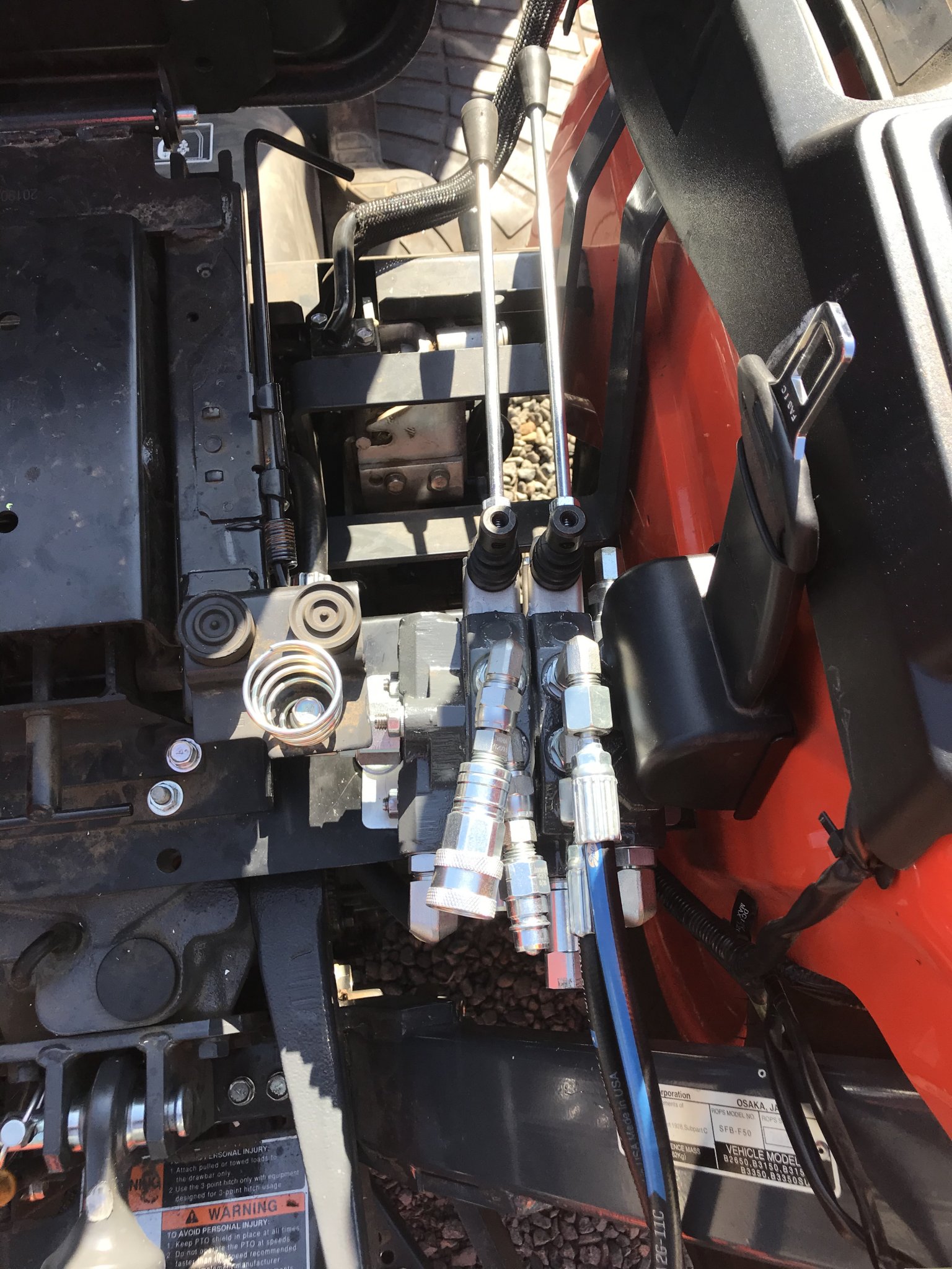

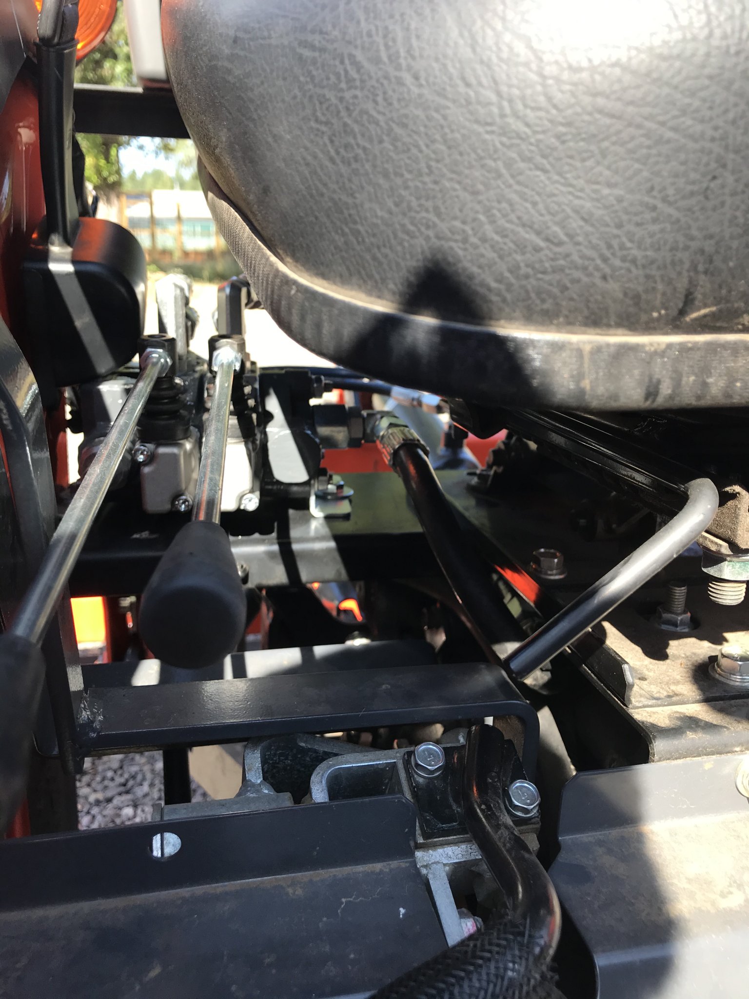

Ok. Just about done. I Found what appeared to be a usable 14mm x #6 JIC banjo, but it was waaaaayyyy too small to try to bore out. Rather than order another one like Eipo used, I decided to modify what I had. I cut apart the long banjo tube from the 3rd function kit that feeds the 3PH and made my own banjo with a little TIG welding.
rather than bending the handles, I rotated the valve body just a hair off straight when mounting, so the levers are in a good spot. Question for Eipo though... You mentioned the float position being further from center than the first valve you had. My Bucher, which is the same as yours, seems to be a long ways. I’ve got my float valve in the same spot, but the valve handle hits the metal pan beneath it right as it goes into the float detent. I haven’t tried it with pressure on it yet, but it seems like it may not work unless I bend the handle up a good bit.
Something I was able to do though, was retain my seatbelt. I flipped the retractable pard around and bolted it through the fender, just above the valve stack. There was a hole the correct size just waiting for me! I’ll share a photo when it’s all done... may not be quite as strong as the original mount, but I bet it’ll hold me if I ever tip over. I did place a good sized washer under the nut to help distribute the load. I bet the fender may bend, but I doubt it would fail any easier than the long piece of flat bar and the leverage that would be prying against the single fastener...
Chad D.
Sep 21, 2019
255
131
Eugene
Taaa daaaahhhhh. If it fits, it ships! It’s a tight fit, but it certainly did. Many thanks to RKidd and Eipo for making this thread the success that it is. I would not have put this together without the detailed information that was provided!
as you can see in the photos, my install is almost identical to Eipo’s, with the addition of the seatbelt. The XL fittings I had must not have been quite as tall as his, because I had to splay to QD fittings out a touch to make them usable. I didn’t use any NPT other than the drain line barb fitting and the QD adapters, so mine is fairly compact.
The home brew banjo fitting worked perfectly, and seems to be holding pressure just fine. Time will tell on fhat one...
Now, time to get another cylinder and make that rake spin!!!

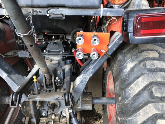

All wrapped up. My original intent was to run this around the back side, but the 3 point arm would interfere with it in the raised position. I sized the hose to run that way, so it was a relief when it was the PERFECT length to run around the front of the seat support and under.
Here is the banjo to JIC fitting.....
This shows the power beyond port at the loader valve.... I did have to loosen the connection just above this to spin in the fitting, but it didn't need much.
Now for some part numbers....
From Surplus Center...
Valve: https://www.surpluscenter.com/Hydra...rince-MB21GB5C1-DA-Valve-w-Float-9-7862-F.axd
Cylinder: https://www.surpluscenter.com/Brand...Double-Acting-Top-Link-Cylinder-9-7682-08.axd
Sae 8 Oring to 3/8 female pipe thread 90 for the power beyond at the loader valve. This replaces the Kubota part which is a SAE 8 Oring to 3/8 male pipe thread that you have to put a 90 onto anyway : https://www.discounthydraulichose.com/6805-08-06-8-saeorb-male-x-38-nptf-female-90.html
3/8 male pipe thread by male pipe thread for the 90 in the loader PB port: https://www.discounthydraulichose.com/5404-06-06-38-nptf-male-x-38-nptf-male.html
From there you'll make up a hose with a Female swivel pipe thread to connect to the PB port and run to the valve.
For the PB port on the valve to the 3 point, whatever manner of fitting at the valve to accomplish the connection based on where you mount the valve.... But You can replace this part...
https://www.messicks.com/part/7j056-84300/tube-pb-fl
With this one....
https://www.discounthydraulichose.com/3059-06-06-38-male-jic-x-38-bsp-banjo.html
And save yourself some more money AND not have the hose connection hanging down closer to the tire. The hole that the banjo bolt goes through did need to be reamed out a little... My bolt measured 16.84mm and the banjo hole was 16.72mm. I chucked a drill bit into the cordless drill and opened the hole up till the bolt fit. Took about 5 minutes.
The rest of the fittings are whatever you need to make it work on your tractor. The banjo bolt for the 3 point is a 6, or 3/8 BSPP thread.
