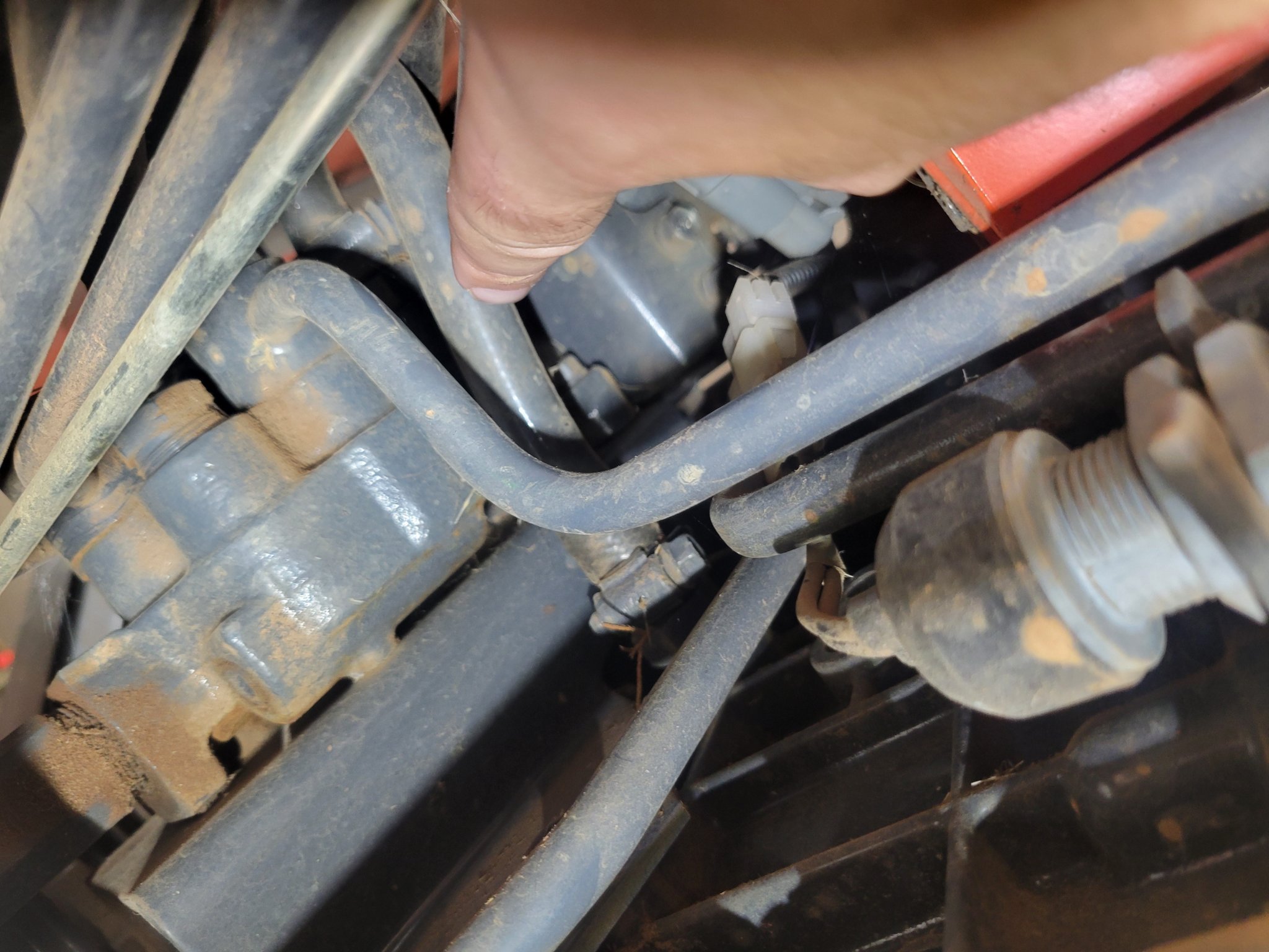

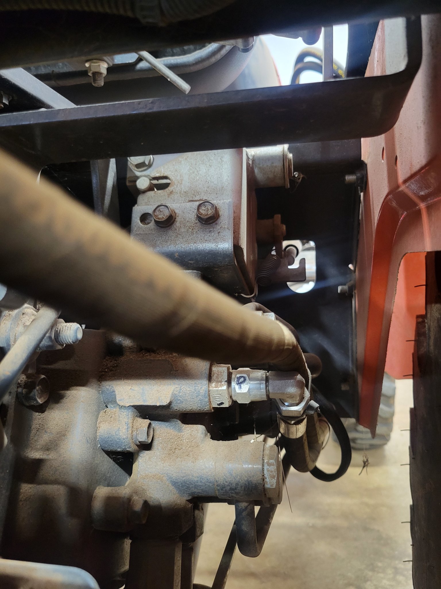

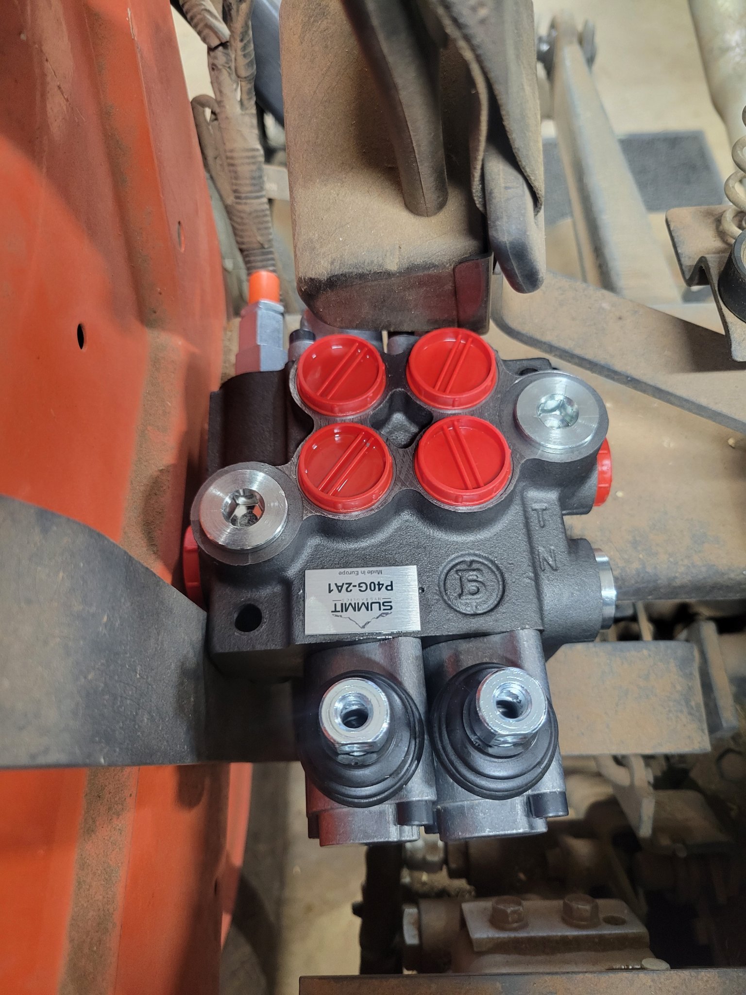

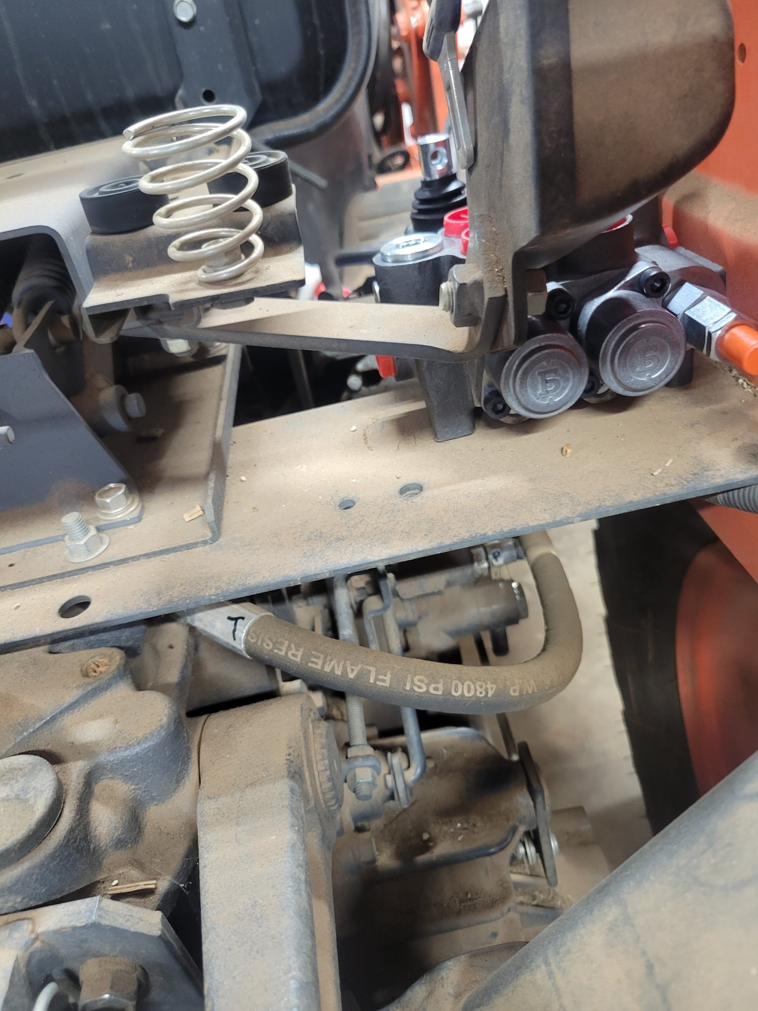

Bumping this back-up as I finally had some time to mess with this project. I'm 95% sure I follow the steps above but wanted to double check before I go ordering fittings and making up hoses. I've attached pictures of my B2650 that already has the summit 3rd function installed.
1. I will remove the line connected to "T" on the 3rd function, from the tractor side.
2. Run that line to "P" on the new valve. (I can move the plug from the top to the side correct?)
3. Install my power beyond adapter into port "N" on the new valve and run a short line from that to where the line removed in step 1 used to hook up on the tractor.
4. Install a fitting in port "T" and cut a tee in the rubber hose being pointed at in the last picture.

The narrative sounds correct but are you sure you have correctly identified the hoses labeled P and T ?
The one labeled P should be goung to the T port on the third function.
The one labeled T should be going to the T port on the loader valve.
I cant make heads or tails out of the last picture. Why not install a tee on the end of the hose you have labeled T? Those are all 2 wire hoses and I would not cut them.

The labels on the hoses in my pictures correspond to the ports they are installed to on the summit 3rd function kit. It is installed exactly like these directions & pictures show. https://www.messicks.com/uploads/assets/380-168a_color_copy.pdf
OK - despite the words they use there is no tank line in the Landpride intstructuons. Let me try to make it simple. To install the Summit valve:
  1. Disconnect the hose under the seat that you have labeled T and connect it to P on the Summit valve.
  2. Run a new hose from N on the Summit valve to the fitting under the seat. That completes the power beyond loop.
Now all you have left is to run a hose from T on the Summit valve to tank on the tractor. I am not clear where you planned on doing that. Could you clarify please?

Perfect, thanks a bunch for helping me with this!! For the T port on the Summit valve I was going to run it to the line in my last picture. I've seen similar pictures on here. That line is just painted gray but it is a simple rubber line from what I've gathered, a simple brass tee and some hose clamps would work i believe. Or is there more pressure on the T port from the new summit remote valve I'm not considering?
10,773
5,892
Brass tee and hose clamps should be fine.
