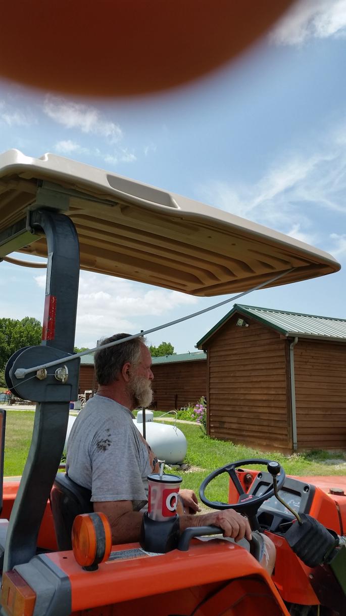

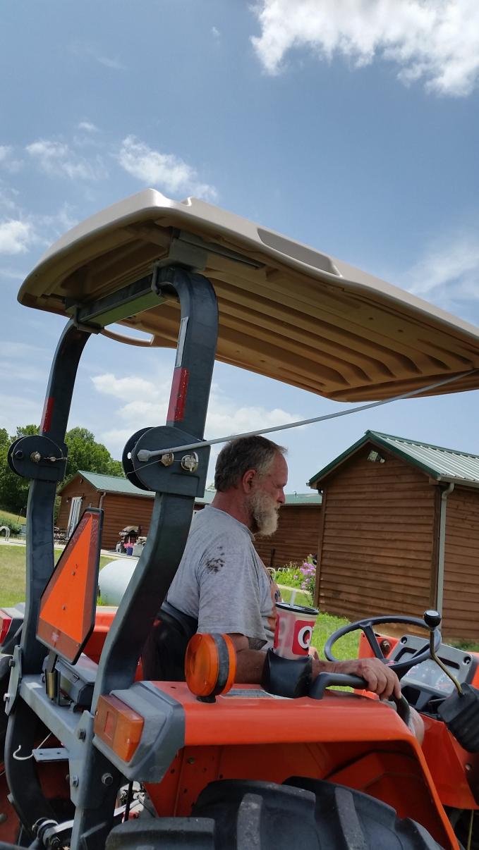

I built a canopy for my neighbor's MX5200. I went from the front of the canopy back to the ROPS existing hole. It's out of the way, extremely stable, and no holes in any tractor parts. Once I determined the length of rod needed, I welded a washer at the bend and put a hole for a hair pin on the inside.

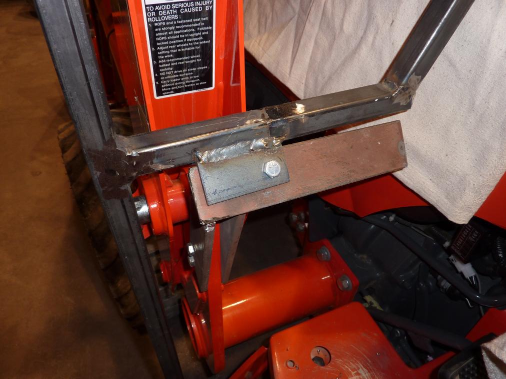

Not for a canopy, but when I built my cab, I used the joystick bracket and built another opposite-hand bracket to bolt to the left side of the loader support. The cab connection that bolts to the bracket with one bolt on each side is a short piece of angle. Since the angle bears on the bracket, the bolt's main purpose is to keep the cab support from sliding around.
The loader isn't on the tractor unless I'm using it, and that allows me to have cab support whether the loader is on or off. The factory bracket and the one I made are pretty robust.
Th rear cab supports also have clip angles for bearing the weight, and a total of four bolts hold the cab to the tractor. Although I fabbed the cab in sections for easier on and off, I haven't removed it for about 5 years. I just lift the doors off in warm weather.
Nice job chim, no worries where you poked the holes.
