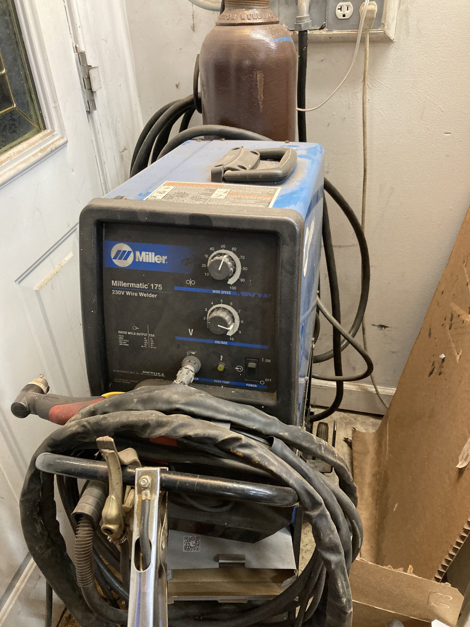

Somewhere in the 90's I bought a Millermatic 175 MIG/Fluxcore machine. Love it but if I had a do-over would definitely get a dual voltage unit. Glued a lot of stuff together using both processes. Used it to build a tractor cab and various tool fab and repair. It's able to run with gas and solid wire or fluxcore wire and no gas.

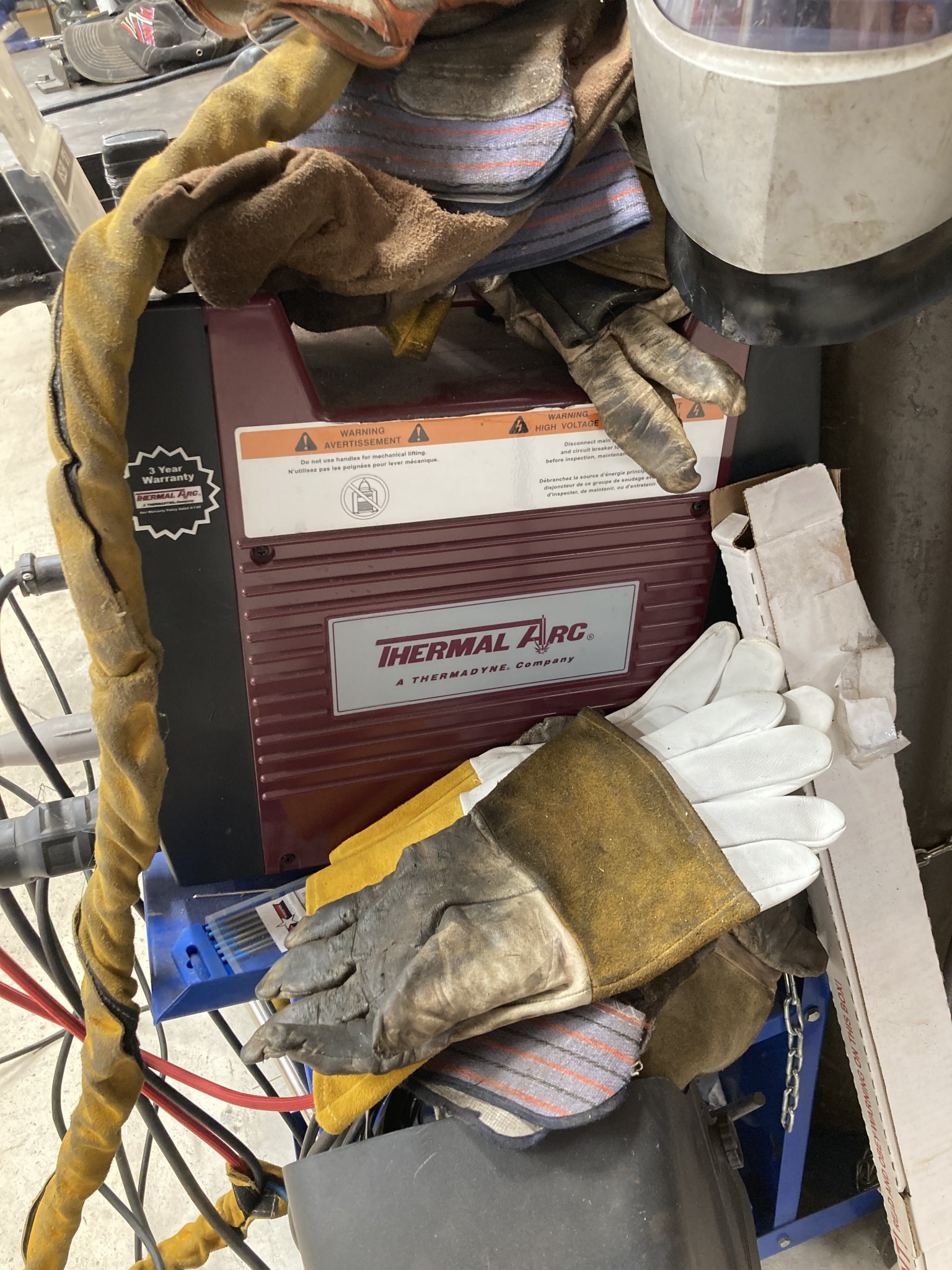

I was/am very happy with the performance of these 2 machines, although I don't think the Thermal Arc is being produced any longer. (at least under that name)
Both operate off 220.
