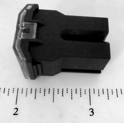

You very likely have popped the main fuse.
It's called a maxi fuse, and it's down by the starter.
You can pull the fuse 50AMP and go to an auto parts store and get a replacement.
36,560
11,305
This is what it looks like:
And here is where it's at.
