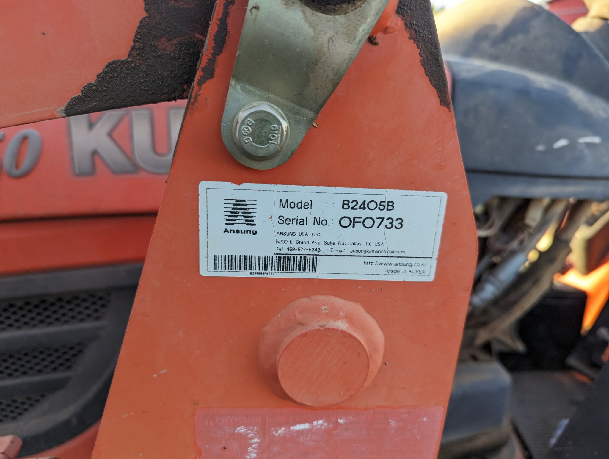

I got a picture of the model # I added & somebody asked for more detailed pictures but Im not sure of exactly what, so Ill comb through the responses again to see what was needed & will post those too very shortly. Thanks again!!! 🤘🖤🙂

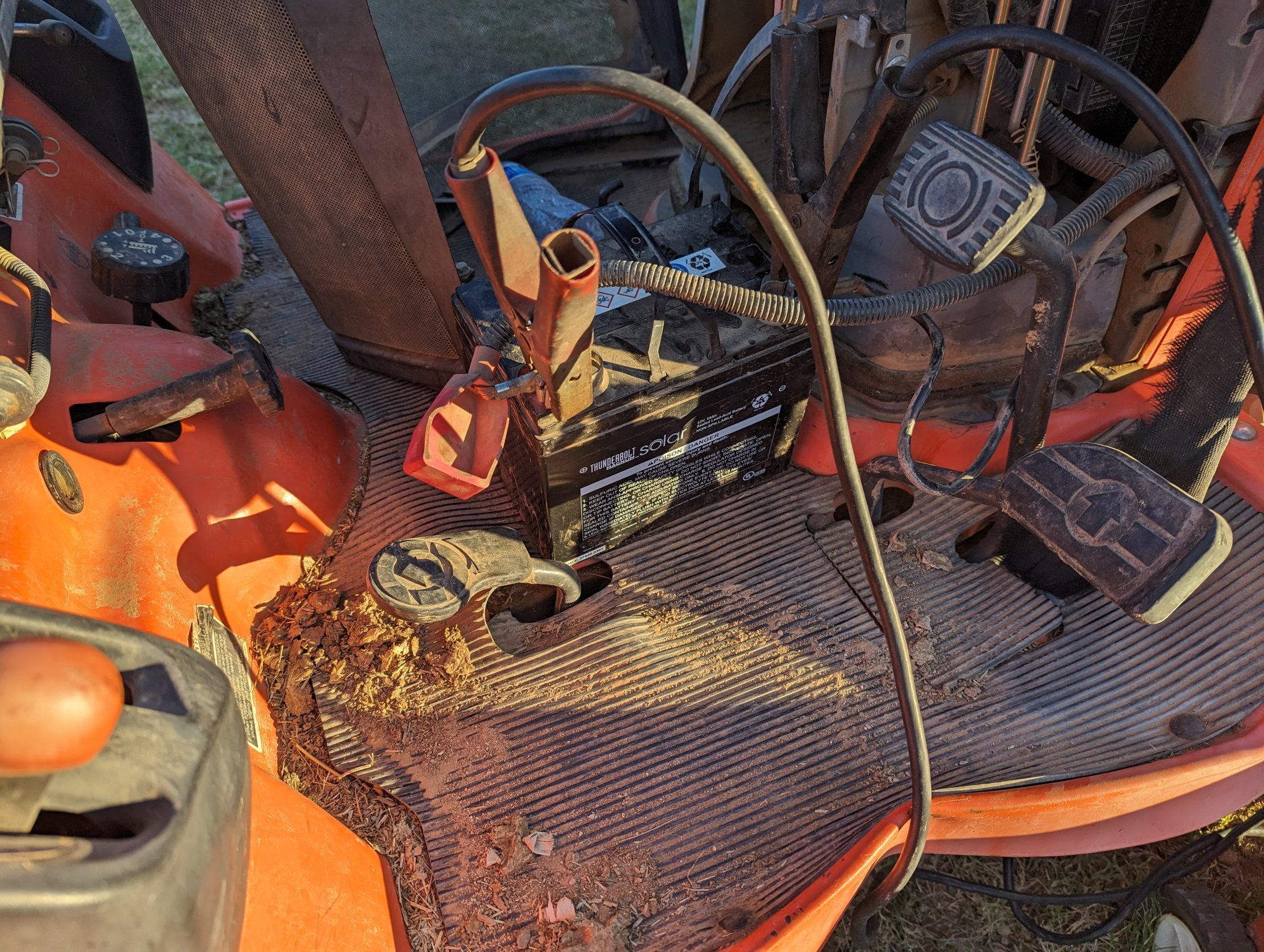

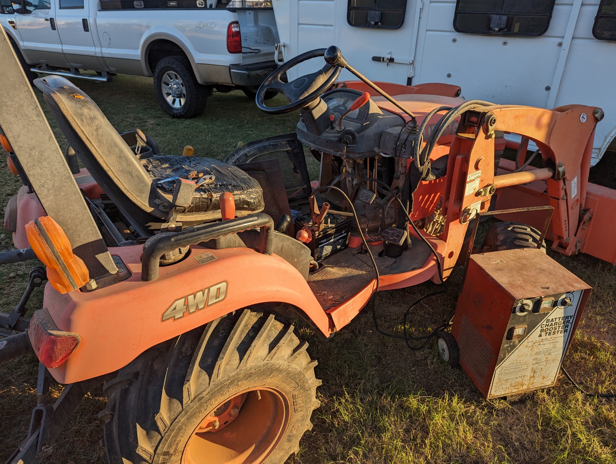

Yes, it was running just fine till i shoved it back into that tight little space it sits in under the steering column, than it just shut off.
Its outside & too dark to do anything right now but heres 2 pictures I took earlier today while i was charging it (after it died obviously).

When you get the chance, take some more detailed pics of the area around the battery as well model number on the hood behind the Kubota name.
The fuse box can be seen in this picture of yours. You might want to pull the cover off and pull one fuse at a time and check if it is blown. After removing and checking, put the fuse back in the same spot it came from.

Looks like an older BX. Maybe BX2350. With an after market loader.

When you shoved the battery back in, it's possible some wire shorted (and blew a fuse) or disconnected or just broke. Wires can get brittle with age.

That picture of a label, shows info for the lOADER ONLY!
The info on that label does not relate to the Kubota tractor itself.

Like I said, I just posted the pictures of what I had taken earlier that day. I work night shift so I just got home. Ill go take a picture of the model # right now, brb.....
