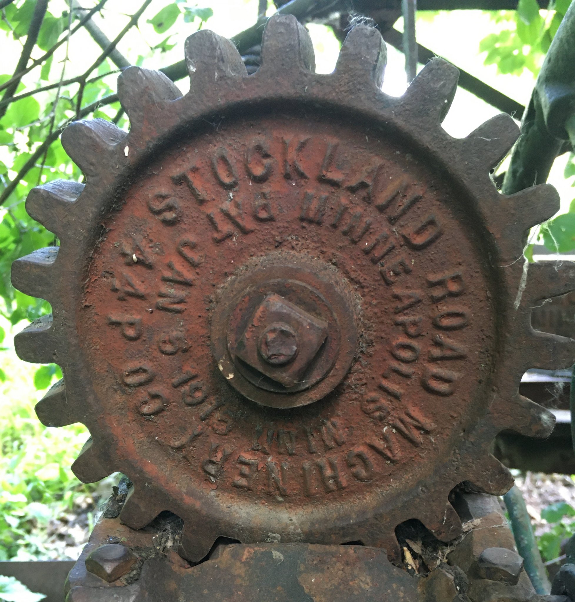

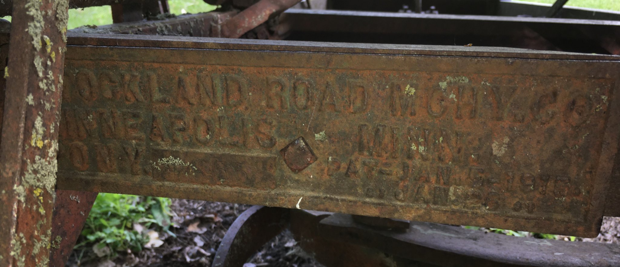

Your posts above got me curious again so I went and took some pics of the two spots that had some data cast in the framework. It's manufacturer was: Stockland Road Machinery Co., Minneapolis, Mn. (at least I had remembered the Minn. connection correctly). The Patent Date reads Jan. 5, 1915 so it's had a few road miles beneath it over the years.

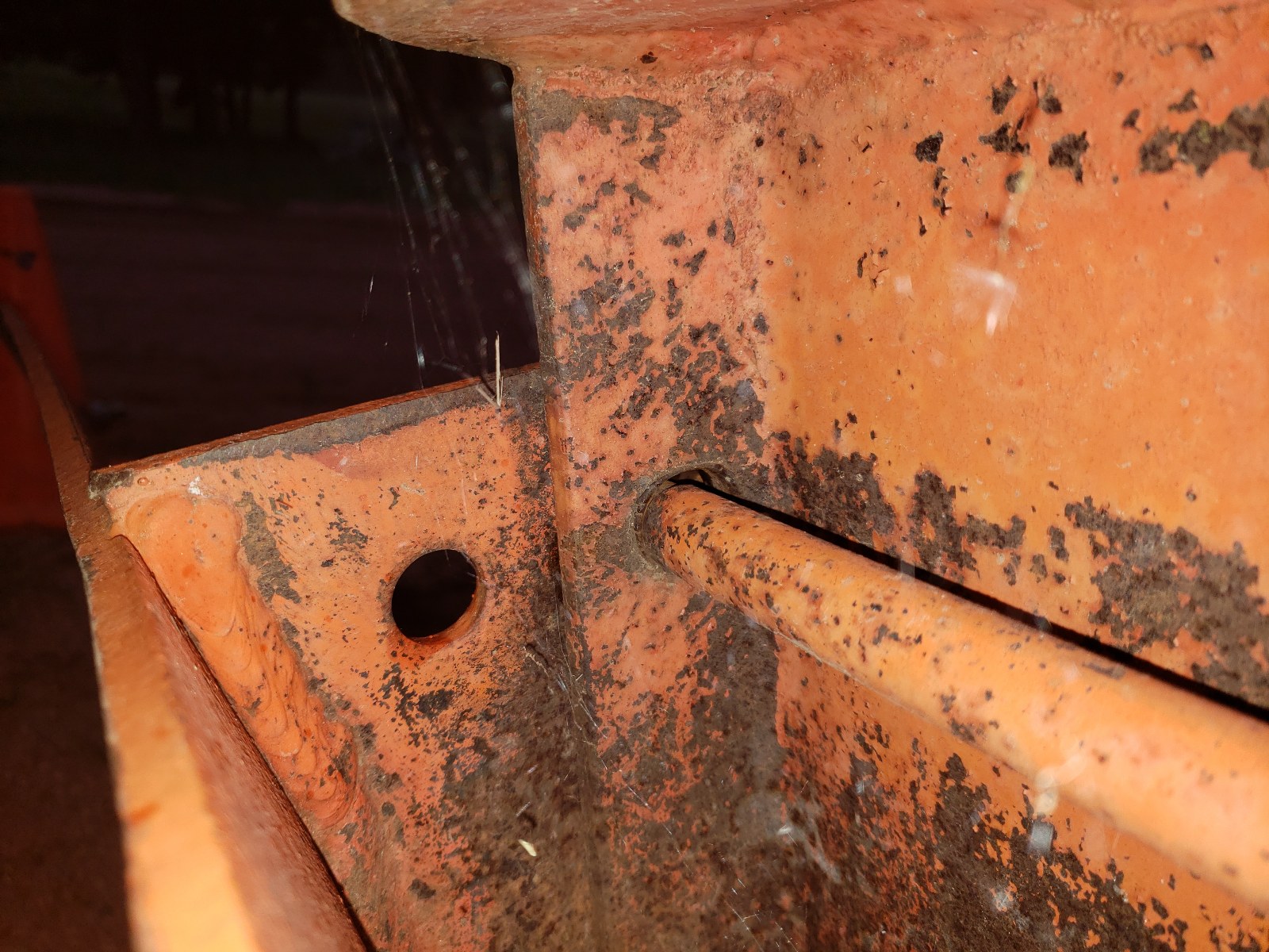

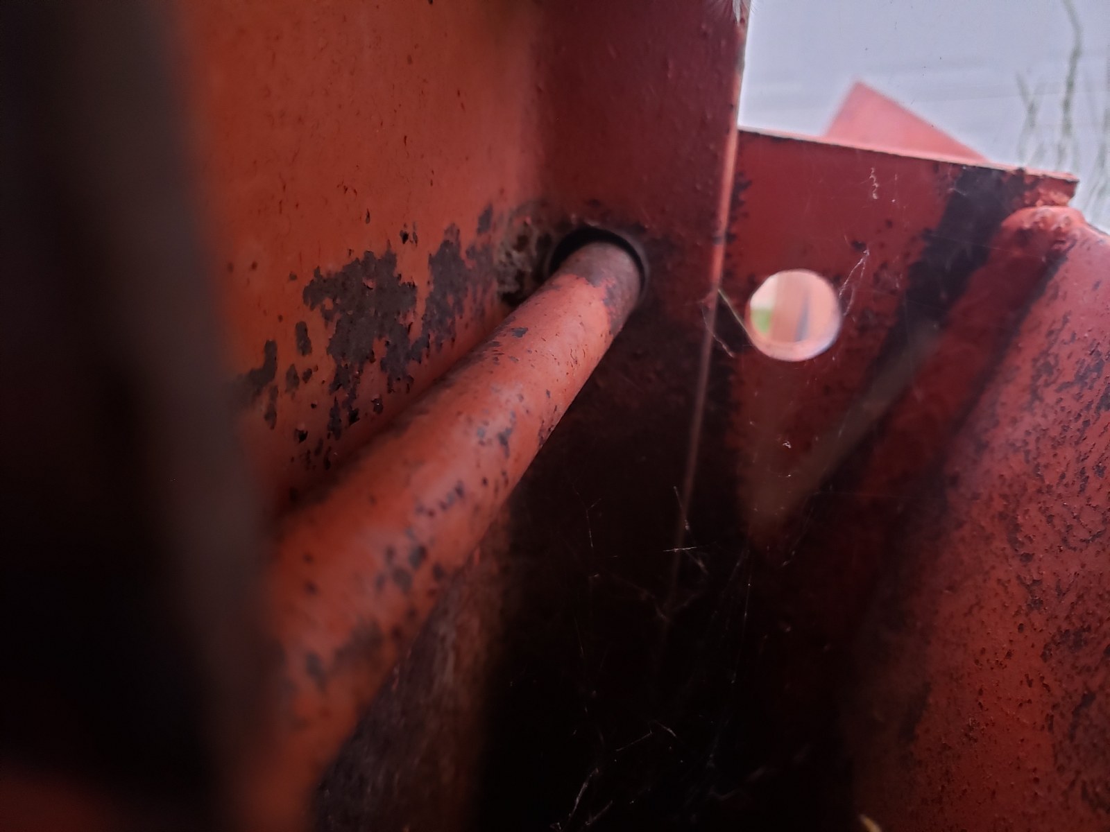

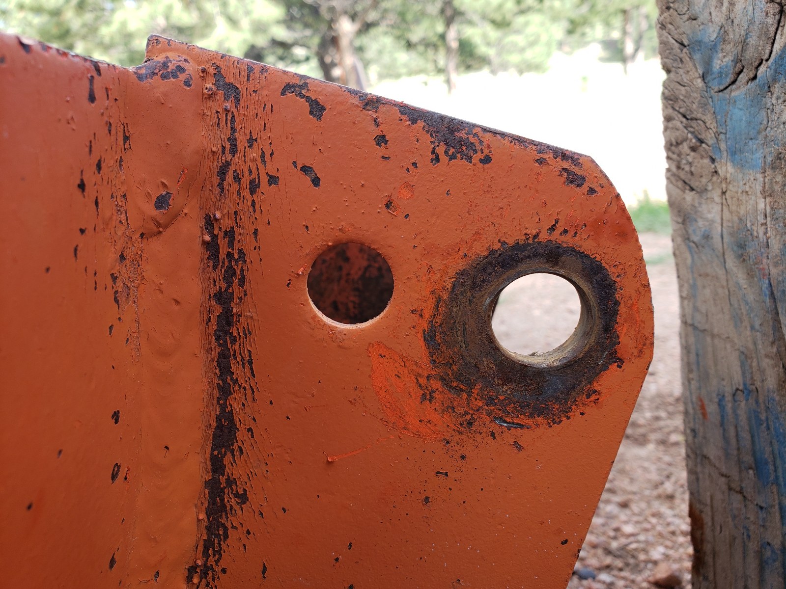

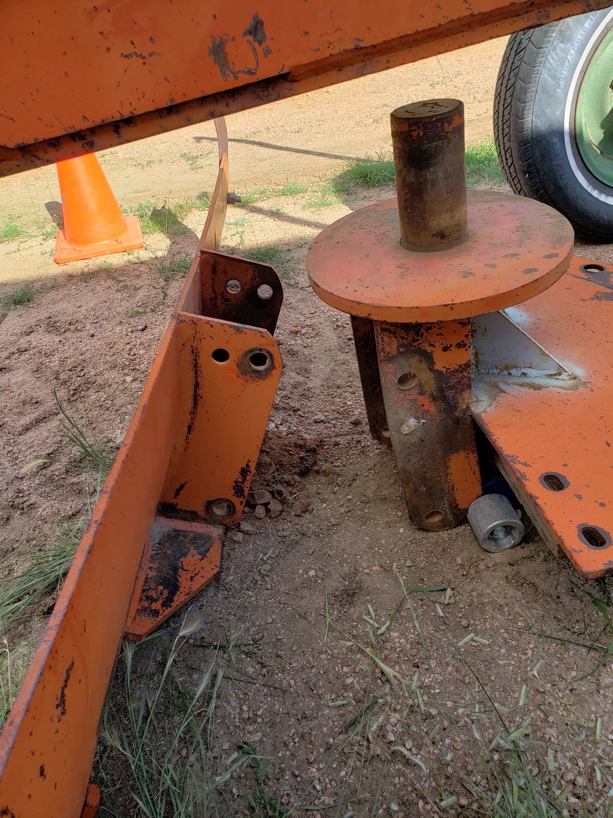

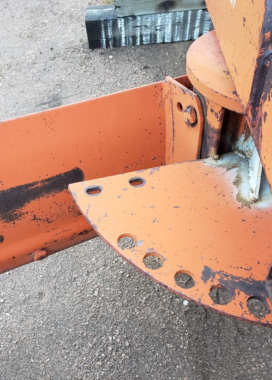

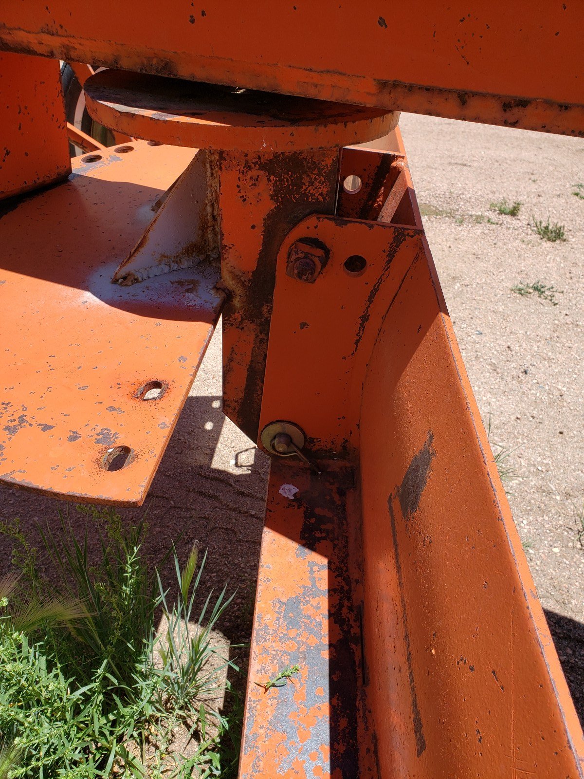

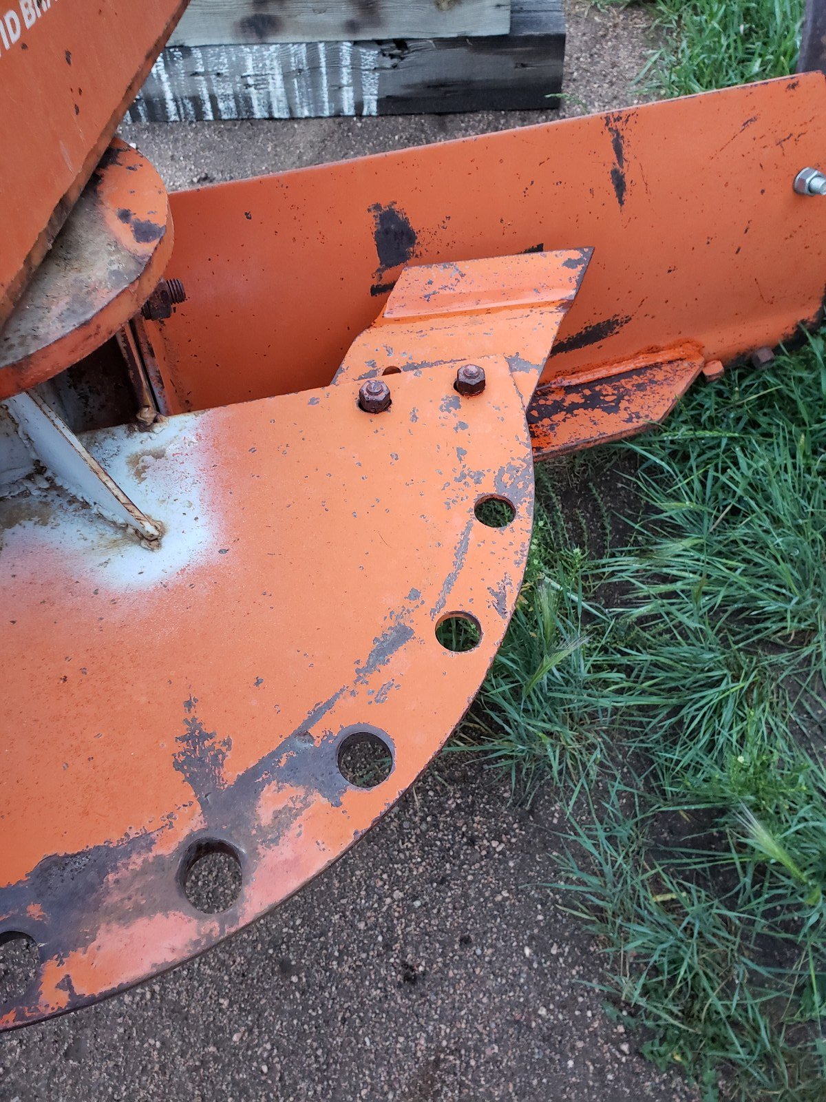

Poking around the grader today, I noticed what should be a pair of 'stops'
The left side is missing
Does anyone have any idea what these are for, they are mounted to the same
area that the blade is mounted to, and it is fixed, unlike snow plow blades?
There is definitely evidence of contact being made with the back of the blade
but not sure how with it being fixed?

I have seen blades flex when snagged on something, but it's hard to tell from your pics what that distance is and whether the blade could flex that far and still pop back to its original shape.
This pic makes it look like if the blade were tilted back using the other tilt hole, the distance might be pretty close? How much travel is in the slots on that stop?
There is an inch of adjustment, the left hole is at max, right is about centered.
I guess when using the back upper holes, and with flex, they may come in handy.
I'll make one for the left.

It's just my best guess. Anytime i own something 'old and cool' I tend to ask myself 'am i making this thing better or letting it get worse' and i try to at least break even, so i'd probably build that other one too even if i wasn't sure what it did! 😅 At least then i'm on the right side of that question.

I agree with Vigo's thoughts that those are to stop any excessive flexing of the top edge of the blade if you hook something unexpectedly, catch the top edge of a buried rock, etc.

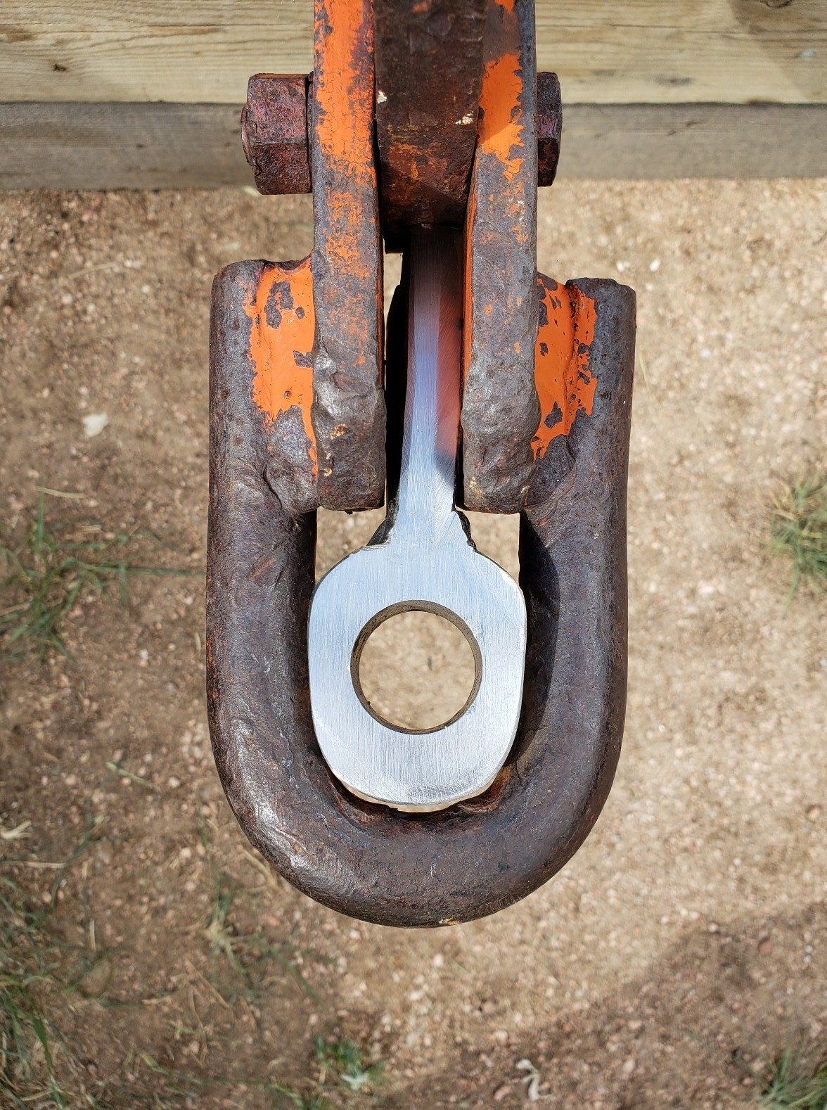

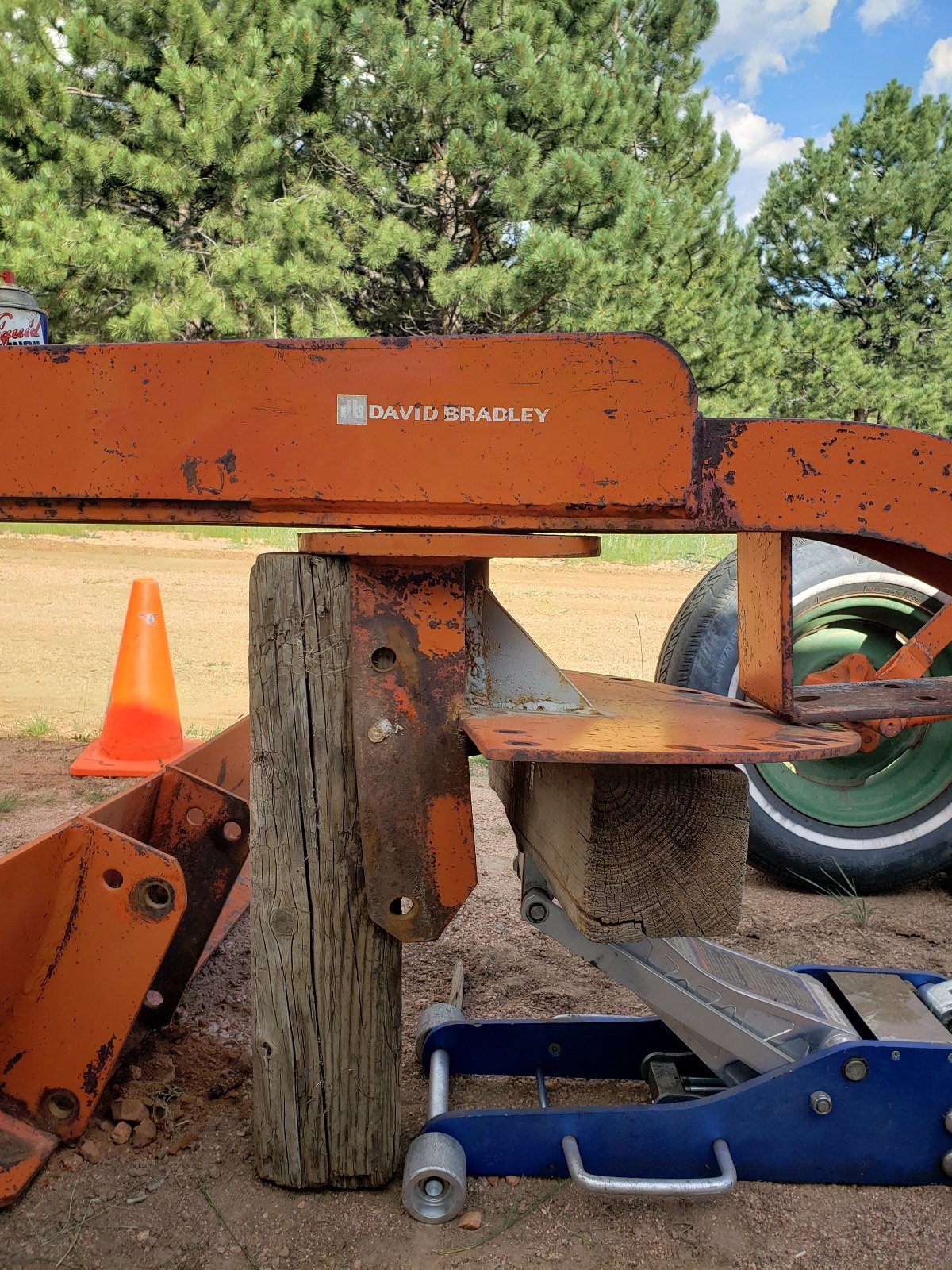

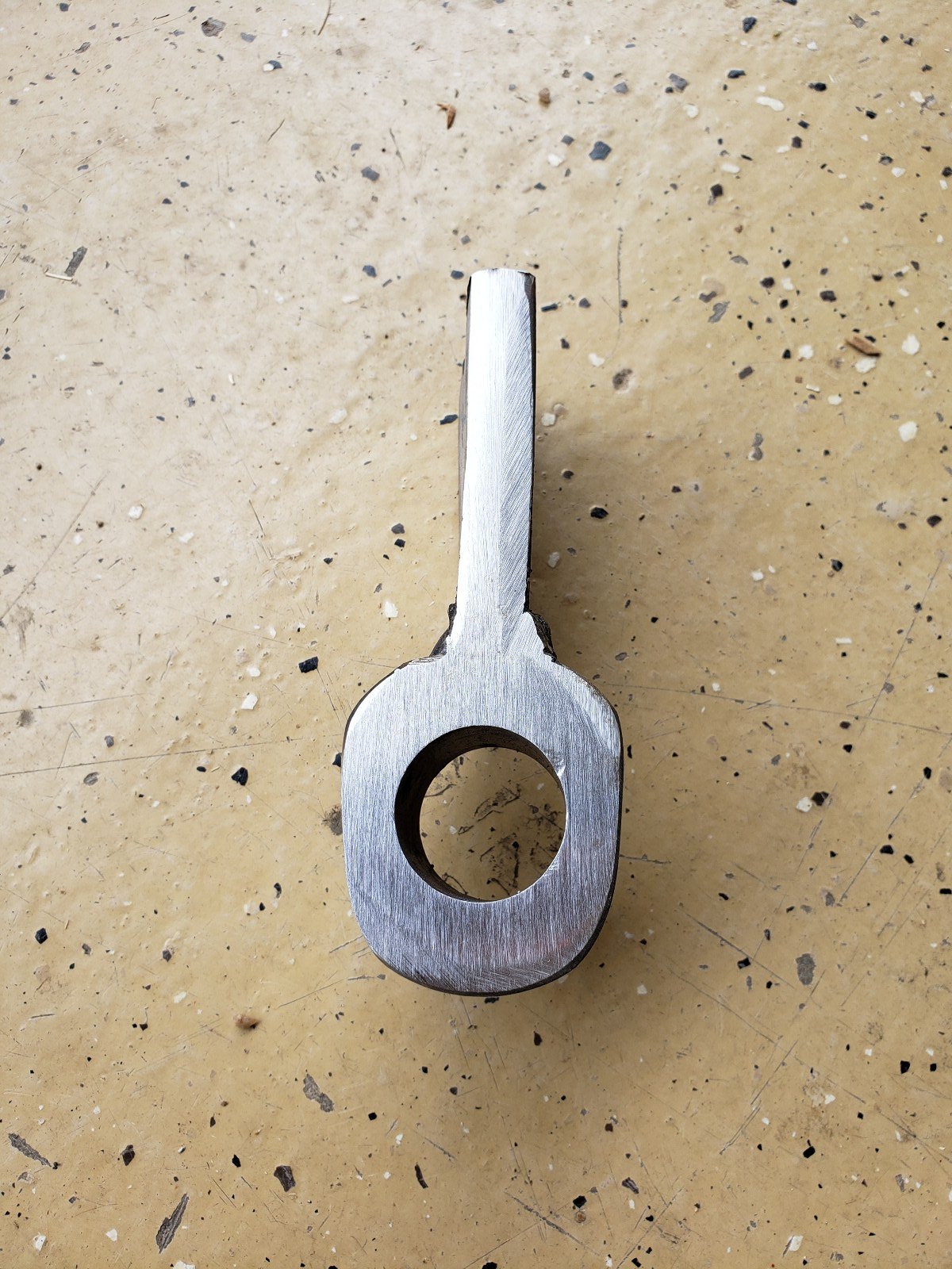

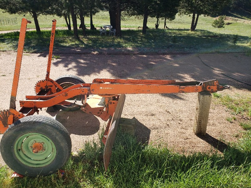

Started to work on the pintle to draw bar conversion tonight.
The existing pintle hook is not round, which will work to my advantage

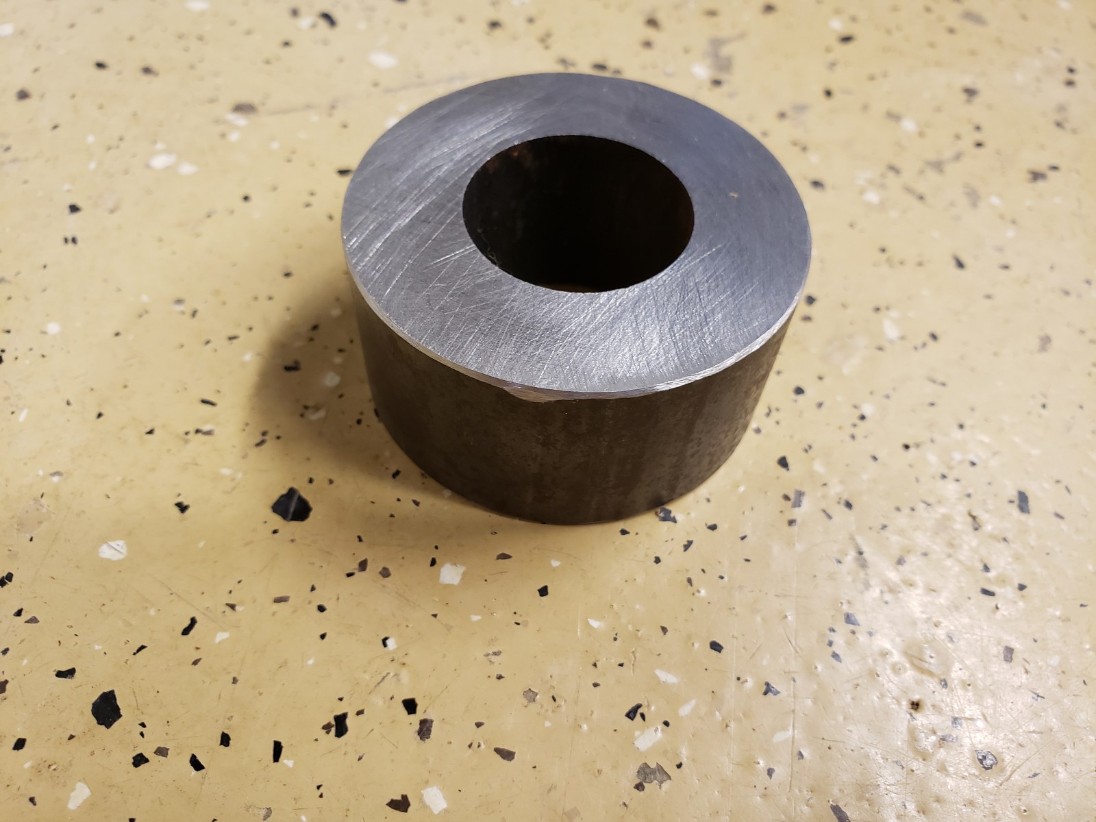

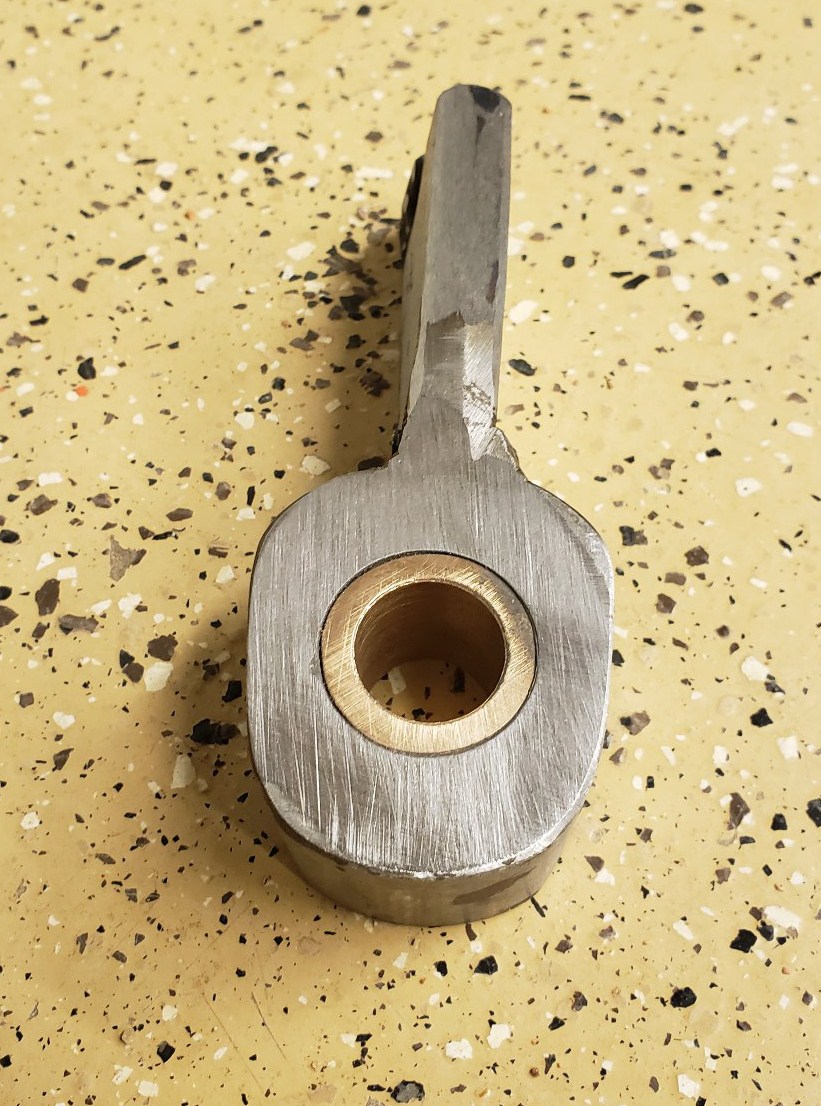

Made an insert, 2.25 x 1.00 with a 1.125 center hole,
that center hole will house a 1.125 x .75 bronze bushing

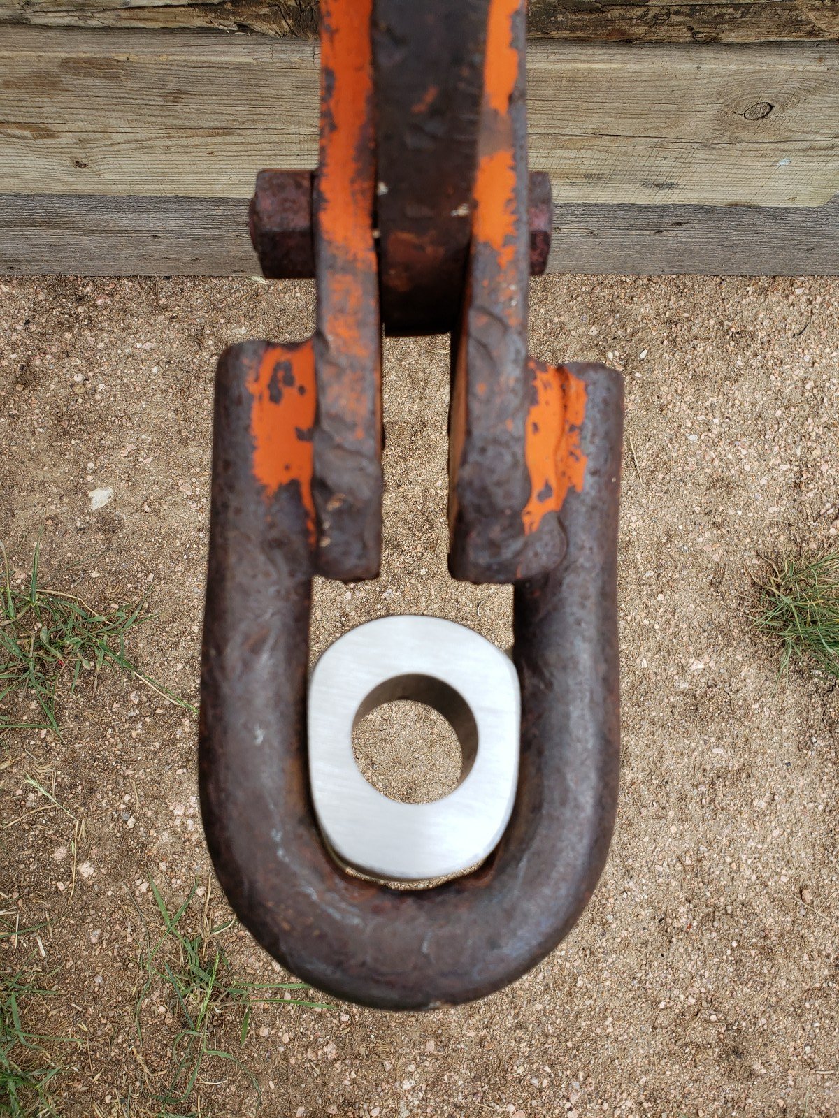

The outside will be taken down to be a tight fit in the 'not round' pintle hook
Drawbar and .75 grade 8 bolt will secure it all together
This will allow it to be used on the 3 point hitch as mentioned by
@BigG and @Vigo

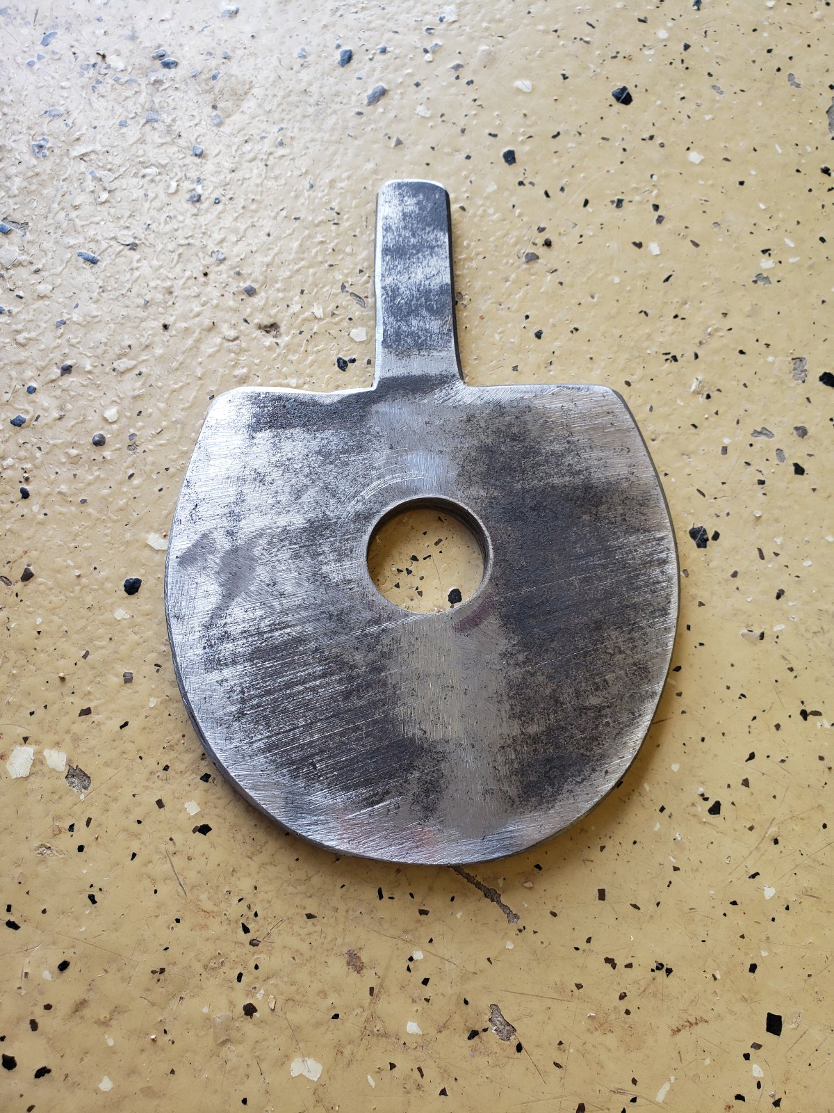

Did a little more work on the pintel to drawbar conversion
Took down the metal insert to fit in the pintel end
33 Steel insert sized to fit pintel end.jpg 34 Steel insert sized to fit pintel end.jpg
Added a backer bar to prevent rearward movement
35 Backer bar added to prevent rearward movement.jpg 36 Steel insert in pintel end.jpg
No bushing yet, but did a test fit, everything is nice and tight, should work well.
Bushing should arrive Monday.
Everything will be removable so going back to a straight pintel hitch will take minutes.

New bushing arrived and inserted in pintle insert

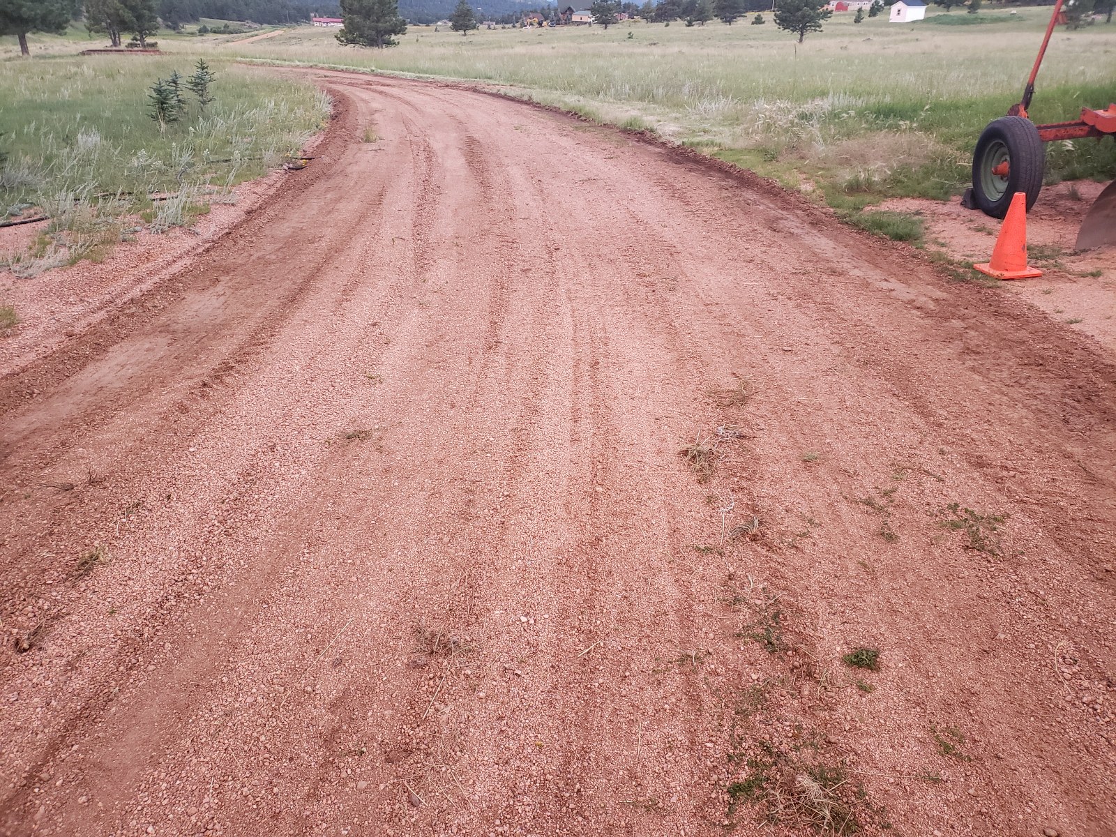

Made a couple of test passes today, works pretty good
Lots of slop in the main blade pivot point and blade mounting bolts
That will be next to fix, but useable now, happy with it!

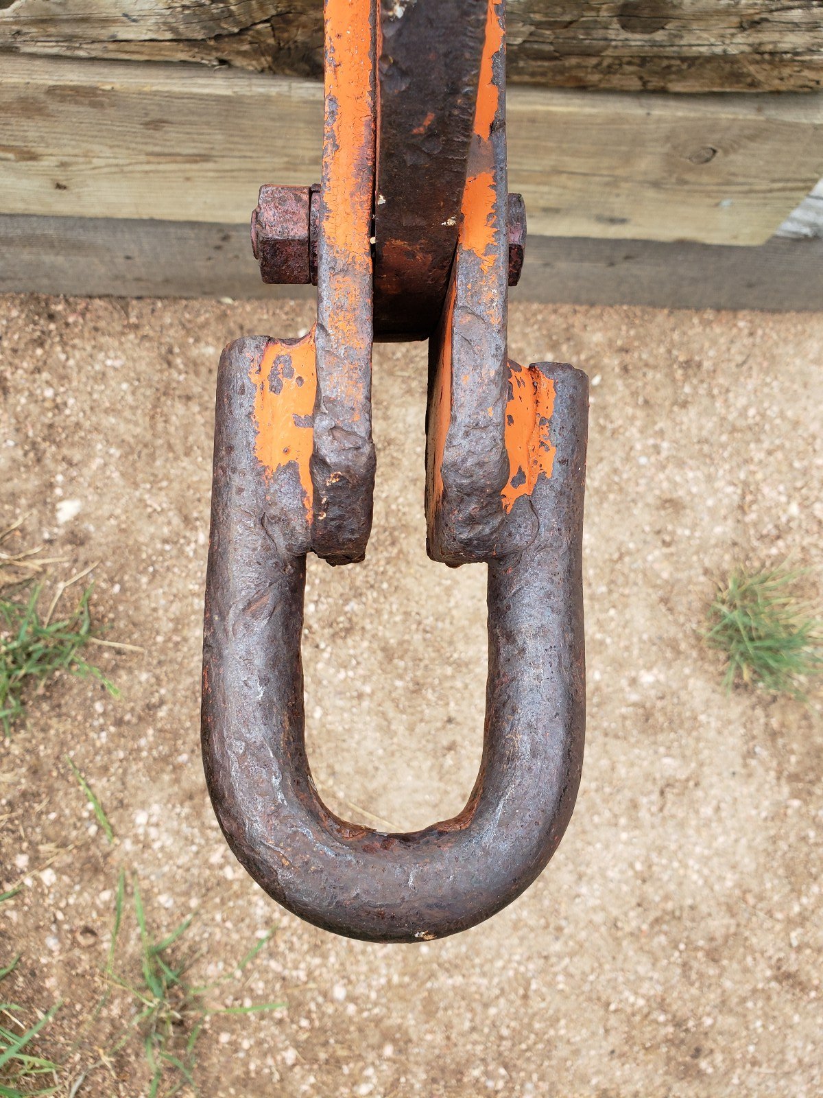

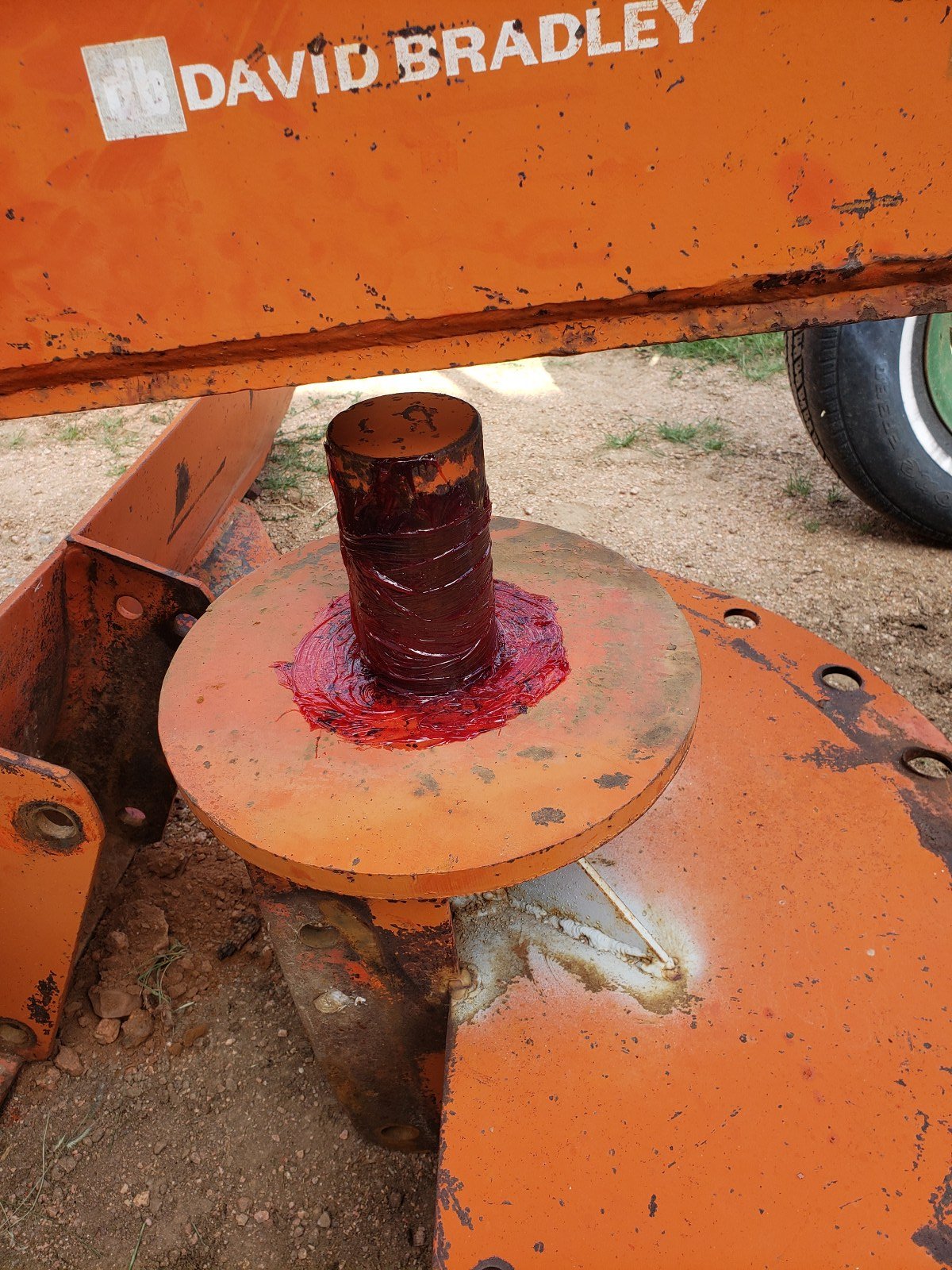

Broke everything down today, greased up the main pivot point and reassembled that 54 Plow-Pivot assembly broken down.jpg

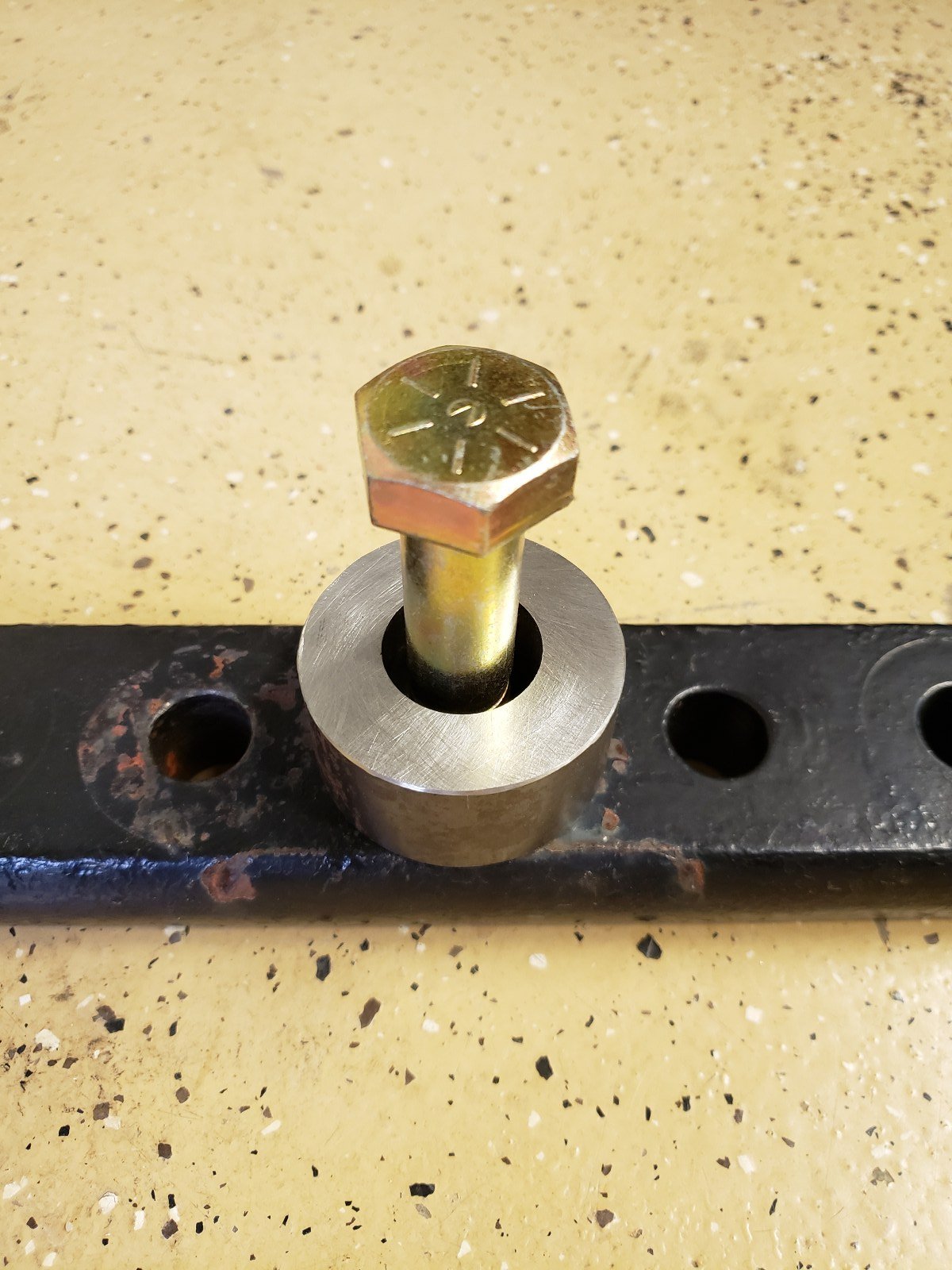

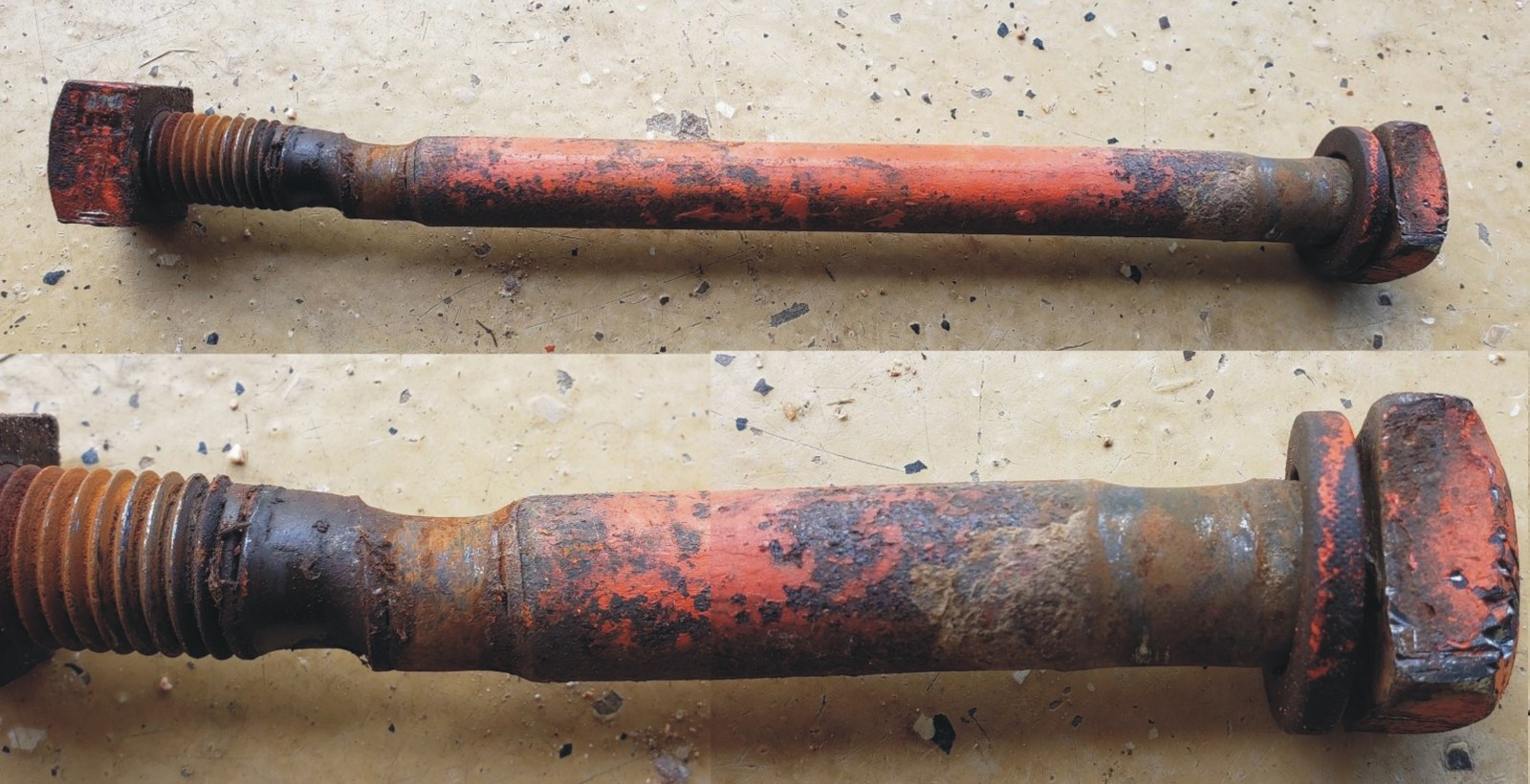

Ordered some 3" ID washers and 10" Grade 8 Bolts to finish it up
These holes are not quite 3/4" any more, I'll weld in some thick
washers to remedy that, the bolt did not help matters much

Broke everything down today, greased up the main pivot point and reassembled that View attachment 85055
Wow! Square-head offset bolts and square nuts. That's something you don't see every day.
