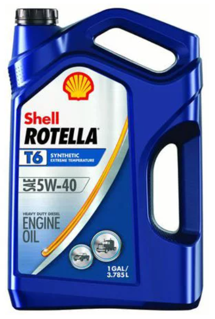

If the temps where you are get reaaaaaalllll cold - you may want to switch to 5w-40 - Rotella makes that in their T6 variety - sometimes it is harder to find than 15w-40

They do dip down, but usually not below the 20s-30s F for long (doubt Id be doing much with the tractor at that point lol).

Just a couple FYI’s…
I use the T6 85Hokie posted a picture of. I do use mine for snow blowing.
The 5w allows much easier starts than 15w. Used both. Just an FYI in case you notice hard cold starts. Otherwise, stick with the 15w-40.
The Mystic JT5 North Idaho Wolfman posted has been his favorite for a long time.
Great for your tractor. Usually in my local Tractor Supply store.
Since your tractor is a gear transmission it is not critical to use Kubota’s latest and greatest hydraulic fluid.
Your tractor is much more forgiving than one with a hydrostatic transmission (HST). Don’t let anyone convince you you need Kubota branded SUDT2 in your gear drive tractor.
SUDT2 won’t hurt it, but much more expensive than perfectly good alternatives.
