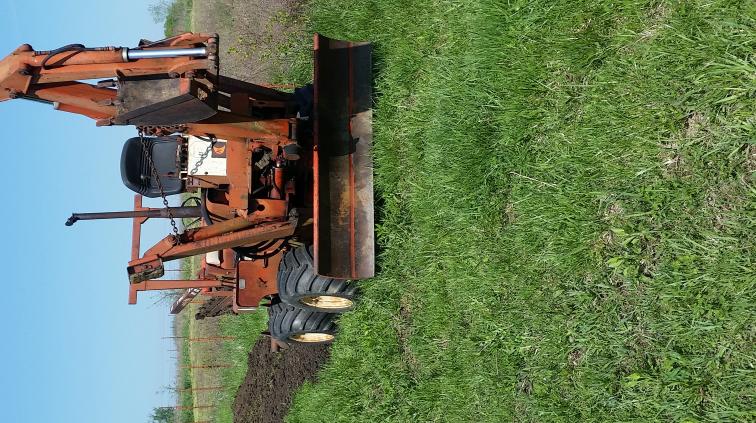

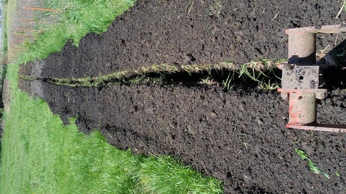

Flip, when you rent a machine why do you have to backfill with a shovel... "backfill is easy with a shovel"? If you're going to rent a piece of equipment to get something done, why just do half of the job?
Even my old machine will do that. Has a 6 way backfill blade!
