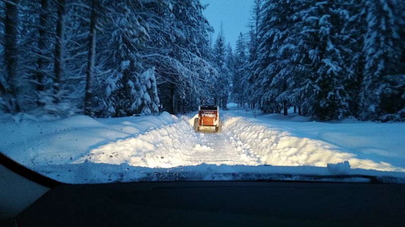

You get snow in Idaho? Thought Idaho was temperate?:D
This is a light snow morning.
We got 382" of snow that year, that's almost 32 feet of snow or 970 cm of snow.
A year before I moved here they got 26' in a 24 hour period, they had to use bulldozers to dig out.
Temperate my back side! :eek:
