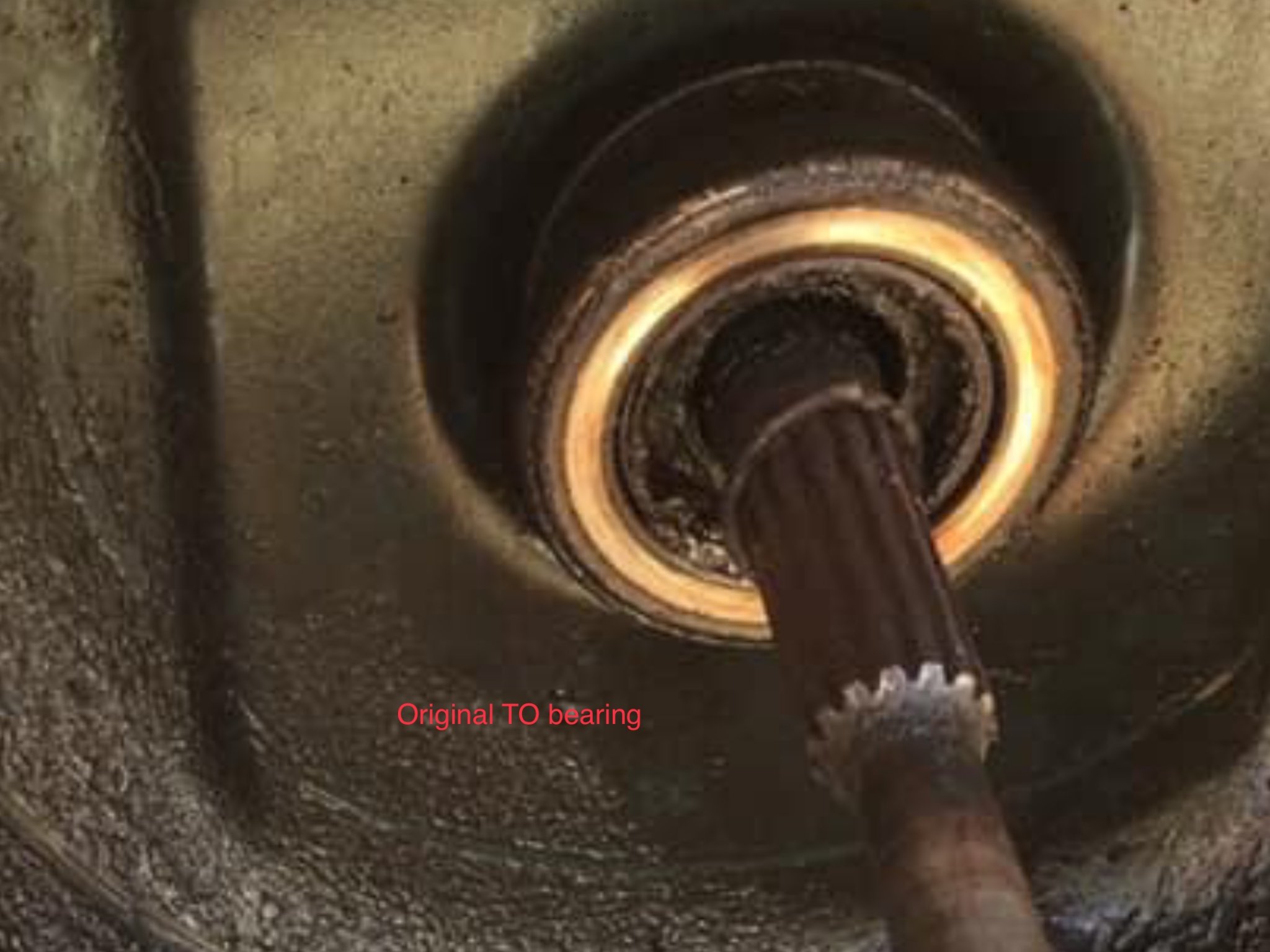

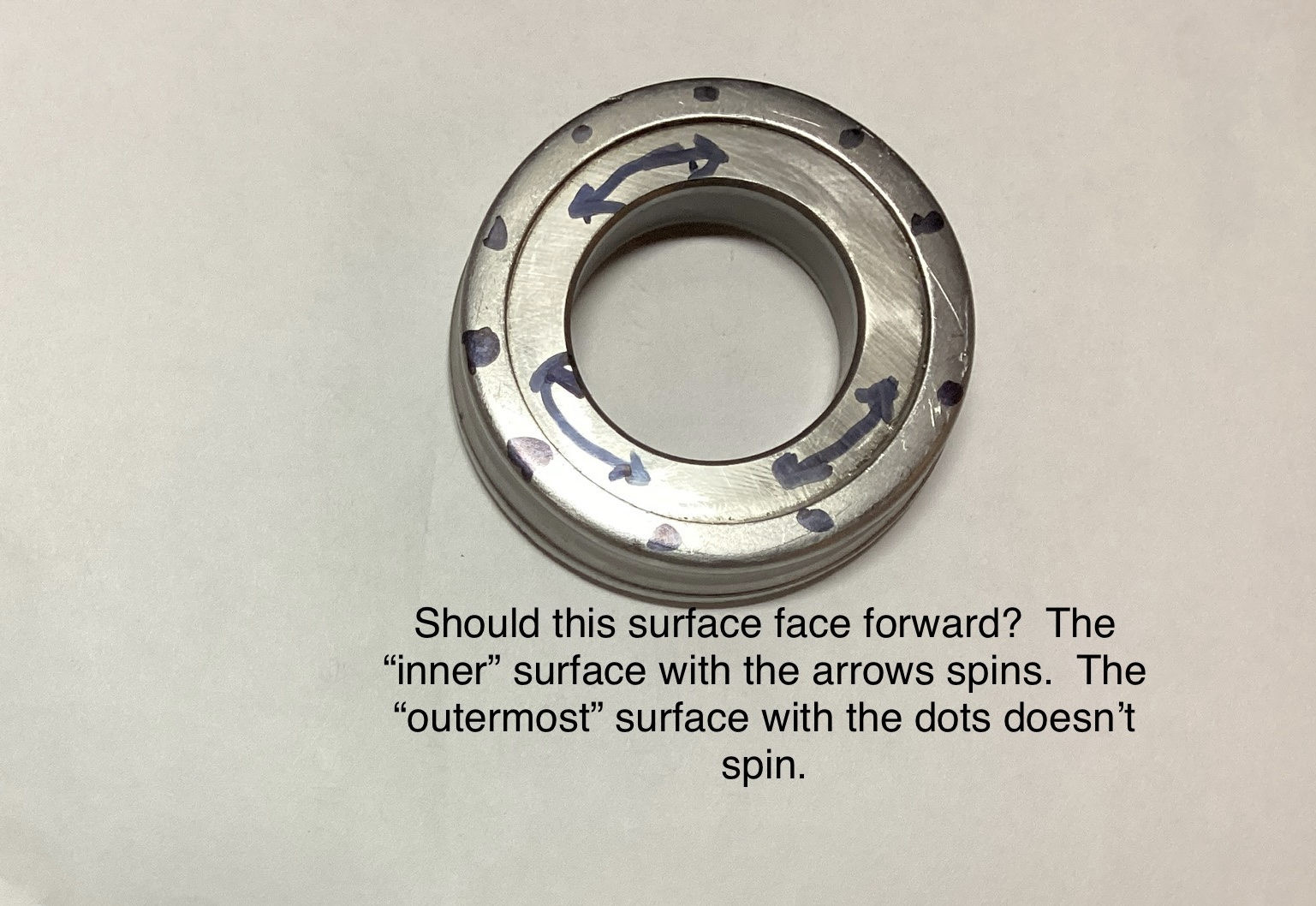

Wolfman,
Here’s the original TO and the way I first installed the new one. And a pic of perhaps the correct direction.

The spinning surface should be against the pressure plate fingers.
Thank you. I dug the old one out of my scrap pile…the new one is different. I now know why everyone here advises to buyOEM kubota parts. Lesson learned, after splitting the tractor 3x.
