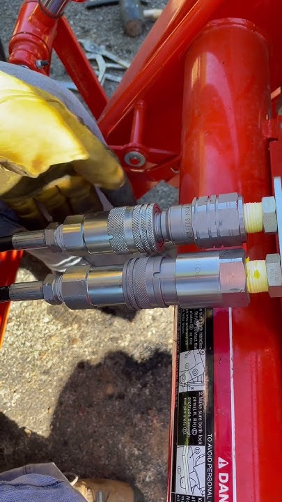

Hey guys, another newbie question. I can’t get the hydraulic coupling attached on my grapple. Here’s a video of what’s happening. I got the pressure bled off so it’s not a pressure issue. I don’t understand what I’m doing wrong. Any help appreciated.

For your issue, you'll need to pull the collar back on the female fitting at the same time as you push the two together.

I definitely get what you're saying, i've given it all i had, pulling back as i tried to connect it, it still doesn't seem to want to connect. I'll give it another try tomorrow, but do you have any other ideas?

True.........you have to have the tractor off so you're not fighting the pressure, but also, look at the knurled sleeve. There's a small notch in it. There's a small pin that this must rotate and line up to to allow it to travel back far enough. Looking at your video, you're not lined up. Let us know how things work out for ya !

There’s a little tit that goes into the u shaped notch - those must line up. Then once they line up, it’ll connect, then you turn it so it’ll stay connected

There is a notch in rear of the sliding locking collar that must align with a ball intent. This will allow the the collar to come back and connect.
This feature also locks the couplers together if they get accidentally bumped.
14,291
6,497
On the coupling you're trying to connect, right where your left hand gloved finger is you'll see knurled (ridge pattern) place to grip. Pull that sleeve part back a bit as you try to engage the rest of the fitting. It will engage and lock then.

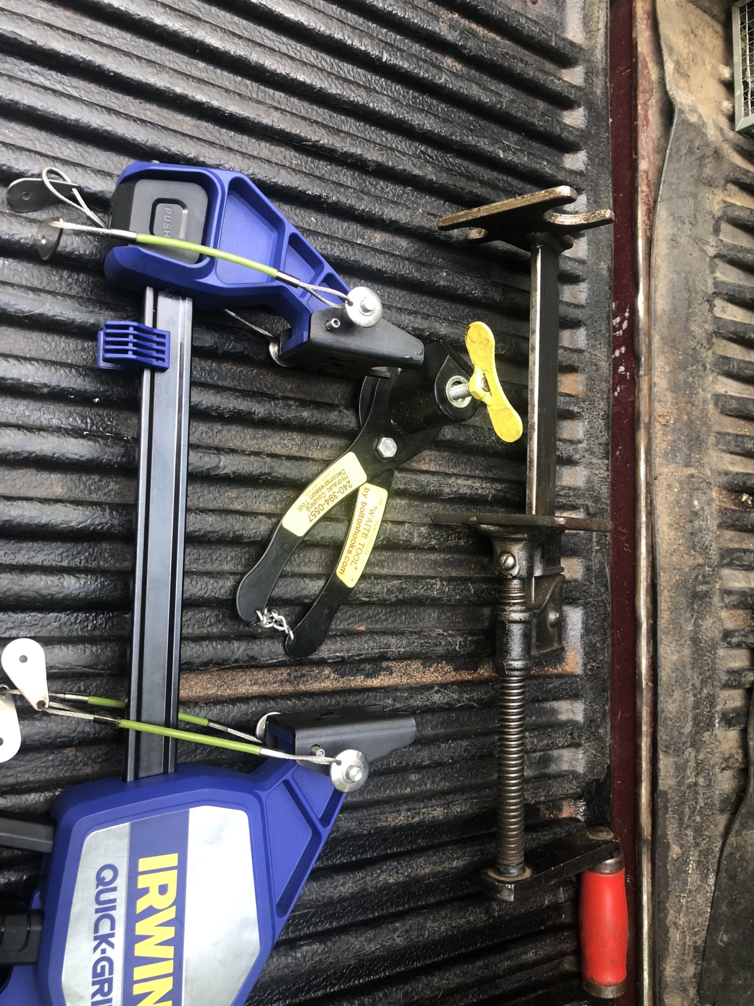

From a past post here on OTT I modified a pair of welders vise grips, to hold and clamp the female locking slide in the released/open position.
Works great for me, with weak arthritic old hands.
Can you post a pic of the grips you modified? I am thinking I would want to make something like that to make my life easier as well.
7,966
5,133
Wish I could help.
I am still in my stay warm in Winter mode, here in Florida.
Grips and tractors are in my barn in New England.
If you buy a pair of cheap welders pliers at HF, you may be able to figure it out for yourself.
All that is necessary is to slightly grind away a shallow half moon area on each side of the jaws, so they grab the coupler securely to hold it open, when you squeeze and hold (or lock) the pliers.
