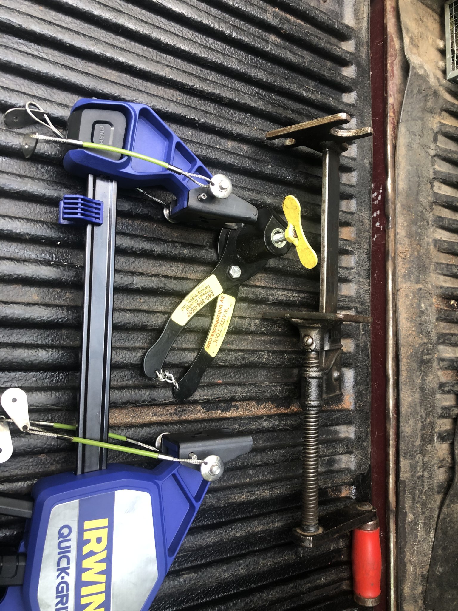

If you buy a pair of cheap welders pliers at HF, you may be able to figure it out for yourself.
All that is necessary is to slightly grind away a half moon area on each side of the jaws, so they grab the coupler securely to hold it open, when you squeeze and hold (or lock) the pliers.
Thank you for your reply. I will give it a whirl. Enjoy Florida.

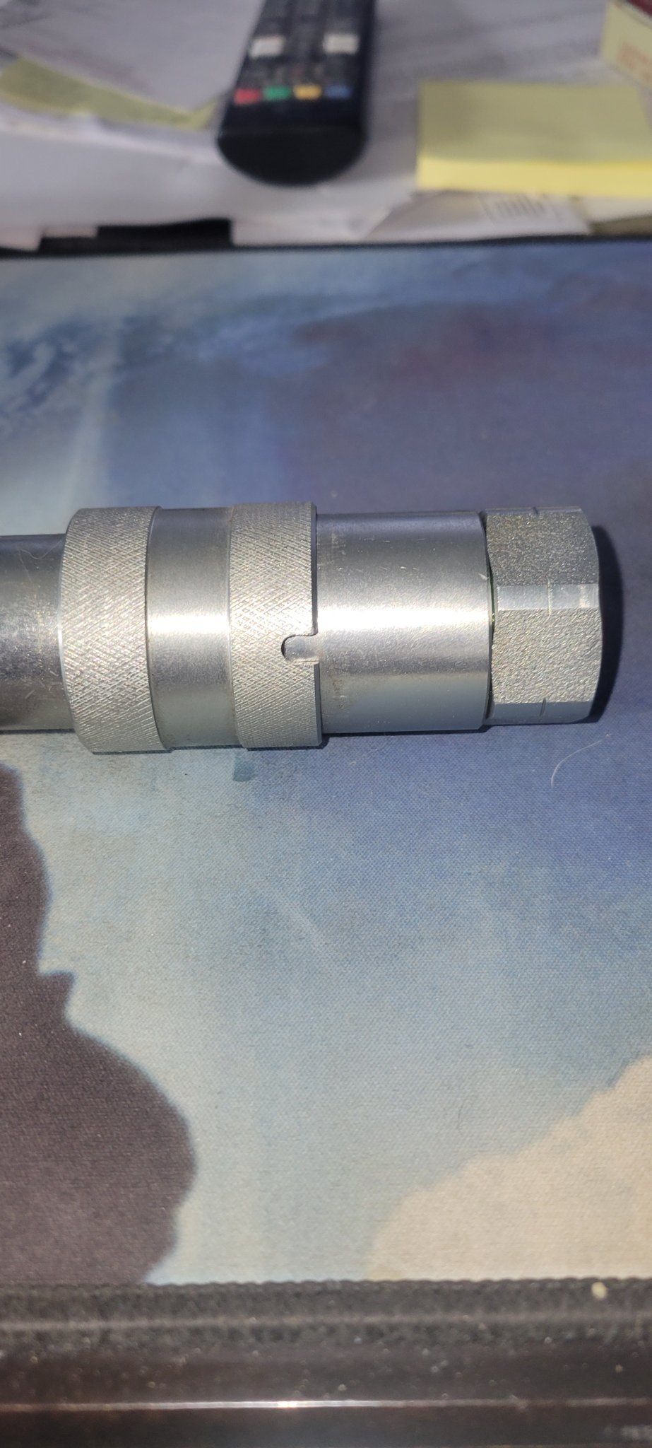

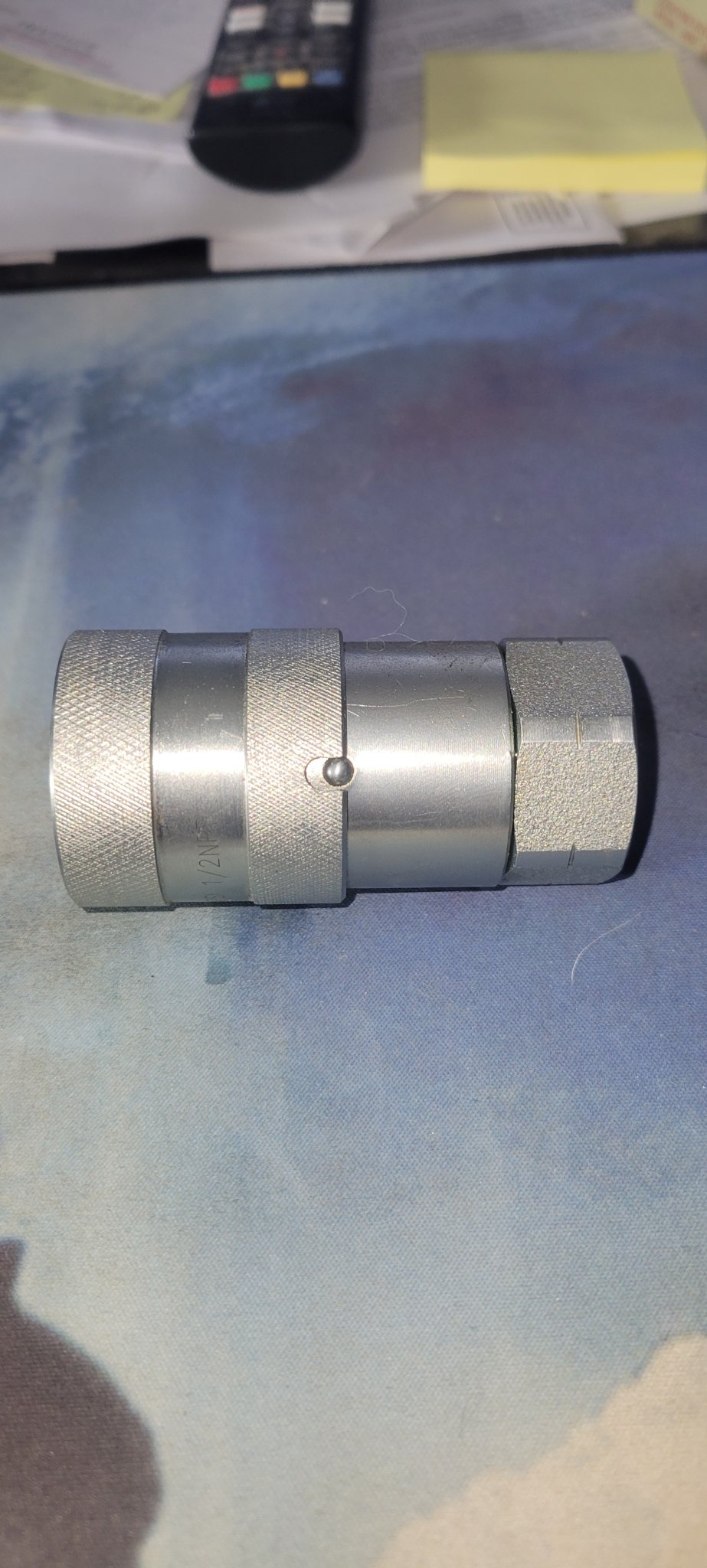

Several have said this, but a picture is worth a thousand words:
Lock detent:
If it's not lined up, spin the collar:
Other side will not have a lock detent:
This is with the connector disconnected:
