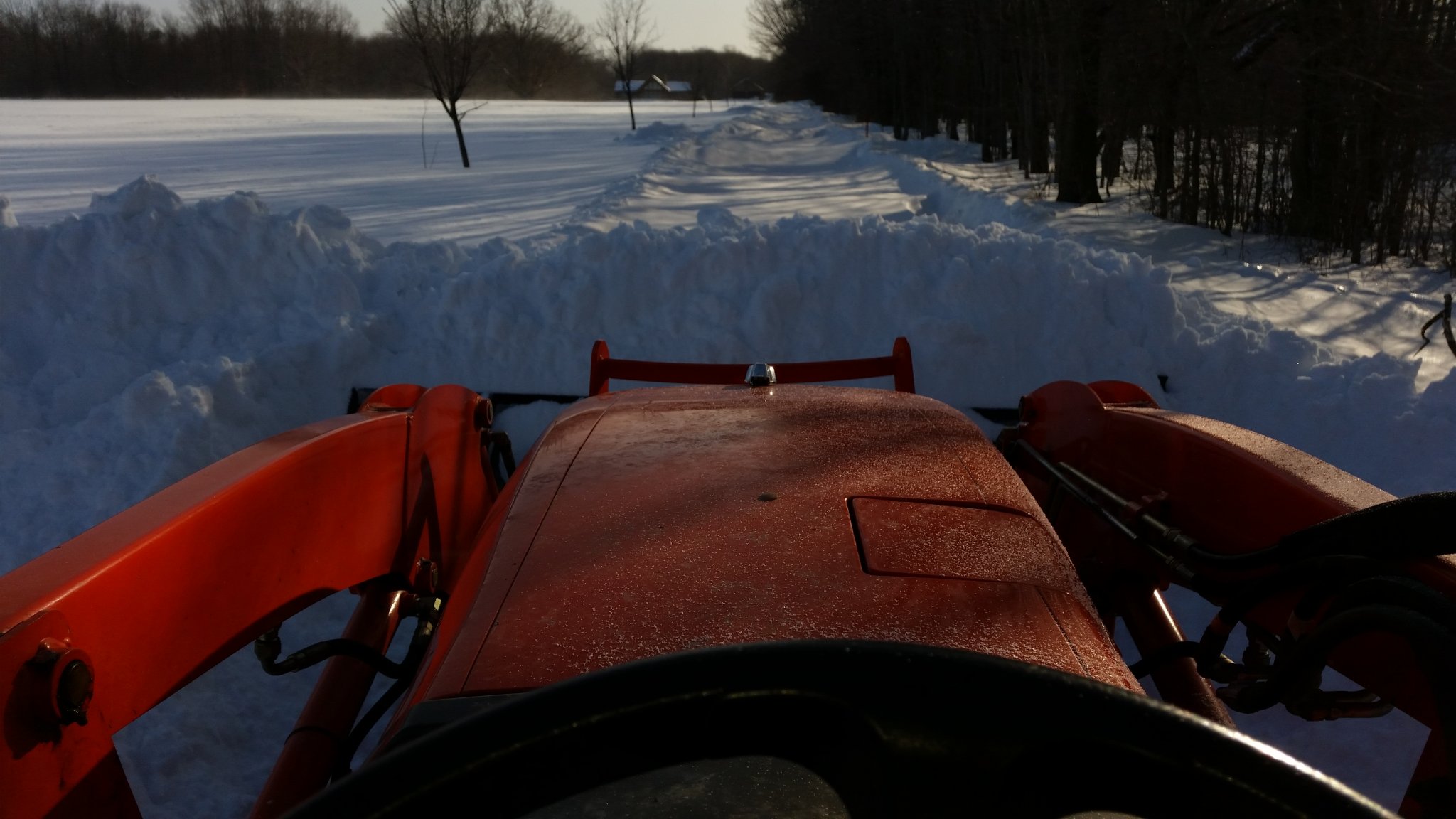

That is a L3540 with tire chains on al 4 wheels. A 8' plow that is 2' high. R4 tires. I does not do much without chains. With chains it pushes a lot of snow.
