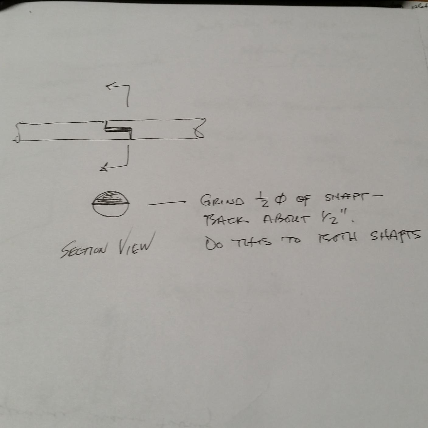

Here's a method to get good strength when welding round material. Grind each shaft back the desired distance (I like to go 3/8 to 1/2" if there is enough material/room) . Use a jig, like a piece of angle iron, to lay the two parts in being welded to keep them straight to each other. Chamfer the edges to get good penetration.
Great approach. Thank you for the drawing and idea!
