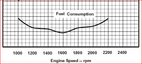

10,346
2,168
Your old mower was a gas engine - designed to cut the "best" at a rated RPM - thus that little notch the throttle fell in was the perfect spot.......
A diesel is a different animal - it typically makes more low end torque than any gasser can and can run longer on the same amount of fuel.
With that being said - running a diesel at a "low" RPM for fuel saving is a myth - most diesels have a sweet spot - that is typically 50% up the rpm range, running lower can burn more fuel and running WOT will burn more fuel - chart below is not your engine, but rather a typical diesel tractor engine.
Now with the tier IV engines - running a low RPM is rather stupid - allowing the tractor to idle for a long time will actually create problems!!! Not to say you have to run it balls-to-the-walls all the time, but these new tier IV's need to run hotter so you do not have to regen when you least expect it.
As for ranges ........... as Dan mentioned - High is typically used on flat ground, simply to get from point A to point B as quick as possible, real work will not be done - especially with that 800+ monkey on your back (HOE)
My BX has two ranges - and in H range, forget going up any incline, my machine cannot go up any incline more than about 10 degrees - and that is whining it's ass off!!!
Never trust you fuel gauge - that is about as accurate as trusting a politician's verbiage!
AS for going beyond the 540 RPM's specs - not a lot is gained by making the PTO spin a little bit faster, remember, those devices where DESIGNED to work at the 540 RPM - anything faster is NOT better, rather it can be detrimental if something goes south! They place those number on the gauge for a reason - those engineers do know some thing WE do not.........
As for the whine - once you change your HST oil..... it will be better, using lower gearing will make it better too.
as for you last statement:
"At this point I'm convinced I should just always run it at 75-100% throttle and trying to see if I'm missing something."
spot on!!!!
the only exception MAY be when using the HOE...... sometimes 50% throttle is helpful, but once you get good at using the hoe, you will find that you want to move quicker thus the RPMS need to get up there near WOT.
