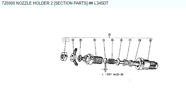

A quick search shows they are "pencil" type injectors.
Where are you doing your searches? :confused::confused::confused:
You might wanna start doing your searches on Kubota.com
The L345DT takes standard injectors, and yes they are one use soft washers.

I just Googled L345 & was surprised as u were.. I would have thought that they would be the screw in type like in your diagram. I don't ever remember seeing pencil injectors in a Kubota..
I guess the poster will have to verify.??
34,347
9,582
My L3450 has Pencil injectors, Kubota did use them. ;)

Anything that is Direct Injection uses pencil injectors, Anything that is IDI uses standard Kubota injectors.

This is specific to Kubota's. All IDI Kubota's have screw in injectors and a short glow plug that meets in a pre combustion chamber. Direct Injection Kubota use a long pencil style injector that is bolted down with a bracket, and have a long glow plug as they both meet in the combustion chamber.
And then there is new style Direct Injection Common rail which use a larger injector and have a solenoid attached to it. They are bolt in as well.
34,347
9,582
This is simply not true, they used standard injectors for DI engine too, I own one..
They only used pencial injectors for a short time period then that went back to standard injectors, I don't know why.
Uhm.. That is not possible. What engine do you own that uses standard injectors on a direct injected engine?
Even Tier 2+ V2203 use a pencil style injector (a bit fatter pencil), and that is clamp down, not screw in. They require the length as a DI engine injector injects in the middle of the cylinder..
34,347
9,582
Well it looks like I have egg in my face, not the first and not the last. :p
Kubota lists some of their E-TVCS engines as being DI engines, and parts lookups do the same thing.
I have always wondered why they (now knowing mistakenly) called them DI engines, when they were prechambered?
So back to the drawing board on what I think I know.
Also went out and looked at my V2203 DI thats in my bobcat, I was in such a rush to get it back up and running when it blew up the V1702 IDI that I didn't spend much time with it, and yes it too does have pencil injectors.
Thanks for correcting me. ;)
