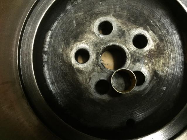

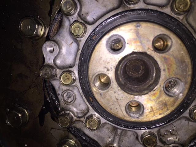

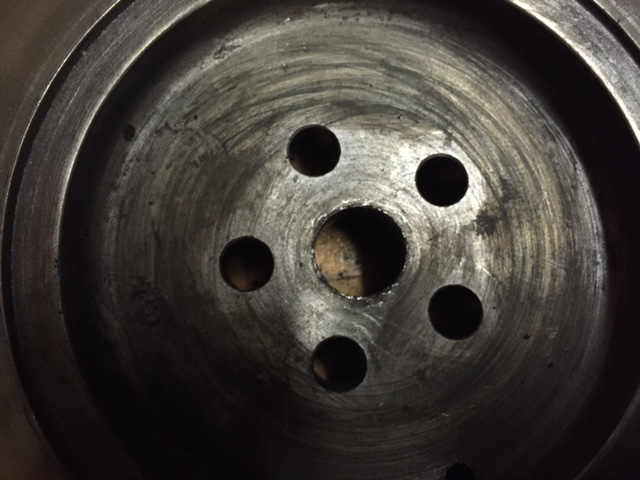

Ok. I ordered the pilot bearing and it came in. I was going to size it up with the hole where it goes and it fell in. The pilot bearing is about 2 mm too small than the fly wheel. and smaller than the bearing seal. I checked the pilot bearing to see if it goes over the clutch rod/propeller shaft and it fits perfectly. So it looks like the shaft wore down to nothing and then it bore the hole in the fly wheel and bearing seal to be larger.
Here is a picture of the fly wheel with the pilot next to it to see the difference in size.
Here is the picture of the flywheel without the pilot next to it.
Here is a picture of the bearing seal in the crankshaft.
My questions are these:
1. Is that normal for the fly wheel to be much larger than the pilot bearing? If so, do I need to purchase a new fly wheel?
2. Do I need to purchase a new bearing seal (the one in the crankshaft)?

The bearing doesn't fit in the flywheel, it fits in the end of the crank, behind the dust seal.

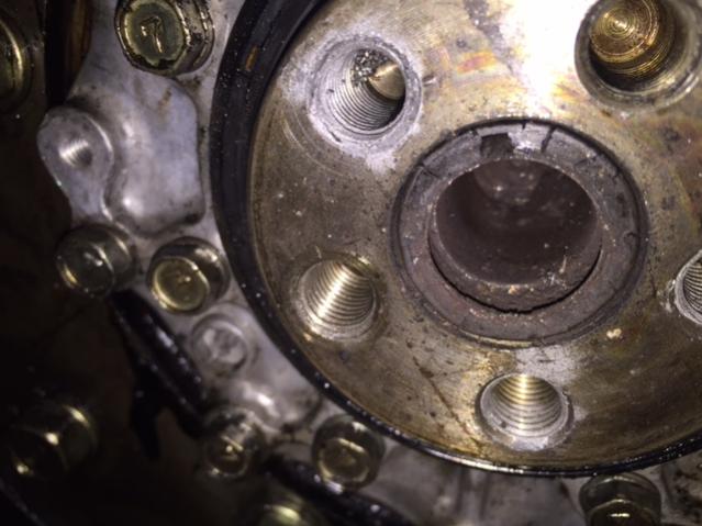

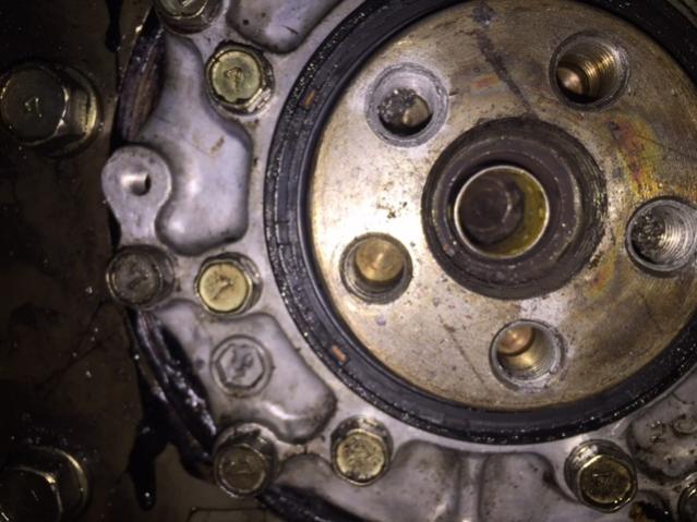

I removed the seal from the crank. I looked at the rest and it seemed that there is no pilot bushing in the crank. Is it possible it wore out? I dropped the new pilot bushing in there and it is smaller than the hole.

Uggg not good, yes it sounds like it was out long enough to have worn the crank hole out.

Ok now for the really bad news, there is only one way to fix it right, you would have to completely disassemble the motor and take the crank to a machine shop to have that bearing surface milled and sleeved to fit the bearing.
Now for the shade tree repair version, get epoxy putty, you need to have the transmission ready to install very quickly.
Leave the flywheel and clutch and shaft seal off, clean hole in end of crank with some emery cloth and brake parts cleaner (very clean), have transmission in line to assemble fast, coat end of transmission shaft with a light layer of grease, , kneed putty till mixed completely, wrap putty around bearing, install bearing in hole, filling in the space around bearing with putty, quickly clean out any excess from inside hole, mate transmission up to motor (this will help align bearing), will only need to install a couple bolts to hold it in place, let sit for 24hours, remove transmission install all components like flywheel (carful installing it, if you didn't mark it's orientation to the crank) , it does actually only line up one way, all others will have bolt holes slightly off, it's hard to tell, but if you cant hand start and turn every bolt it's probably not lined up.
