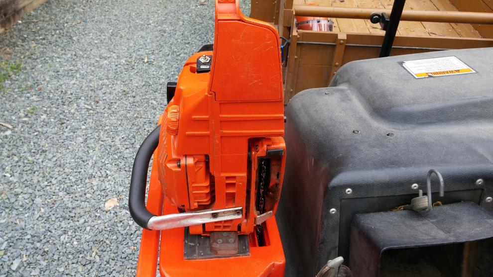

I bought one of those thinking I was going to mount it on the backside of the ROPS, but that didn't work out. I wound up cutting the mount off, welding a piece of square tubing on the backside, and bolting that tubing to a couple of existing holes on the fender. The chainsaw bar sits inside of the fender and the motor sits on top of the fender. Might not work too good on a BX though.
