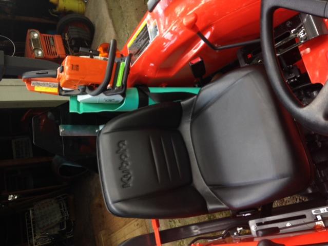

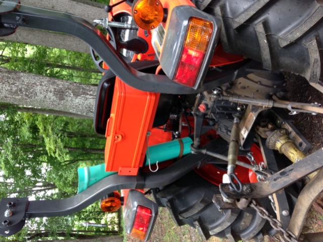

Here is mine. Held in place by straps, no fasteners.
Found a piece of scrap PVC (perfect green!) from sewer-line work being done in my neighborhood. Cut out a 4 inch chunk and warmed that baby over a charcoal fire. Flattened it out and put the saw in it while hot. Formed a little -Works great.
Sorry for the side-ways photos, I don't know how to rotate them.
RWR
