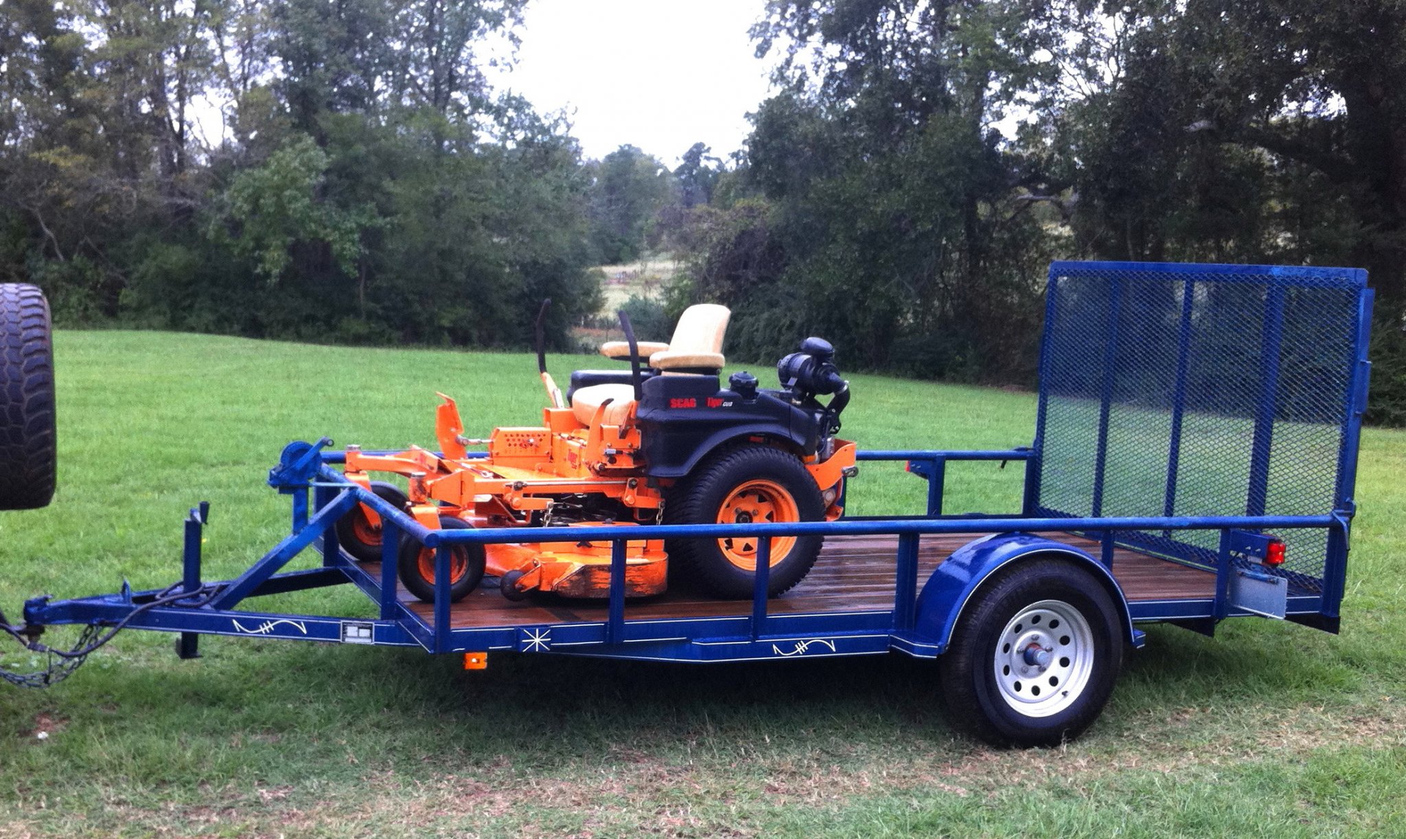

Was walking my dogs one evening and came around the corner down near my tool shed....to see my Scag Zero Turn mower completely engulfed in fire! Had already gotten to the fuel tanks (with 10 gallons of gas), no way to put it out.
It is thought that mice chewed a wire and caused a dead short.
Before:
After:
Homeowners insurance personal property "replacement value coverage"......I hope?

Yes, covered under unscheduled personal property.
And they were actually fair about it.
That is nice to hear!
I had a similar very fair result (with USAA) many years ago, on a much larger loss.
