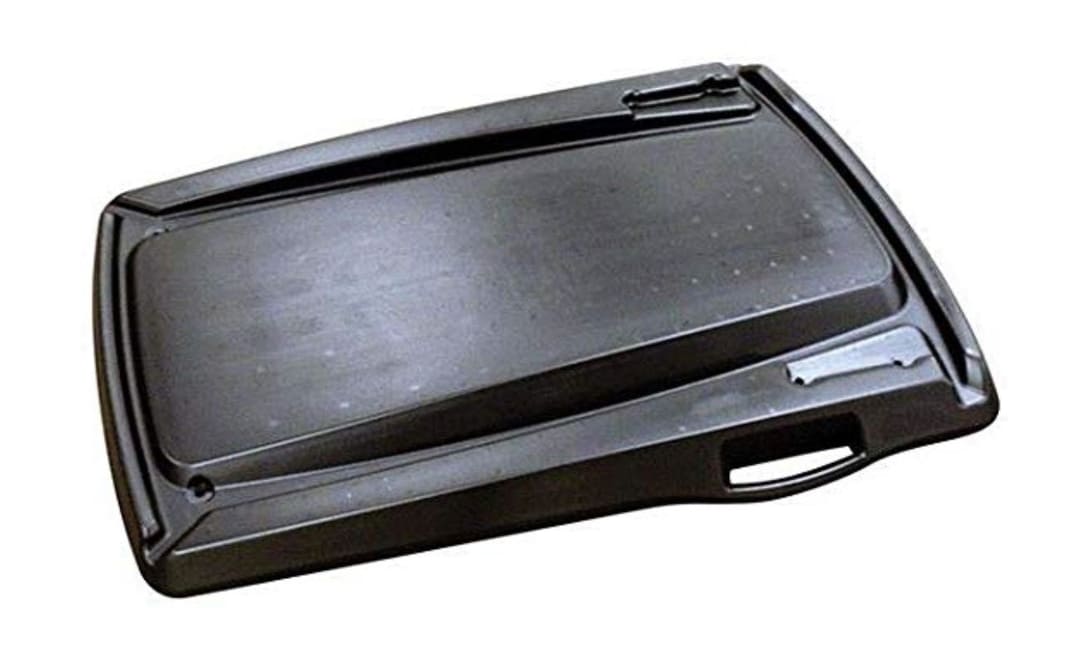

The cart roof I went with is for a EZGO.
I got it from a local golf cart guy.
I mounted it handles forward.
The install was a design/build. There is a channel that runs right across the back that I set on the ROPS and then propped up the front with a 2x4 down to the hood to get the height/angle right. From there I measured/made the frame for it to bolt to. It handles highway speeds without issue.

Mikester, the golf cart canopy that is from E-Z-Go are far from flimsy. I'd venture to say they are much more durable then any product sold as a tractor canopy. I have 4 other canopys and one from E-Z-Go. The E-Z-Go is a good size, strong, easy to mount and inexpensive. I paid $25 for the one I got and the man had a dumpster full of them. Said take any you want, and even gave me a couple tire gauges with the company name on them!

I can assure you they are not flimsy and will add that I'm very happy with how branches now glide over the top without any help - where I used to have to hand guide them over the ROPS... YMMV.
If by chance it does break... what, I'll have to spend another $20.

I had the beautiful OEM fiberglass canopy on my last tractor. It was cracked in a dozen places.
So far the plastic EZGO golf cart canopy just bounces back.
So in my experience the plastic one with a little give is much better if you will be dealing with trees and such. And it doesn't cost 900.00
I also have lights and a mirror mounted.
