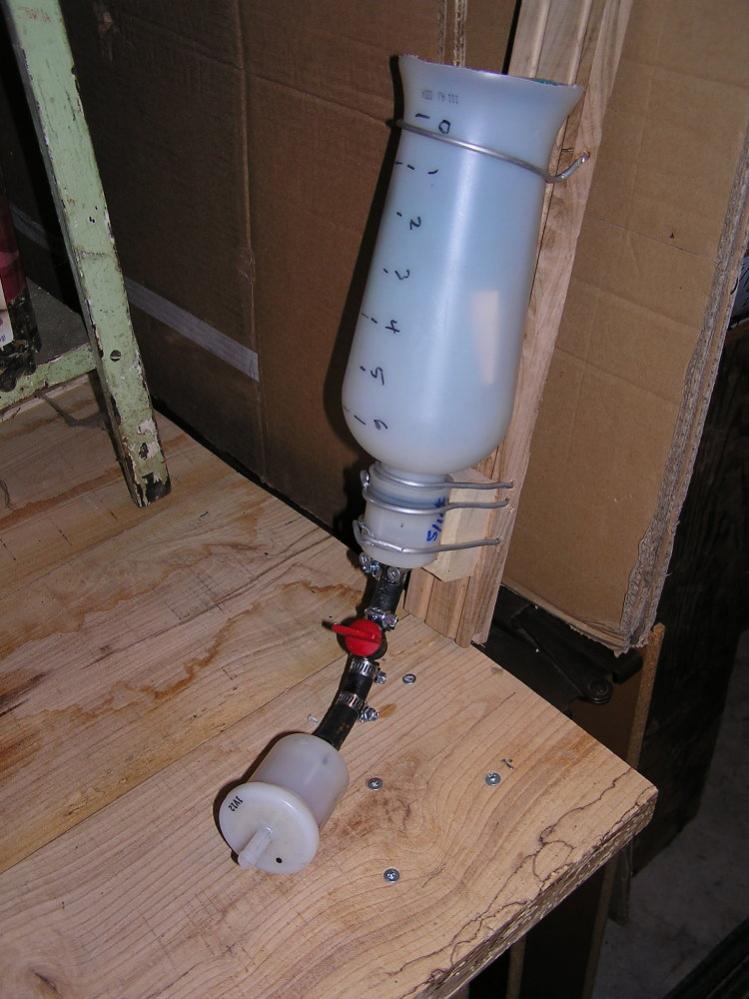

I made a fuel filter tester and it really shows the difference between a new one and an older one with some clogging.
Even with a funnel (it has a fine filter screen good enuff to remove water), I still have trouble more often that I want to put up with. Interesting that other tractors I have do not have any trouble like this BX with same fuel.

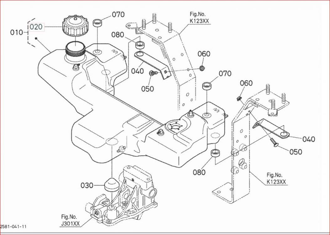

Take a close look at the tank picture (below), I think everything you have said in the last 2 posts is going to be a fruitless endeavor!
There is no logical way of "cutting open the tank" you'll just have a dead tractor with a big hole in it!
For the life of me can not figure out how you think your getting your hand in the fuel opening to feel around???? That's one tiny opening!
Unless you have a snake cam your not going to see anything in the tank with a cell phone pic, way to many bends, it no where near a square or round tank, besides what is that going to do? "hey I see I have something in the tank".
DO NOT use a shop vac to remove fuel or any junk in the tank, I really don't want to read in the news how someone blew themselves sky high working on there tractor!:eek:
While diesel is not as flammable as gasoline it still is FUEL and it will burn, combust, or explode under the right circumstances, and shop vac's have a electric motor that throws enough sparks off the rotor to ignite it!
You only have 2 logical options for repair:;)
#1 Best initial option, I'm betting that you have an algae problem, get a bottle of fuel tank algaecide and let that do some work, most take less than 24 hours to clear up the mess, then treat your fuel in the future to prevent it from happening again.
#2 Option, Start with removing the seat and work down to the fenders, remove the ROPS and you should be able to get to the tank, if not keep removing parts till you get to it, and when I say remove I mean unbolt parts and leave them in good shape to replace!
Remove the tank and pull the sending unit out of it and either just replace the tank, P/N K2581-54700 $168.51, or spend some time cleaning it out completely.

Good Lord almighty , was the guy that designed that on an acid trip and smoking crack at the same time??:eek:
