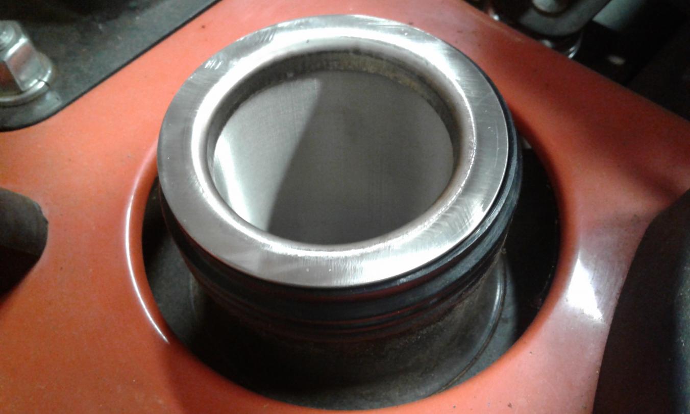

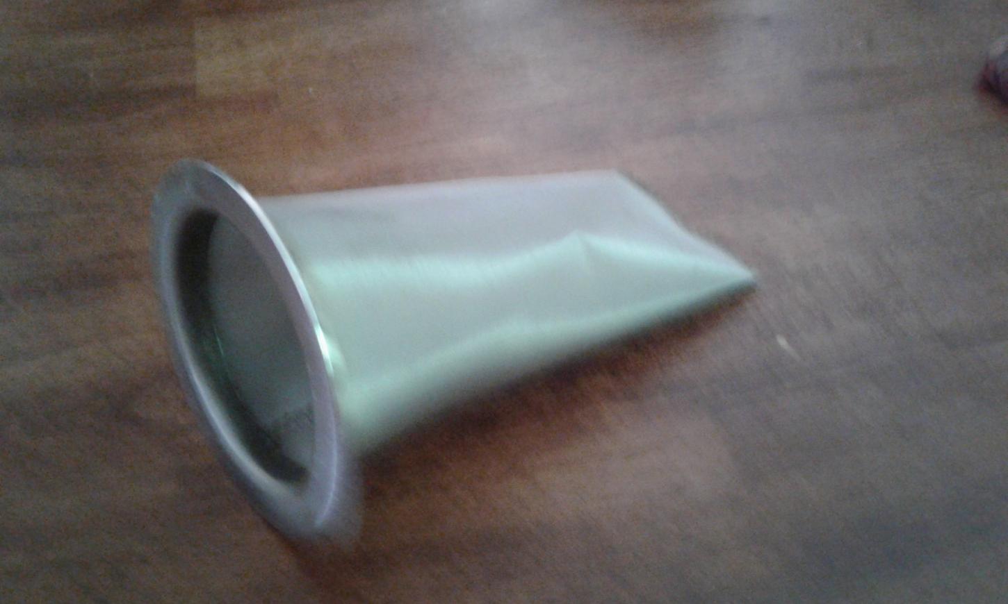

Unfortunately I could not find a pre-made screen for the BX23 filler neck and had to fabricate one myself. It is made from a stainless steel screen taken from a tea strainer found on Evil Bay and some modified white plastic plumbing adapters.
Me and another forum member had the same thought at the same time - never knowing what the other was doing! .....drew plans and sent to the same company and I had one of those made......
IT cost me about $75 .....but I have never had a dirty filter....I know that is crazy, but I filter going in with a Teflon filter and I have a 50 micro just in case!

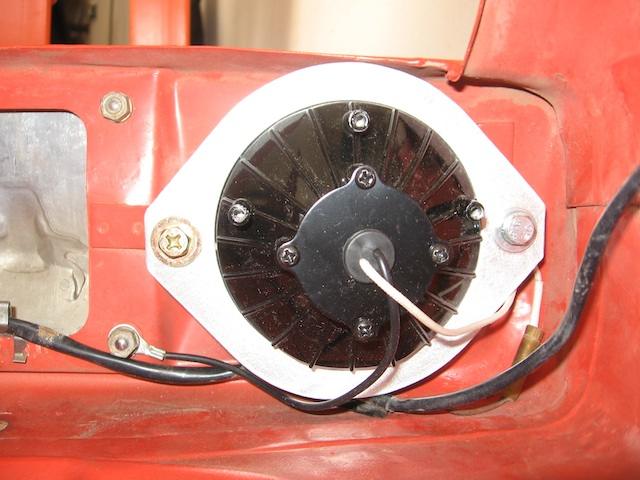

That looks just like the replacement one I bought they must have improved them somewhere along the line my original one was just bare stamped steel and completely rusted. You will need to look elsewhere for the problem it was probably just dirt in one of your cans you might want to try a screen like a couple other members mentioned above.
I pulled the sending unit out today and not one spec of rust. So I still don't know what the contamination was in the tank.
Hey Ed is this the same style fuel level sending unit you had? The metal on this one looks plated, (galvanized?).
Looks like stainless to me. ;)
