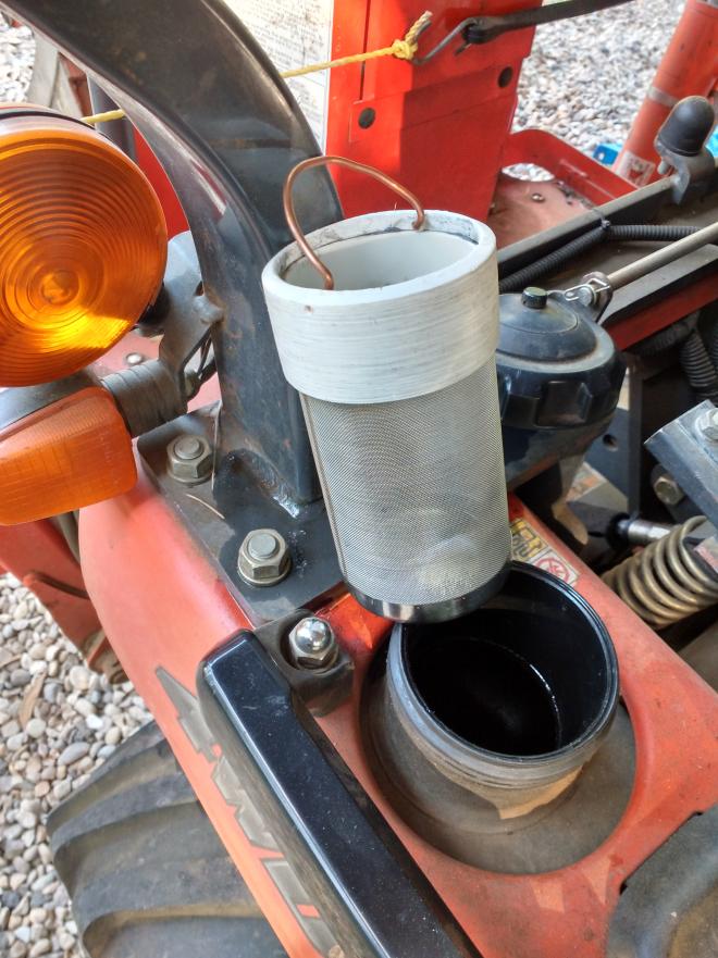

For those of you that have had this problem and managed to clean out the tank solve it, save yourself future headaches and put a screen filter in the filler neck of the tank. It won't solve all the problems like algae and rust, but will keep trash from entering the fuel tank.
Does anyone have a source for such a thing? I would be interested.

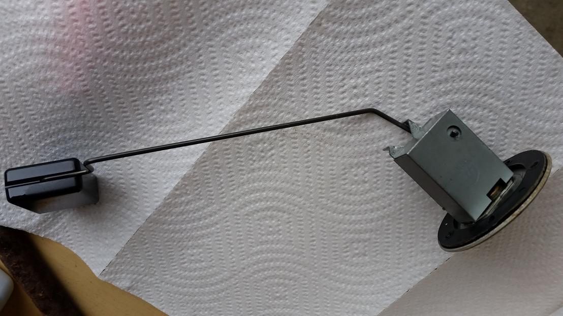

Here is the part number for the Fuel Sensor K2581-61370
You might be able to just clean the loose rust off of yours mine was still working but rusted bad so I replaced it.

I pulled the sending unit out today and not one spec of rust. So I still don't know what the contamination was in the tank.
Hey Ed is this the same style fuel level sending unit you had? The metal on this one looks plated, (galvanized?).

Unfortunately I could not find a pre-made screen for the BX23 filler neck and had to fabricate one myself. It is made from a stainless steel screen taken from a tea strainer found on Evil Bay and some modified white plastic plumbing adapters.
