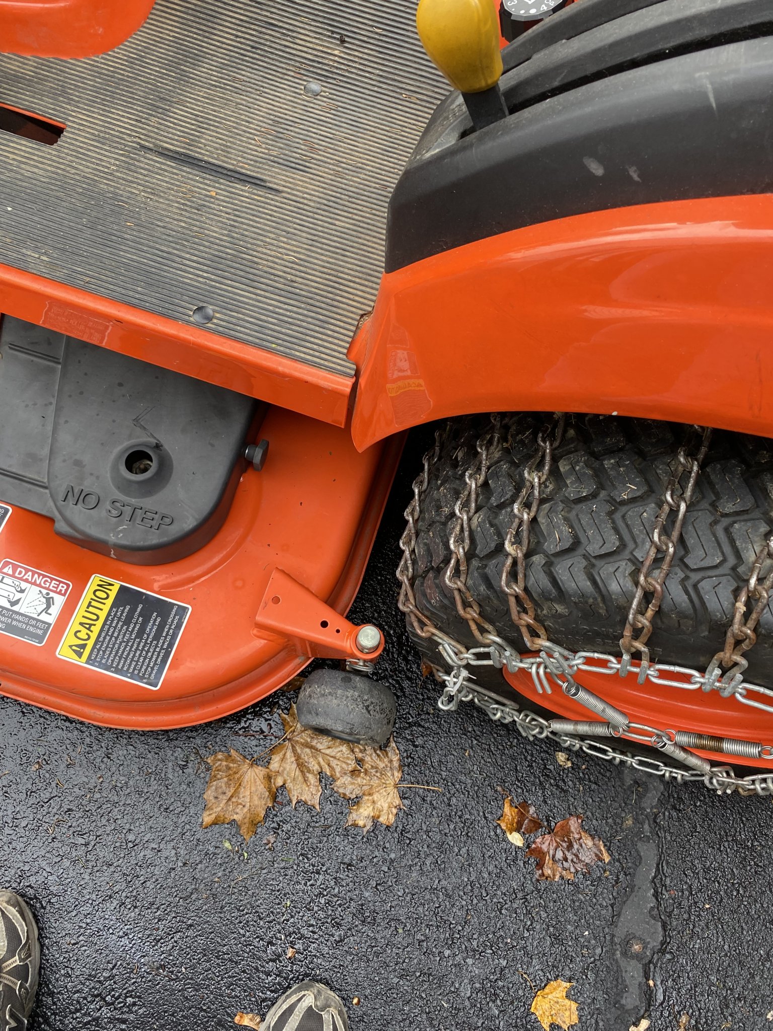

I just installed the RCK54-23BX on my BX1880 that has 2” wheel spacers. I think part of the clearance is due to having turf tires which aren’t as tall at the outside edges. IMG_0715.jpeg

First vid, Ive seen it before, is only 1 1/2" spacers, I would love 3". Second vid no MMM! The OP has turf tires which gives more clearance. Again on my machine BX23S 54" deck R4 tires with the deck raised I can not turn the left rear gage wheel so my crippled self can easily roll the MMM out from under the tractor. It will turn if I drop the MMM almost to the ground. Spacers will only make that worse. Like I said if the left rear goes flat while mowing either the tire side wall (VERY THIN) gets torn up or that gage wheel. Maybe both? If I cant go big I will do without.
