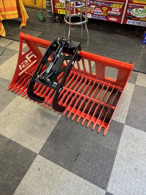

Thats exactly what I did.
but I went with the Artillian single grapple. It's built like a tank... very happy with the construction.
It's designed for their rock bucket which has a square top rail.... mine has a round tube... so I had to do a little fab on my bucket.... just a top bracket for the top 2 bolts.... EZ-PZ
actually getting ready to go out there now and weld it up.
It will be removable, But I'll prolly keep it on there.

Just a note to consider: If the cylinder is not at full extension when the grapple is closed, you can bend the bucket, I had that problems in one of my designs of grapples.

good point. I'm pretty sure it's extended all the way..... but I'll double check it today....
never got around to welding it yesterday.....

Got the mount all buttoned up ....
FYI, If anyone is looking for a decent Kubota Orange, I picked up a 6-pack of this on the Amazonian for $42 smackers.... 7 bucks a can ain't bad I reckon.... spech'lly when they deliver it to ya.
Pretty good match.... close enough.
