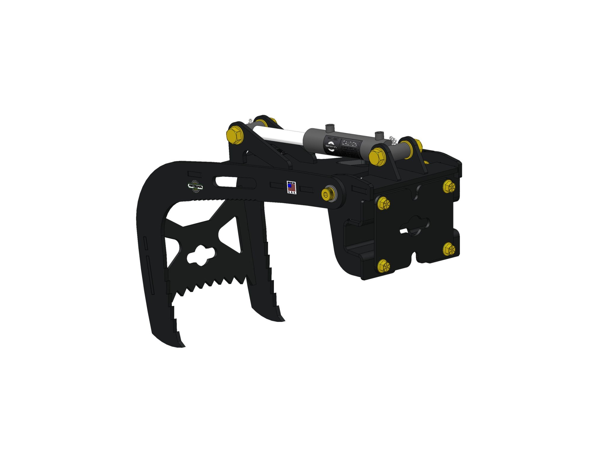

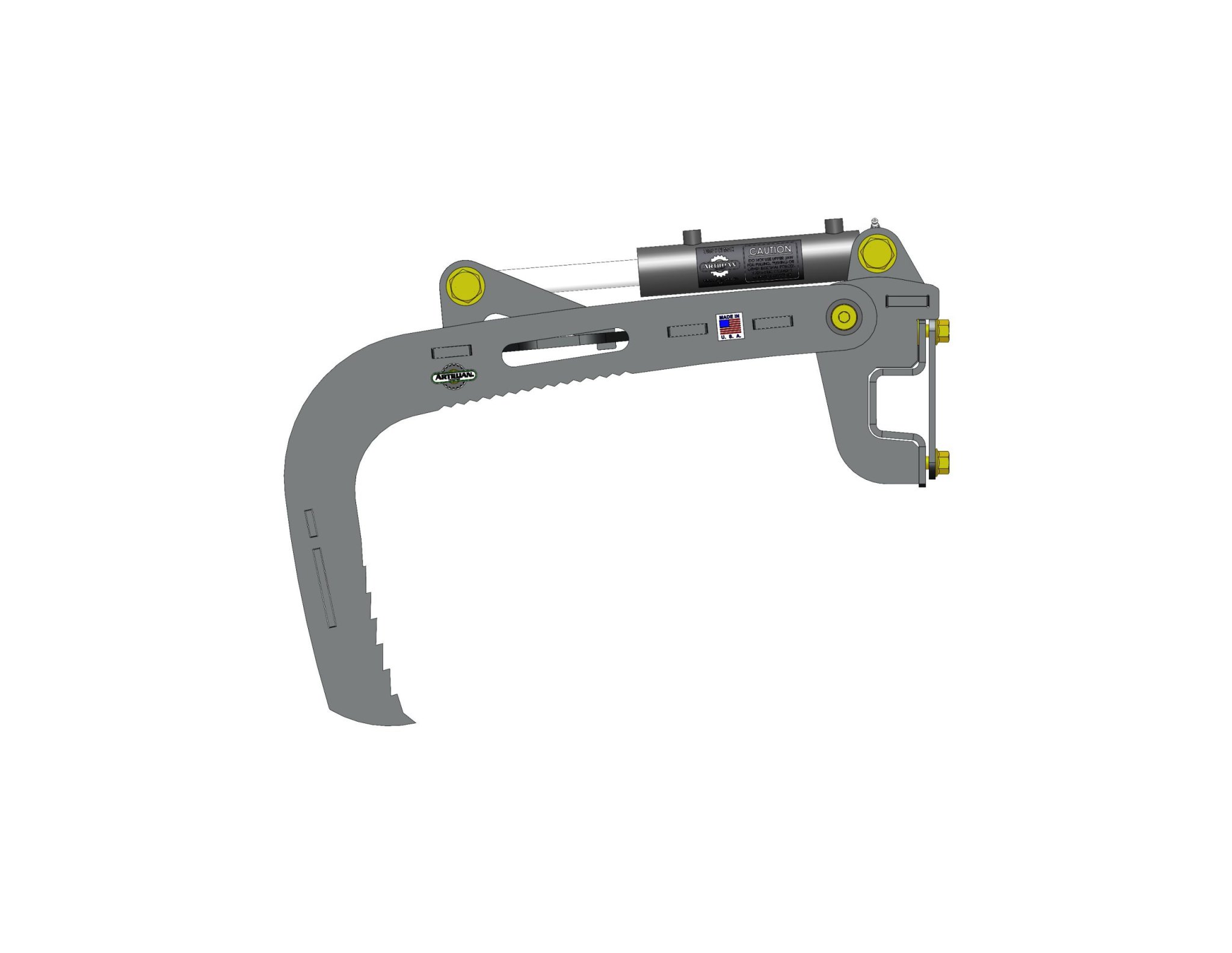

I'm just sniffing around to see what buckets weigh as a comparison ... because I would really like a grapple to mostly help with firewood logs....
but most I see are around 350lbs I found a few in the 200-260 range.... but most are $2-3k
right now I use forks... but it's a pain in the sack when they roll off.... I could make a small hydraulic grapple finger to hold them...... BUT I kinda over engineered the forks and they are a bit heavy "as-is"
I might just make my own bolt on small finger for the bucket...... and also make it adaptable so's I kin also bolt it onto the forks and give it a go...... see how it works.
so anyway, thats whats in my brain right now.
something like this here....
12,905
5,637

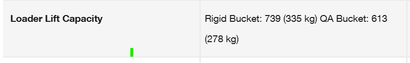

yes, while the SSQA bucket weighs less, you need to SUBTRACT the weight of the SSQA adapter from the 'what will the loader lift' value..... THAT is the number that guys whine about when saying SSAQ can't lift as much as pinon.
Negative, the loader was equipped with SSQA so the documented lift amount does not change.
12,905
5,637
well I'm confused.....
seems the SSQA bucket is 4# lighter than 4pin, so WHY to guys keep posting SSQA can't lift as much ? 'They' say 100# less, which I assumed was the SSQA frame weight
I hate to say it, but this is incorrect.
The loader with the SSQA has a lower lift capacity than the loader without the SSQA. Because of the added weight of the SSQA.

So your saying this quote is correct?
Soopitup
BX23S
Oct 25, 2018
369
164
New England
I think you're missing this part.
Comparison of SSQA loader vs pin on loader lift capacity.
Not simply SSQA loader lift capacity.
The 2 loaders are effectively identical except for the SSQA attachment. Remove the attachment and you have the pin on loader, with the higher non SSQA loader lift capacity.
33,358
8,680
You need to go back and read the first 4 posts in this thread and you will understand (or you should) why his statement is wrong.
Soopitup
BX23S
Oct 25, 2018
369
164
New England
Let's try it this way.
In the first post OP asked about bucket weight.
In the second post he was given bucket weight for for both pin on and SSQA buckets.
In the third post he then said this regarding the 2 weights.
(4th post is actually irrelevant to this)
Thanks...
Interesting, The SSQA bucket weighs 4lbs less...
If I'm reading that correctly.
This has one of two meanings as far as I can tell.
A - He was thinking of the difference in lift capacity between the pin on and SSQA loaders, and had previously thought the bucket weight was the cause of the lower capacity of the SSQA loader, and so was surprised to see the SSQA bucket was actually lighter than the pin on bucket.
OR
B - He was just surprised the SSQA bucket was lighter than the pin on bucket.
The way I read it, Jay took the OPs meaning as option A, and replied;
If the OP meant option A, Jays answer, while not completely clear, is correct. He's explaining that the capacity difference is due to the addition of the SSQA adapter, and not due to bucket weight.
If the OP meant option B, Jays answer doesn't apply, but is still correct. He's explaining that the capacity difference is due to the addition of the SSQA adapter.
You then told Jay his answer was incorrect.
Then I told you that you were incorrect, ect.
If I'm missing something please explain.
33,358
8,680
I can't state it any other way:
Greenvillejay said that he needs to subtract the weight of the SSQA Adapter, to get the loader lift value.
The loader lift value is already stated no subtracting is required!
