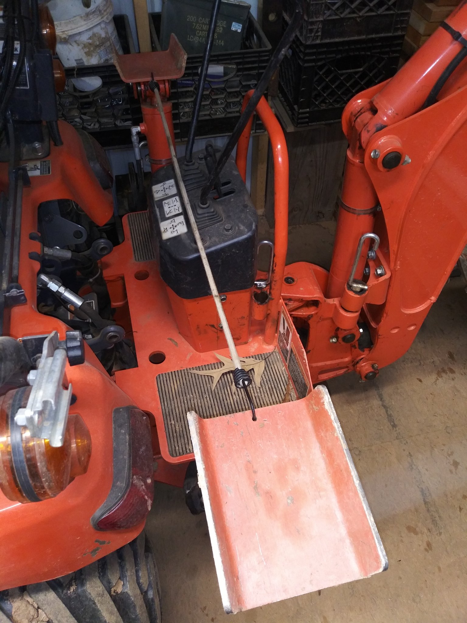

Here is what I did on my BX25D....
a 50 cent bungee cord and 2 small holes on the feet of the hoe! Hold them up !
Cord goes right in front of the joystick controls - so you see it in your way before you move the outriggers!

hmm.. mine don't go down very far, maybe 1/4" after a day....
'cheap rachet strap' sounds like a great idea though !!!
far better than a bungee that WILL let go at the WRONG time !

I get that a bungee can break - but it is simple, no ratchet to loosen or tighten - and for the simplicity ....... going on 4 years - before the strap, I would start tractor and raise both out riggers and hoe bucket before moving forward.

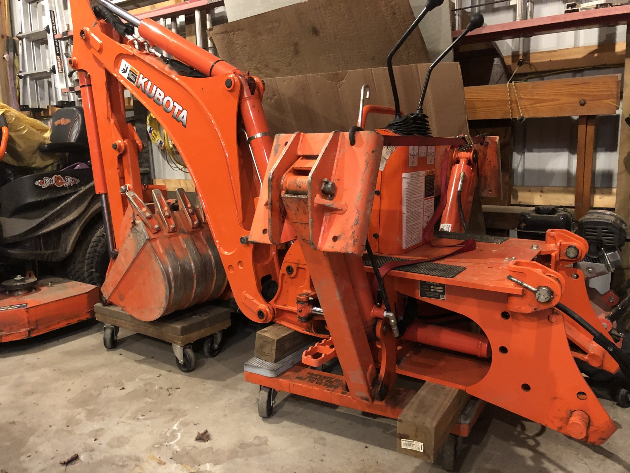

Mine is a little over a year old. Very very limited hoe use. I have found they have not leaked down yet.
While on the tractor at least...when I take the hoe off, I come back a day later and fund the arms sinking..takes maybe a few weeks before they go totally flat.

A ratchet strap will not stretch as a bungee cord will.
My stabilizers are much too heavy (L48 TLB) to trust a bungee cord.
