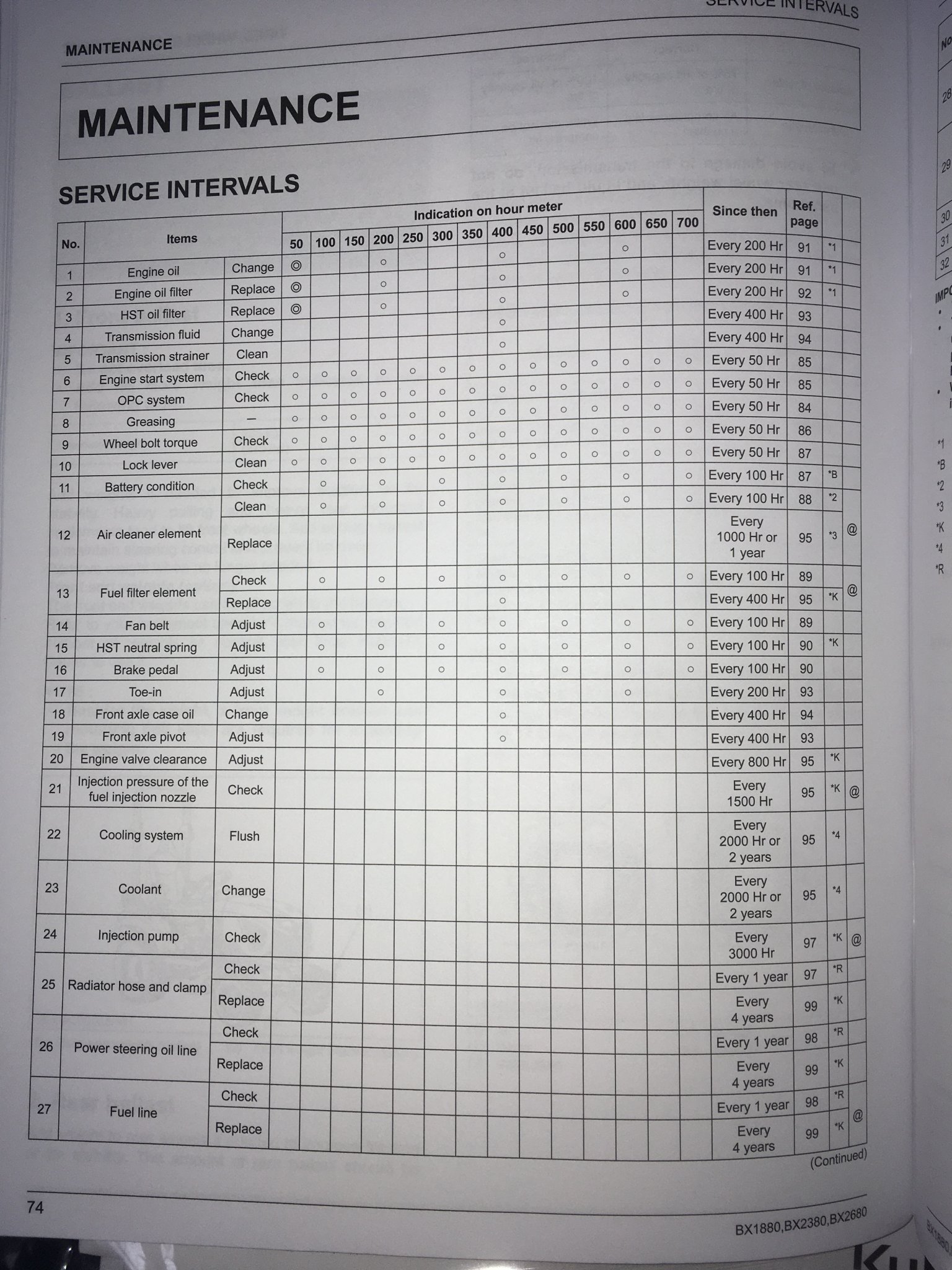

Look in your manual! What is required and what is suggested is two different things. At 50 hours I wouldnt get carried away.

Unless I'm seeing it wrong my manual shows just a filter change at 50 hours on hydraulics. Is this right? Dealer said at one time he would wait till a 100 hours.
10,355
2,171
The chart is obviously correct .......... but I will tell you this, changing the oils out a bit early and or cleaning the screen of debris will only increase the lifespan of the tractor.

I see no reason to be changing fuel filters at 50 hours or even 100 hours. If you are using clean fuel, then the fuel filters should go easily 4 or 5 hundred hours. Think of your car, whether gas or diesel, how often do you replace the fuel filters? On the hydraulic oil, or the engine oil, that is important, since contaminates can do damage, but fuel filters hold the contaminates well, and the only other fuel problems one can encounter is the moisture that won't pass through the filter. I can see upgrading the type of fuel filter your tractor uses, but changing it for the sake of change makes no sense to me. Do you think that farmers change the fuel filters every 100 hours? Look at the chart above, it recommends checking the fuel filter, not replacing it.
I would be more inclined to follow the maintenance schedule that Kubota recommends, and do the maintenance as required by the schedule.
