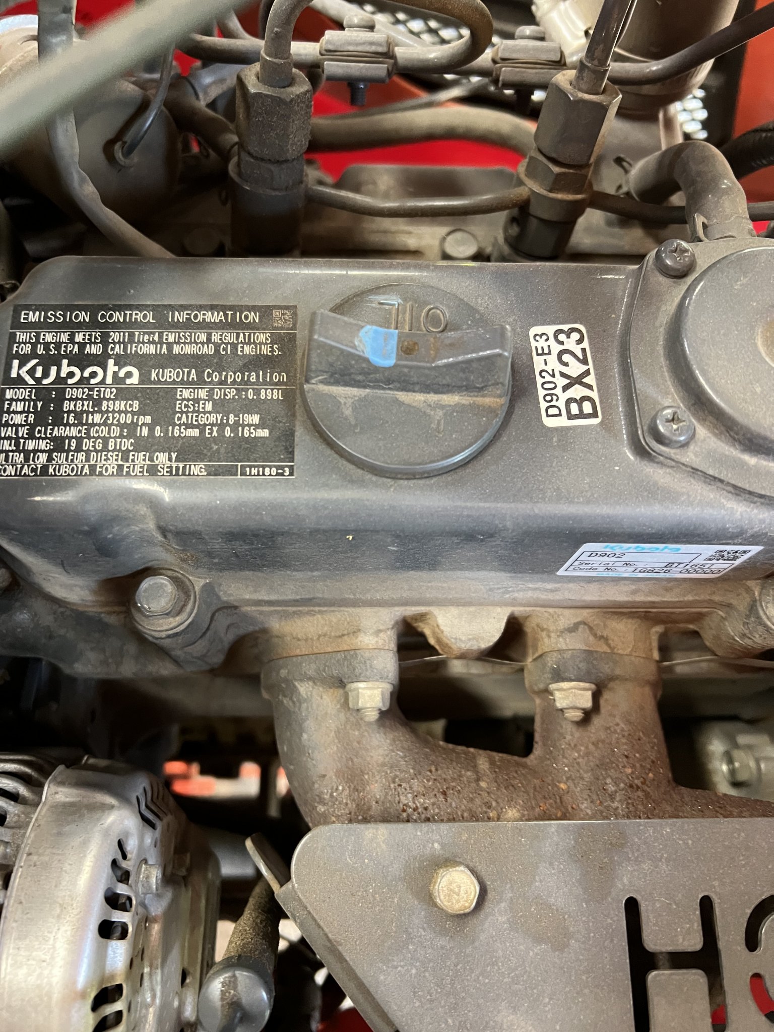

Hokie you are good at this stuff. Question I just changed oil on my BX 2670 4 qts of Kubotas finest. In my garage so I know it’s not leaking. I can not get oil to register on dipstick. BX 2670 has 2 oil filler points I used one on top. Thoughts.

Not Hokie, but have a BX - - did you use the fill hole on the valve cover? The one with the blue dot on my tractor?
Did you give it some time before you checked the oil? Takes a little while to get oil to the pan through the heads.
Did you run it for 15 seconds or so before you checked it?
I usually get about 3 gallons in my older BX. Engine is very similar.
Do run it a little. If it’s overfill, drain some out.
