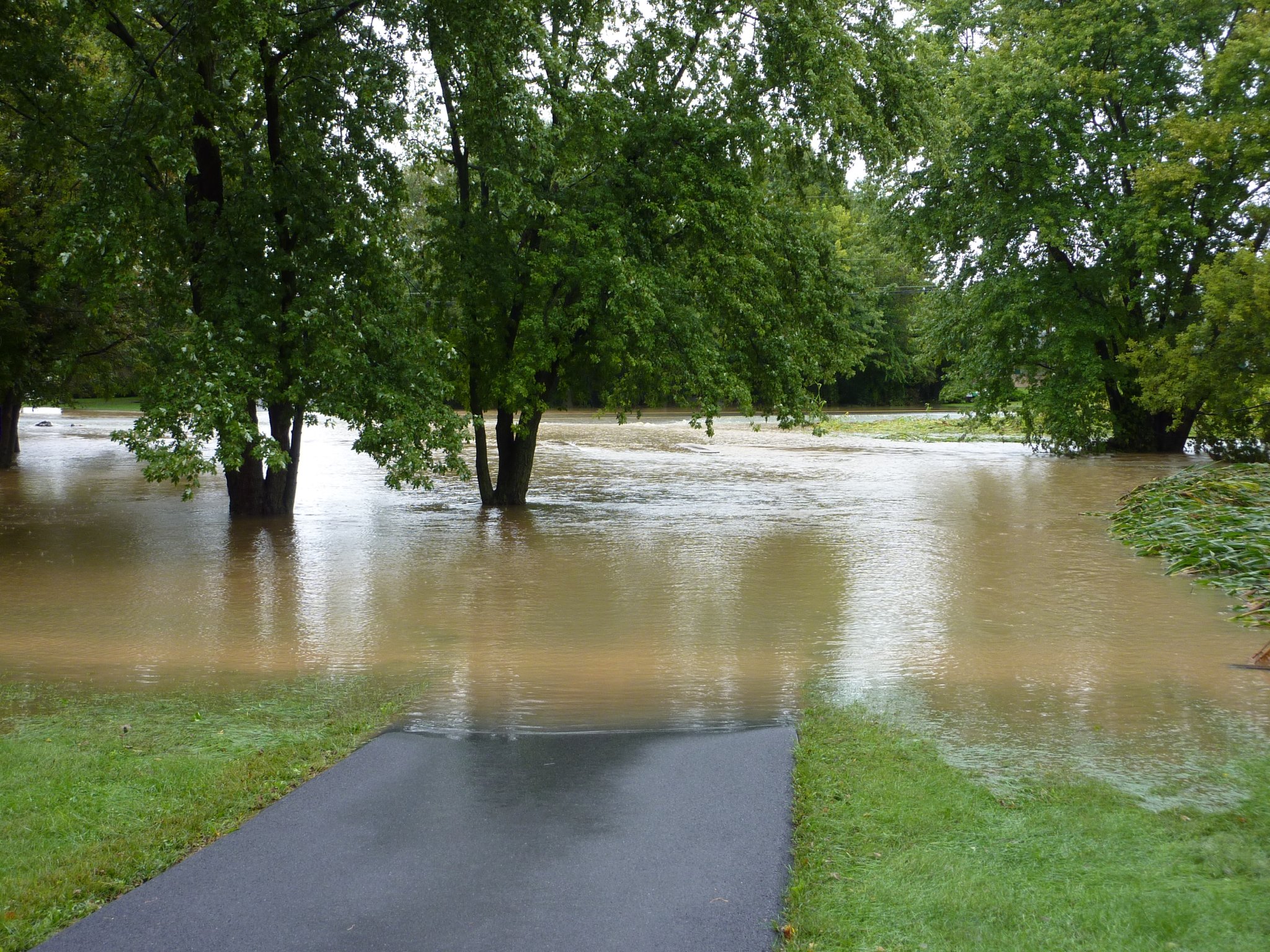

Years ago I read the statement "Experience is what you get right after you needed it".
Your tractor is apparently not suitable for the current conditions. Sounds like you need to adjust the schedule or get something completely different. When my front yard has excess moisture as in the pic below, I wait a few days to mow:)

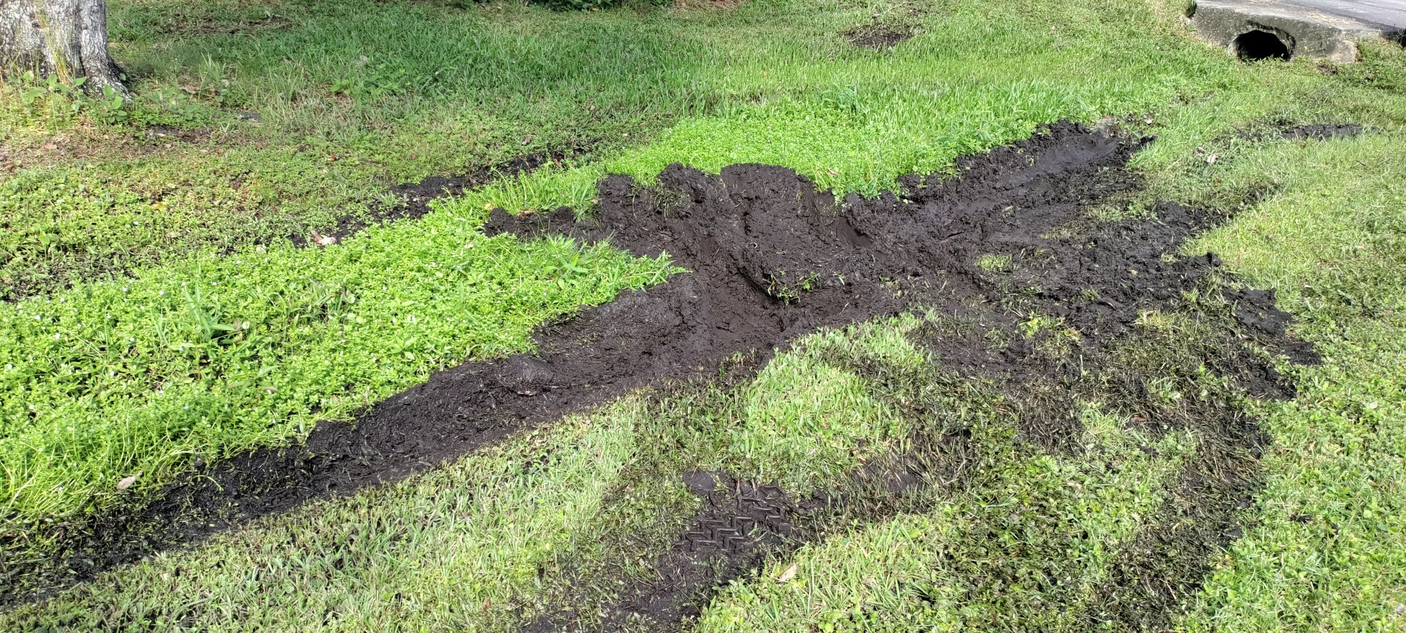

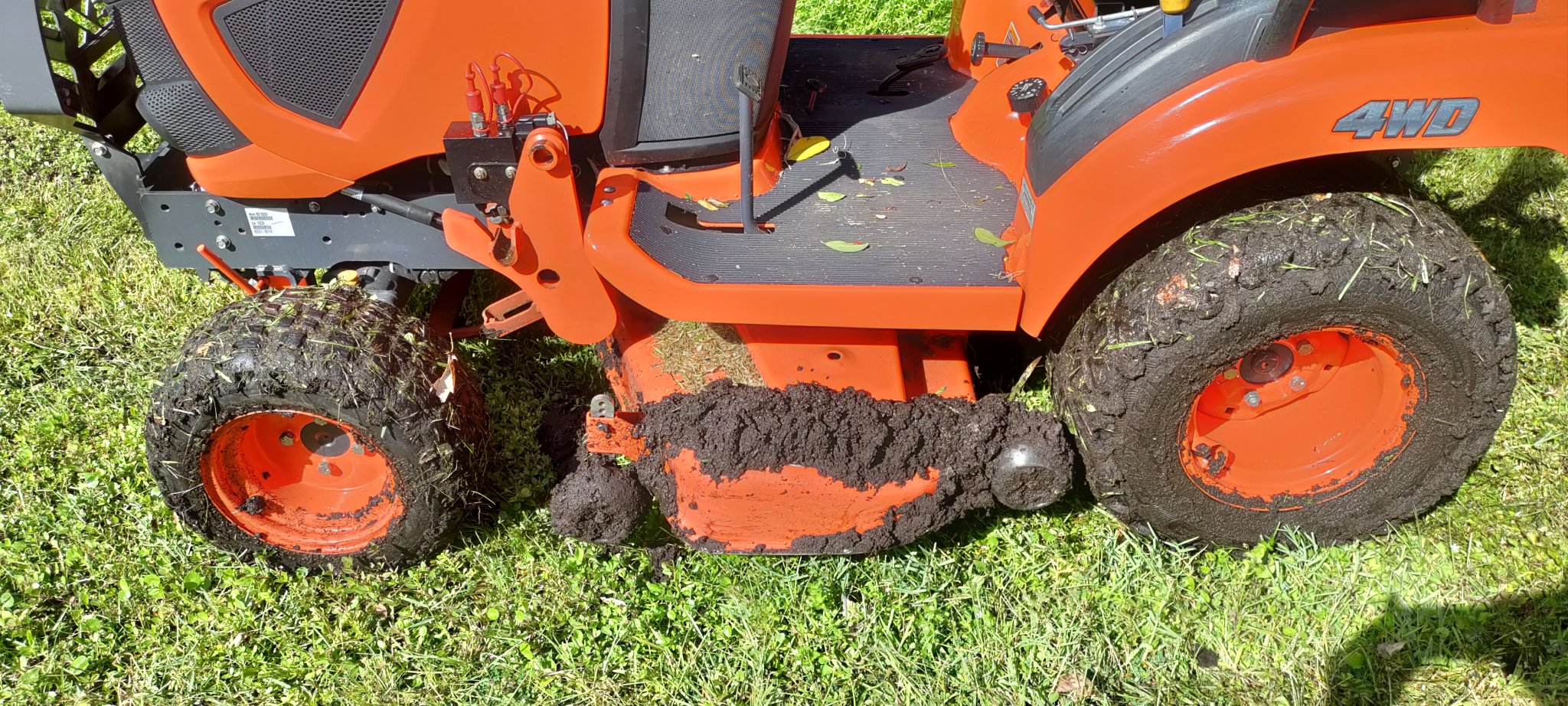

I would usually post in the “What you did “ thread, but fitting here.
I was just trying to mow. Usually wouldn’t mow this wet, but we’ve got another 5-6 days of rain predicted.
Like @xrocketengineer, it’s juicy.
I wasn’t trying to push, pull, or carry anything. Just driving over to mow…..SQUISH…..
