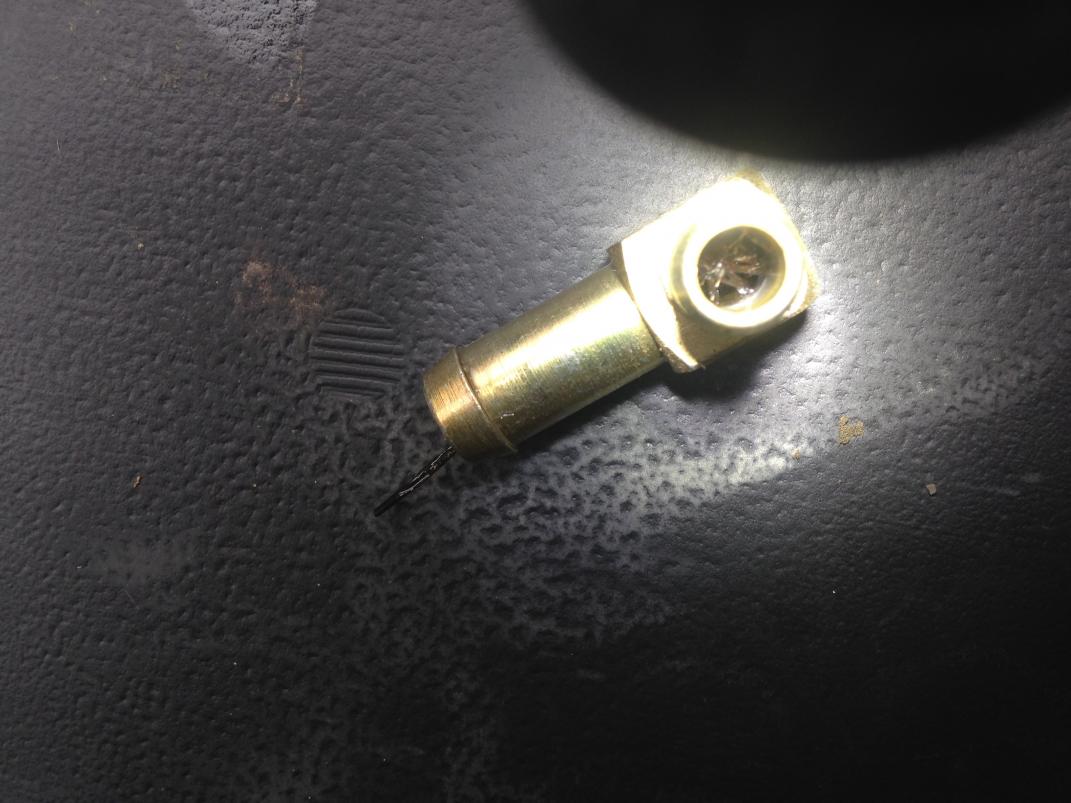

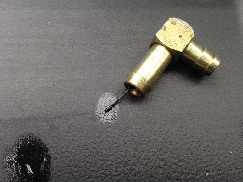

Hopefully it won't come to that. We tried new fuel, fuel additives, two filter changes, blowing back through the line lines and everything else we could think of as removing the tank and outlet is a bear. This turned out to be the culprit:

Triple R: Thanks much. Was that a fitting manufacturing defect? or stuff caught there? I have been wondering about crud in the tank due to mishandling in the factory. I recall a case where workers at an auto factory were too lazy to return pop bottles after lunch, but left them in the car doors at the assembly line. Could be the case where gum wrappers and such were easily dropped in the open tanks as they went down the line. Maybe mad at the boss that day.
It was clogged with vegetation, either someone was careless when filling it up or left the cap off as we fuel from a 300 gallon tank with a big filter. I have seen them plugged with plastic particles left in during manufacturing.
