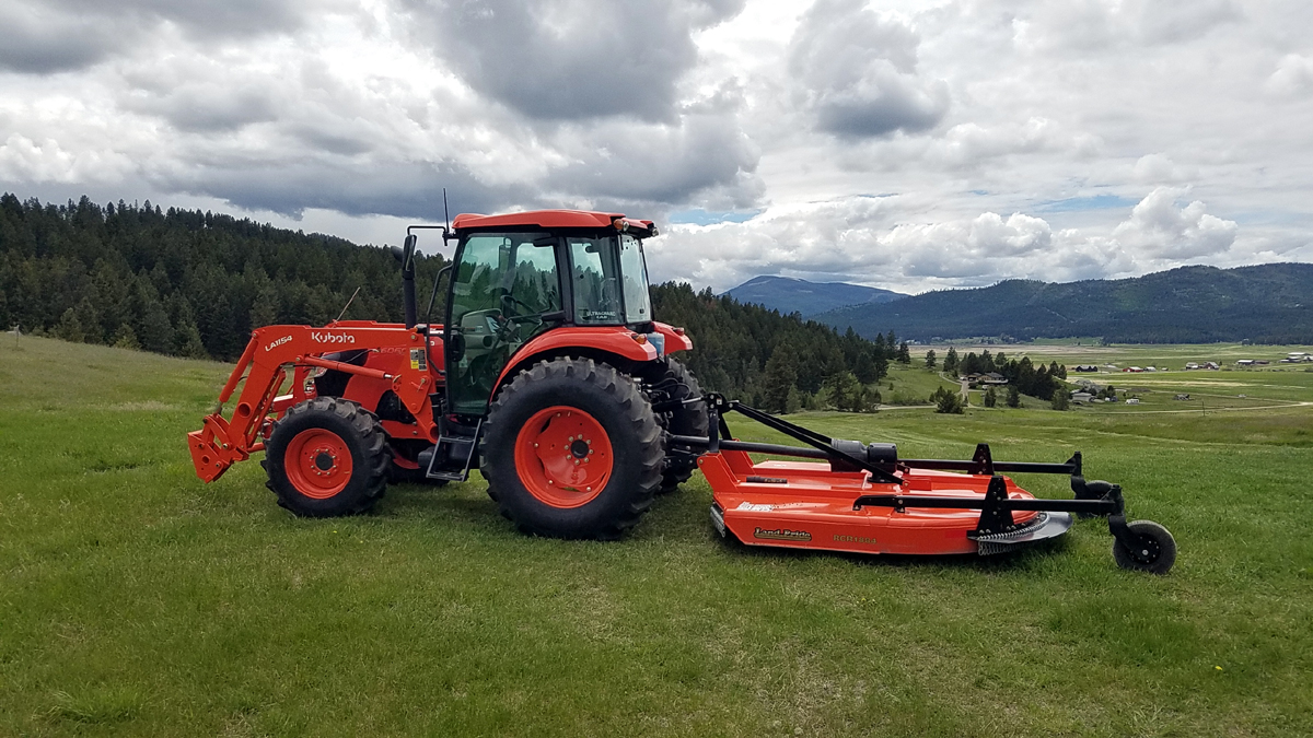

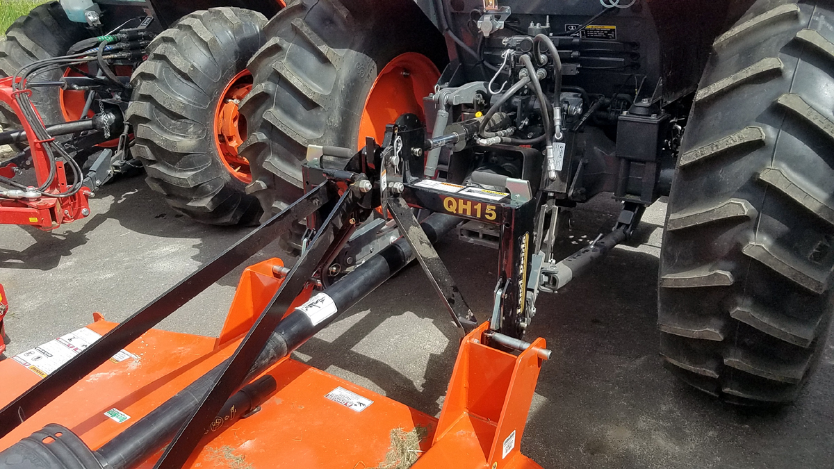

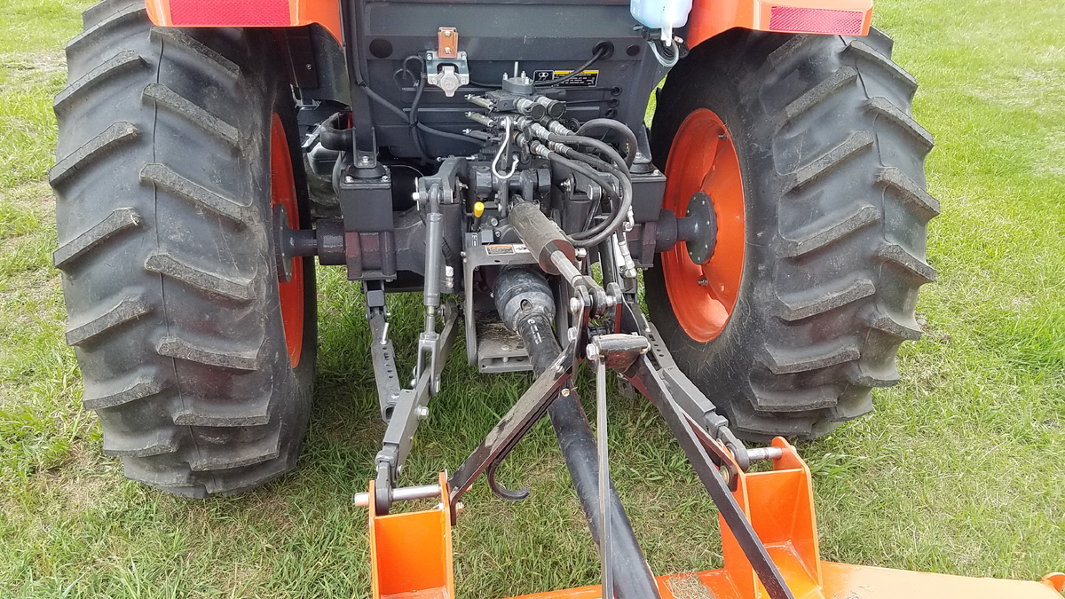

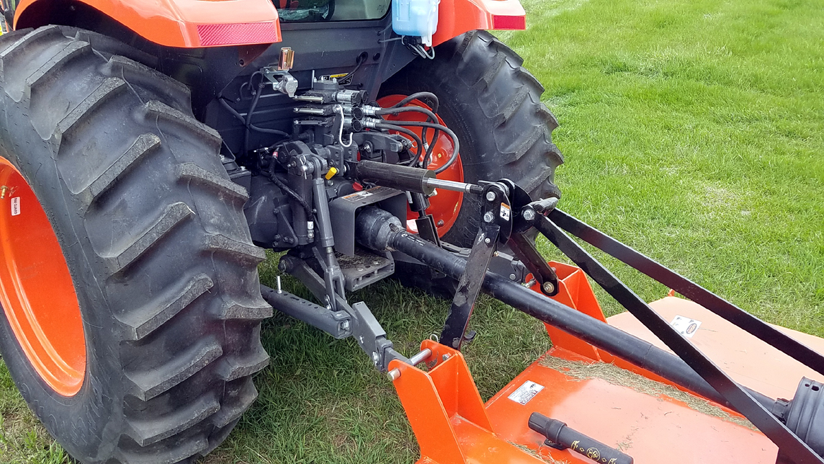

I got the RCR1884 hooked up to the M6060 which is basically the same tractor as @drtom in terms of outer geometry. I discovered that the QH15 Quick Hitch isn't compatible with the rotary cutter and tractor, but had no problems getting everything set up and connected once I removed the QH.

That's a good question. I was going to say that the M6060 PTO output shaft is about 5" higher from the ground compared to the MX6000 so the PTO shaft makes a steeper angle relative to the cutter. However, I just went back outside to look at the cutter and I think I had the top hook on the QH15 set wrong. The way I had it resulted in the QH interfering with the PTO shaft, but disregard my comment re compatibility ... for the moment at least.

Matt, you were absolutely right to question my assertion that the QH15 and RCR1884 were incompatible. With a cooler head I got the grapple on the M and then took another look at the QH15. After a bit of messing around I got it set up. Thanks for the sanity check.
