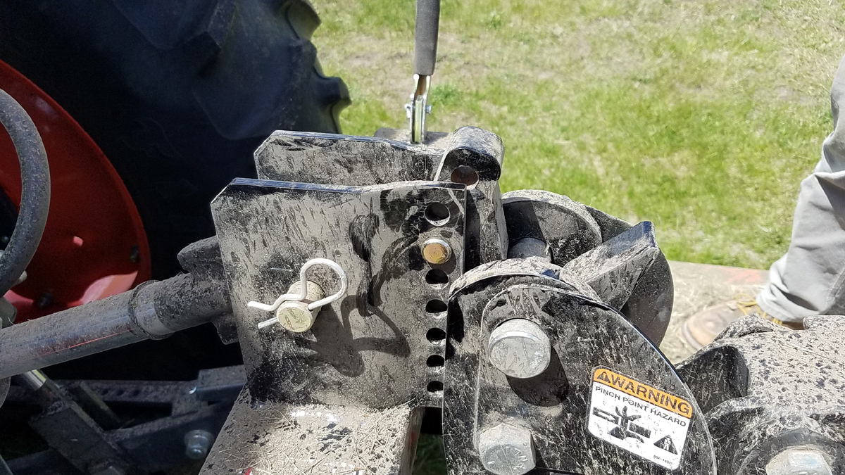

I don't know about the Speeco but I knew the QH15 was a POS design. The top hook is secured with two clevis pins that have tiny retention clips to keep the pins in place. This morning I needed to move some big logs using the grapple, and in the process of unhooking the RCR1884 noticed that one pin was AWOL and the other pin was hanging on with the help of dust. The retention clip for that pin was also AWOL. This obviously happened while cutting the field yesterday afternoon. I'm going to buy some grade 8 bolts, nuts and washers and bolt the bloody hook in place.
I did the same thing. Funny thing was I've never used the adjustment. All of my implements are newer Land Pride ones.

Yeah. I've never had a problem with the QH10 that has a fixed top hook so I'll fix this one in place with some good nuts and Loctite.
