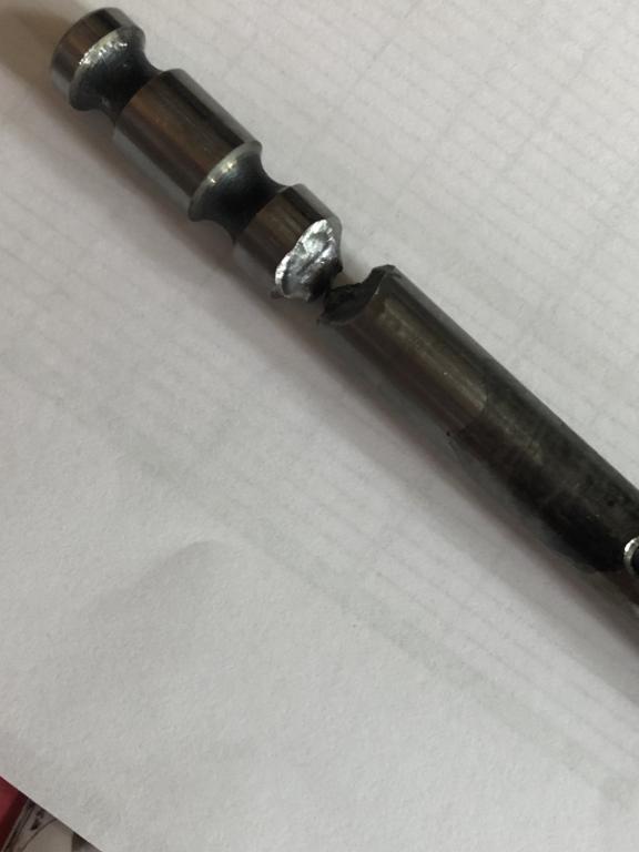

Sounds like you have a feedback rod or control issue.
Pictures of the Three point and controls will help. ;)

I hope this is better(they do show up on the previous message for me though)
Yep now you got it working.
Yikes, monromatic controls... Nothing about the US versions are the same with that system, ours are all mechanically controlled.
All I can say is up and down are controlled by electric solenoids, and that controller is sealed if I remember right, so no repairs are available for it.
Start by checking fuses and wiring, look at plug connections, ground wires and ground connections too.
