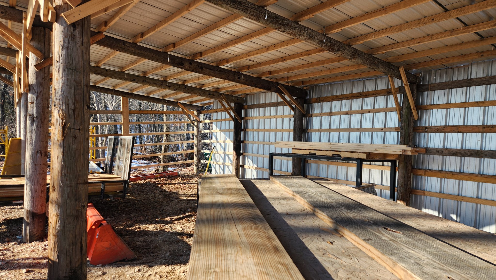

This is the view from the back looking South.
I am hopping to start the tin tomorrow.

Curious, am I the ONLY one that has major concerns over those 'braces' NOT doing what they're supposed to do ?
saw the 'oopsy' last night about the Heron Bridge DISASTER, due to NO proper bracing, dozens dead/maimed.....

May I ask what your concerns are? We built machinery sheds' in Pa. this way and they are still standing and in use 60 years later. ?

From the pictures the 'braces' between the posts and beams are simply overlapped and screwed. Wouldn't pass ANY building code around here, does not prevent 'racking'.
Have a look at any 'post and beam' built barn,shed, house, garage. You'll see braces are inset and pegged. Many barns here are 100+ ,still standing not ONE screw used.
Look as the 'heron river disaster' as to why proper bracing is essential.
Even easier use tractor to gently push on a post and watch roof beams move !

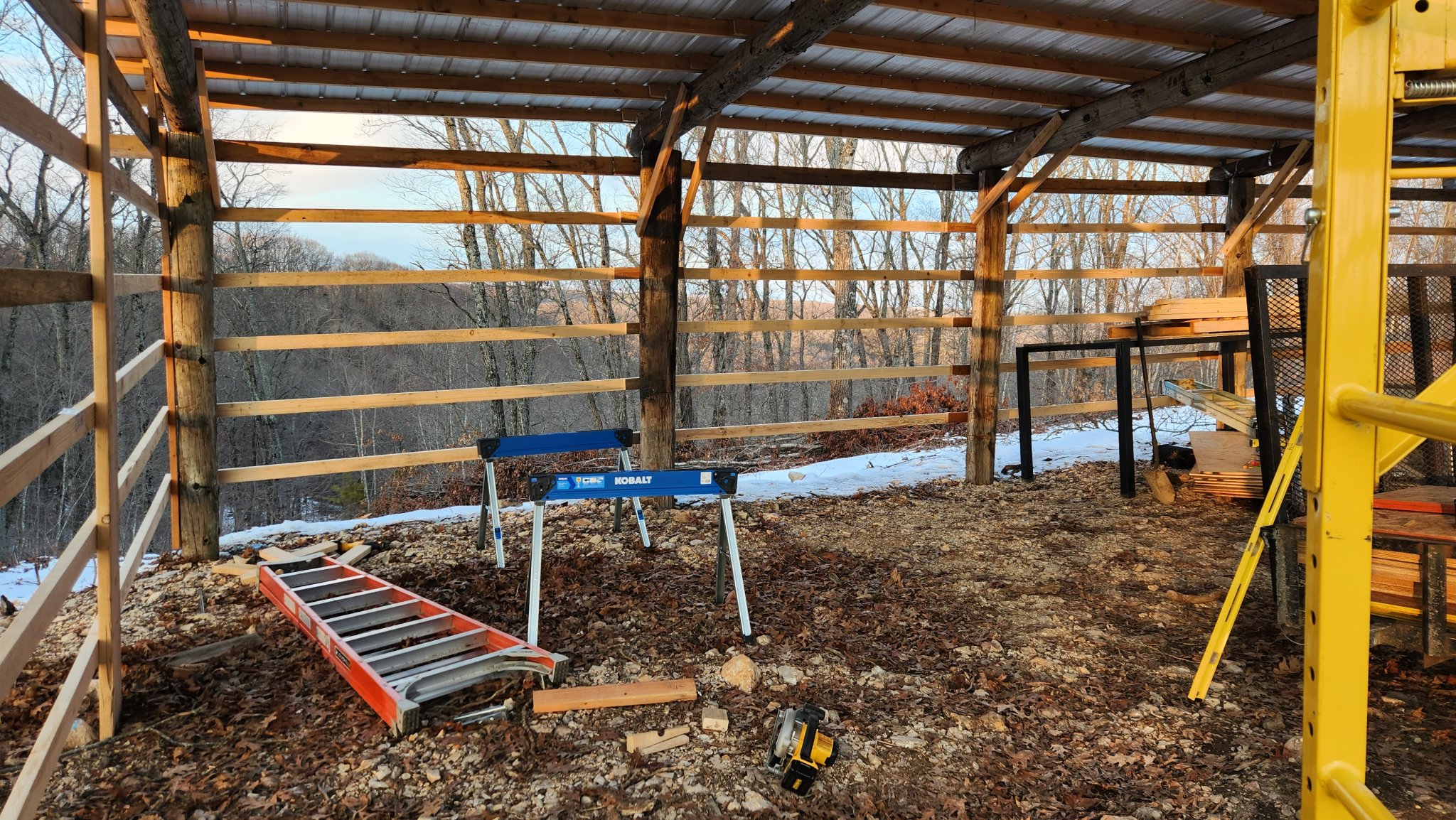

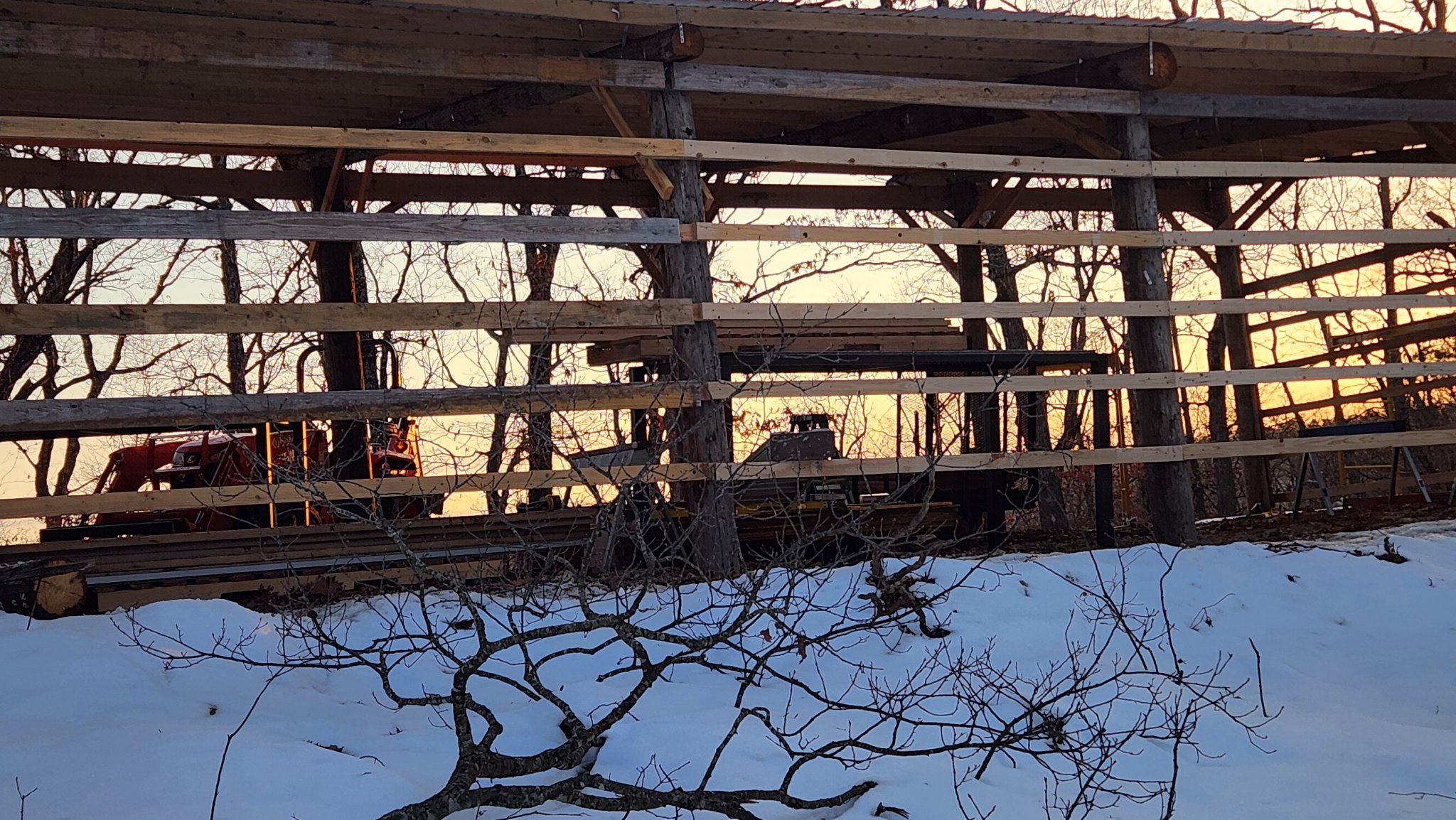

I only had 3 hours to work today. I got most of the back wall covered. Shead42.jpg shead43.jpg shead44.jpg
I should be able to finish this tomorrow.

so when Ol Man Winter blows hard, he'll take the shed to go visit the wicked witch of the east ( or west )????
that's NUTS, NOT in the ground.
Code here, Ontario, says below frost line ( 3 1/2 ft +-) so most go 4', 'magical' number, 4by8 sheets of plywood for forms.... 1/2 a 'sonotube'.... stuff nobody needs a tape measure for.
