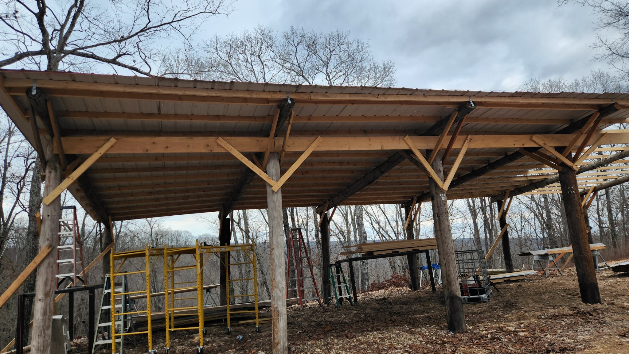

This was easer on all of us as they just pulled one up as they were ready to put it down.
The last sheet going down. The roof is 26' x 56'. When the weather warms up to 40* I will start putting up the framing for the walls.

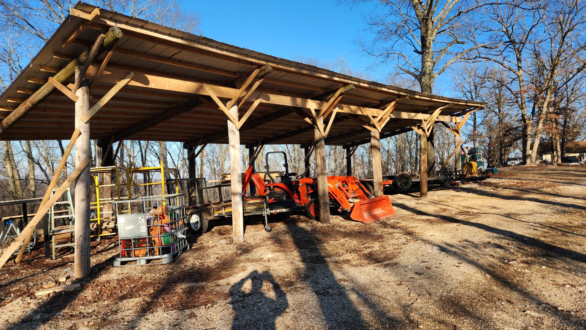

Here is the load of plywood backed in the shed.
This is a look at the front of the shed. The first bay will be open front and back so I can pull through with the long trailer. The side walls between the first 3 set's of post will be closed in. The tractor will go in the second bay from the right with wall on both sides.
The small flatbed will go in the middle bay. I have a trailer with 6 canoes on it that will go in the 4th bay and my 16' inclosed camping gear trailer will go in the end bay.
Behind the tractor you can see one of 3 pallet stands I was given. I will have one of these behind the short flatbed and canoe trailers. I can keep my 3 point attachments under them and other equipment on top.
