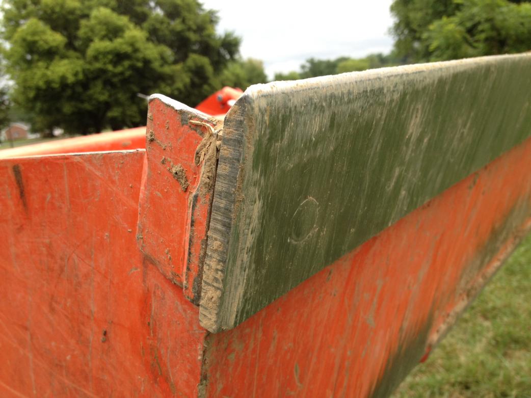

Here's mine. There was a thick SS bar left over from something at work I was able to use. Pieces of stainless threaded rod are plug welded into the bar and I drilled the factory edge. After bolting the edge onto the bucket, the rod was cut off flush with the nuts. By themselves, nuts don't seem to interfere very much with a smooth dump, although you can see they did snag a teensy bit of the load.

We do not get much snow here in NC so it would take my life time to wear out my bucket edge but I enjoy following most posts.
I saw a post while back where someone took a stall mat which was thick rubber and I also recall someone using a rubber conveyor to make a edge out of.
My recollection was that cut a strip 8" or so wide and bolted to bucket edge allowign it to stick out 4 or 5 inches. These seemed like a great idea.
