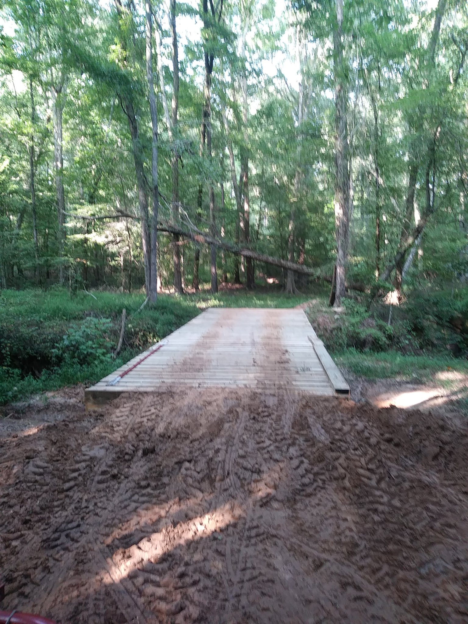

Arborist? No, I tell my friends my idea of a light pruning is a smaller chainsaw.
I consider myself a small-time tree farm hobbyist. I have a few acres of north Mississippi 'hill country' I like to piddle with. Here's one of my projects
