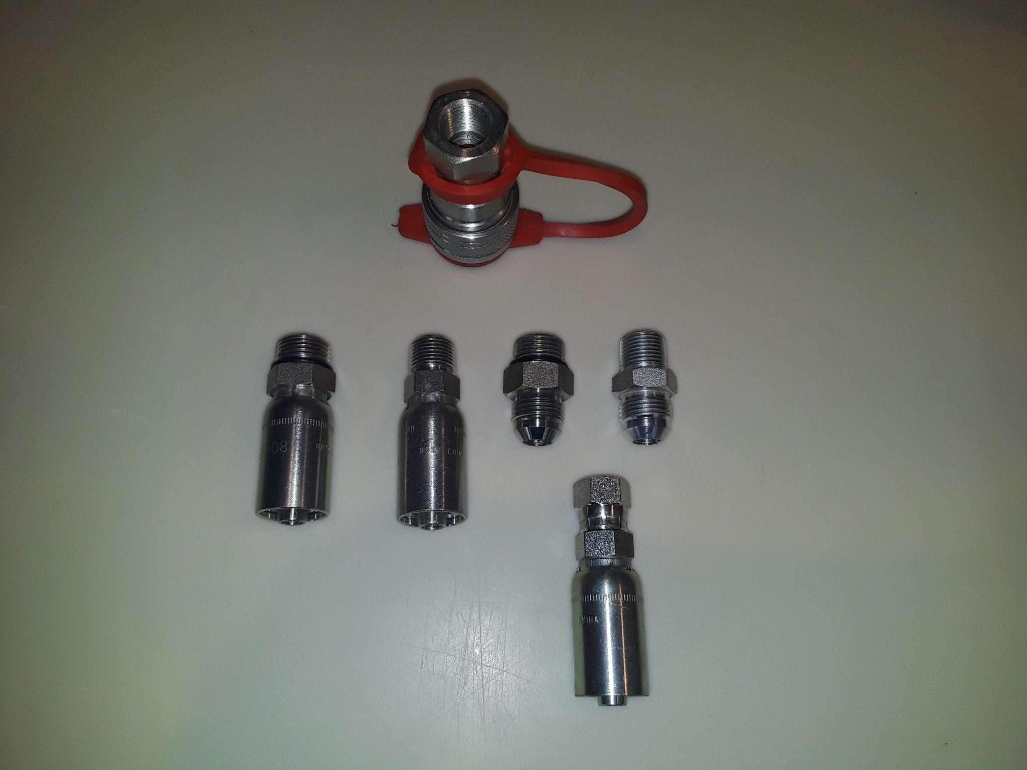

This is a matter of personal preference and to a lesser degree cost. The quick coupler on your tractor is almost certainly female pipe like the one in my picture. Your other choice is to purchase a new coupler with an SAE port on it.
Then you have three choices in hose end terminations as shown in the picture. Left to right SAE male boss, male pipe thread, or JIC female swivel. The SAE male boss is a custom made hose - the other two are off the shelf items.
You can screw the pipe thread hose end directly into the female port on an NPT coupler.
You can screw the SAE male boss directly into a SAE coupler.
Or you can use one of the adapters shown on the left to convert the coupler to male JIC and use a hose with a JIC swivel end on it. This is what Kubota typically does using an NPT coupler and JIC adapter,
My personal preference is an SAE coupler because I HATE pipe threads. Then its simply a matter of JIC female swivel hose and adapter or rigid SAE hose. For an unmounted quick coupler the SAE hose is fine but JIC swivel with adapter works better when you need to keep both hose and port ends stationary.
Just pick one.

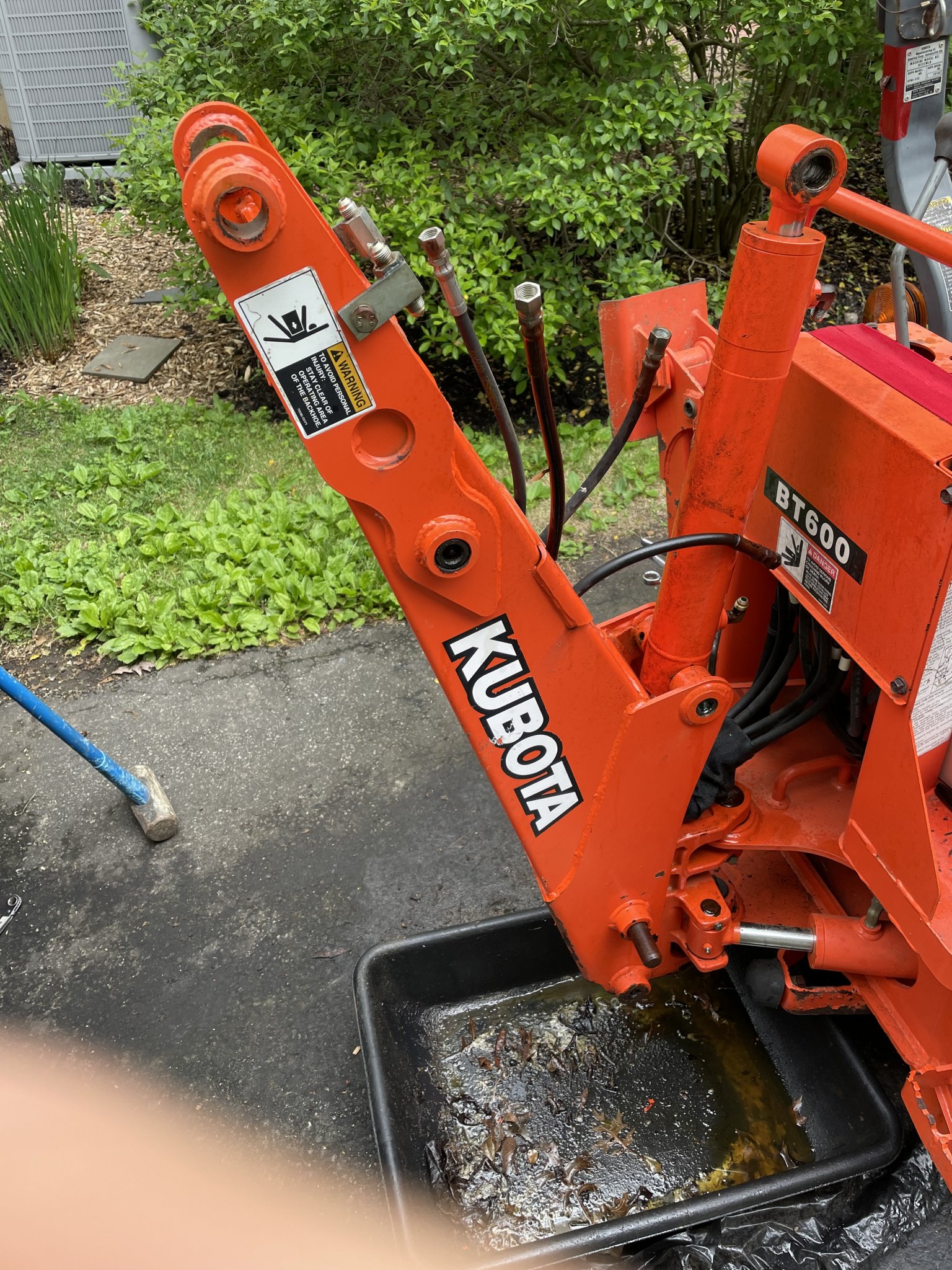

Just thought I'd pop in and share that a hose failed on my BT600 backhoe last year. As others have commented, it was a real bear replacing it and current Kubota OEM replacement hoses are not the narrow gauge ones that came from the factory.
Two weeks later, another backhoe hose failed! I was thinking maybe the machine is telling me to replace them all, but I stupidly ignored the message and had a local hydraulic shop make up a replacement. Kubota quoted $75. The identical Parker hose and fitting assembly was $35 at the local shop.

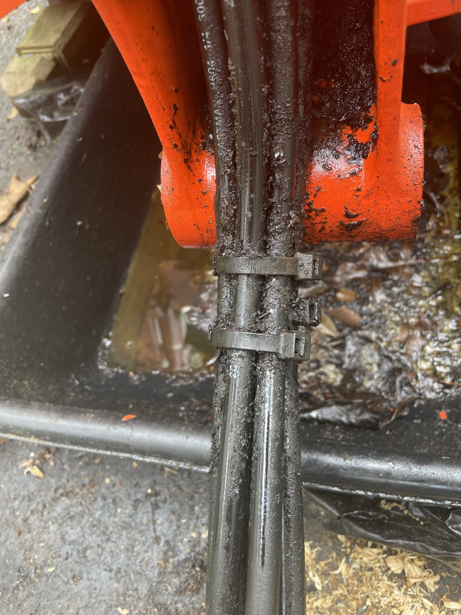

A month later, another hose failed! So I replaced all of them that run through that tiny little boom pivot knuckle. Even with the slightly larger hoses, they all fit.
Then, two days ago the backhoe supply hose blew out when I was ripping out tree roots to remove a stump. I found this thread while looking into maybe buying a hydraulic hose crimper. Kubota didn't have the hose in stock, but the price was $95. I checked discounthydraulics, and the same hose with shipping was ~$44. But based on previous experience, I went to my local hydraulic shop...and got hit with a bill for $72. It literally took less than 5 minutes for the guy to make the hose. So unless I find a hydraulic hose crimper for cheap and start making my own, I'll be buying from discounthydraulics from now on.

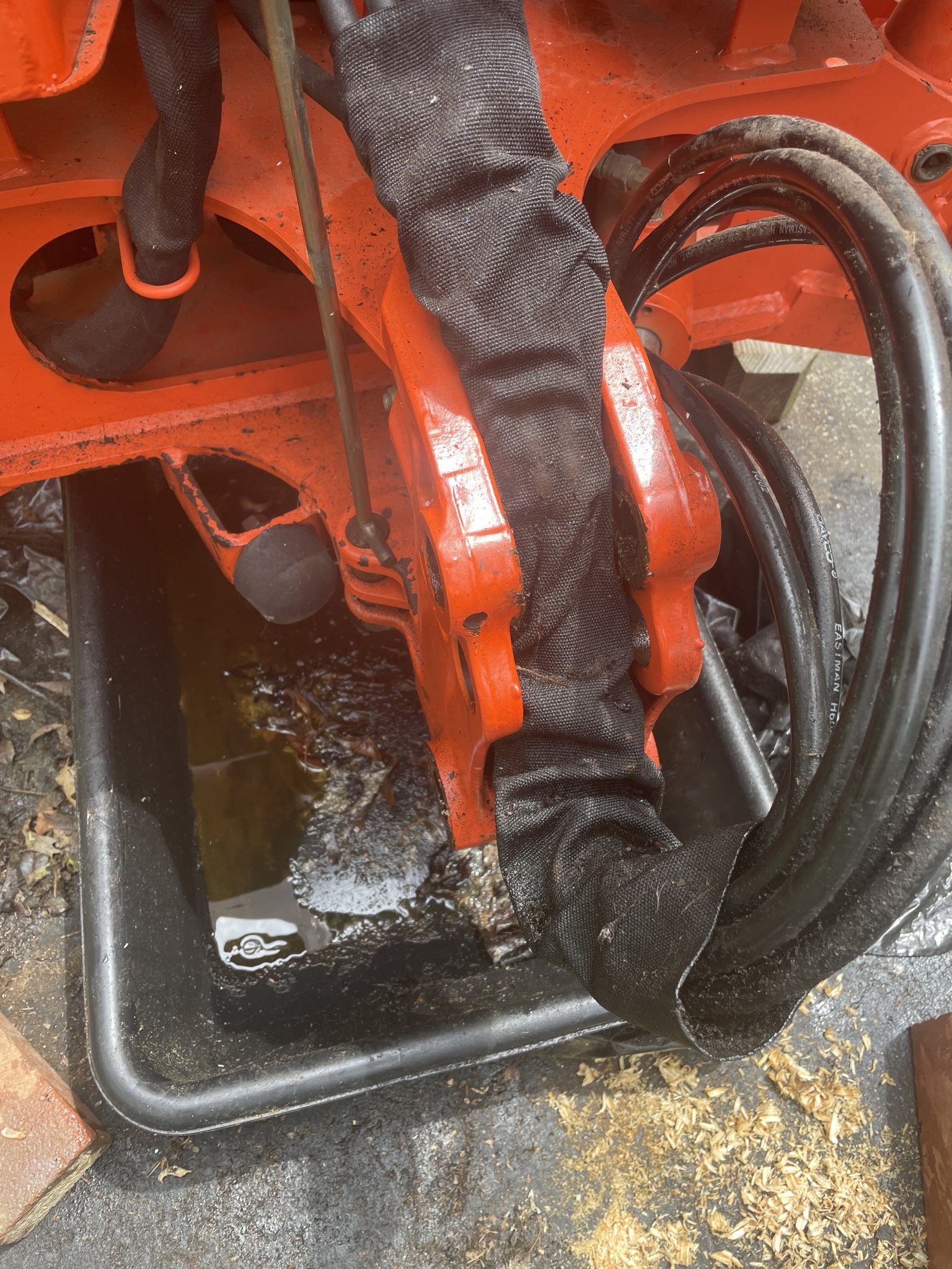

By the way, there are quite a few nylon sleeve listings on ebay. I bought these and am very pleased with them. Plus, the pricing was good. There are other sizes and quantities, of course.

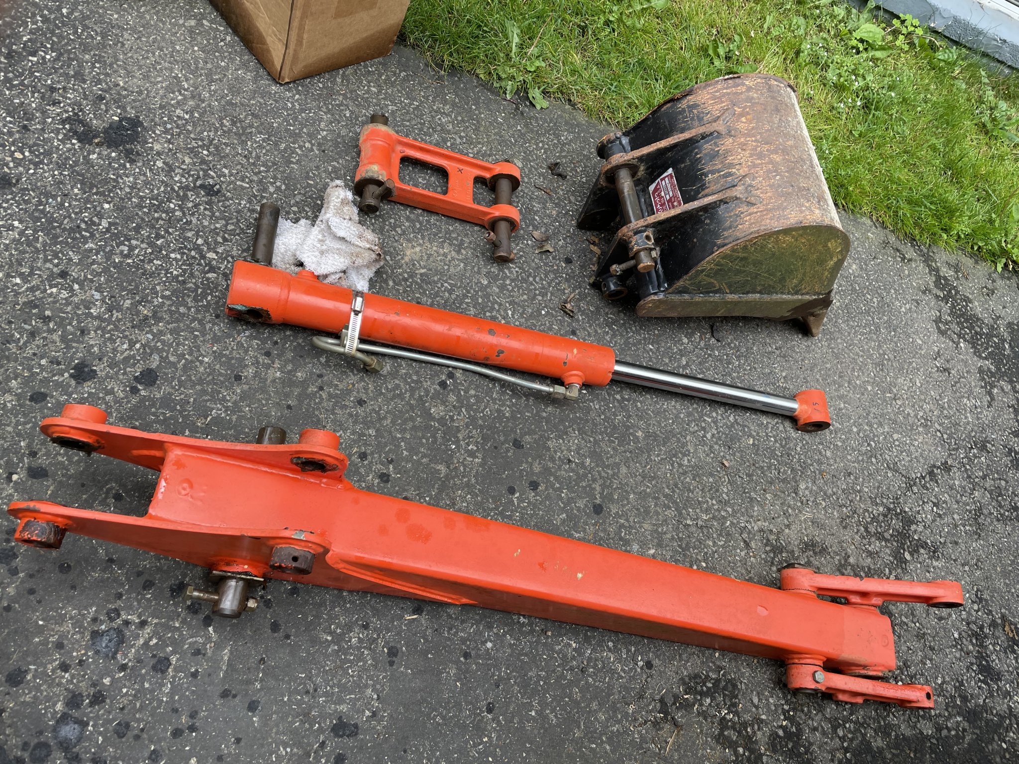

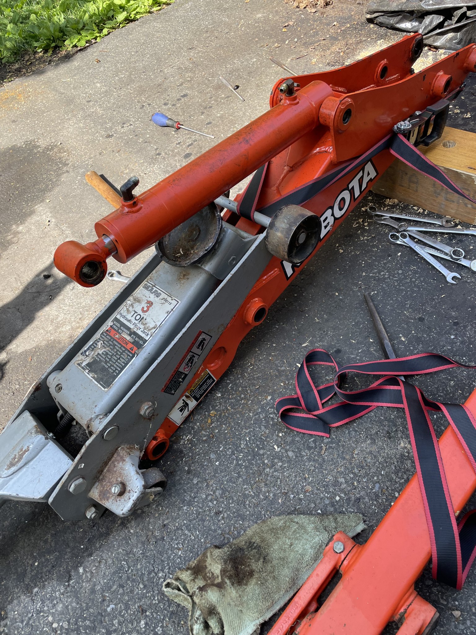

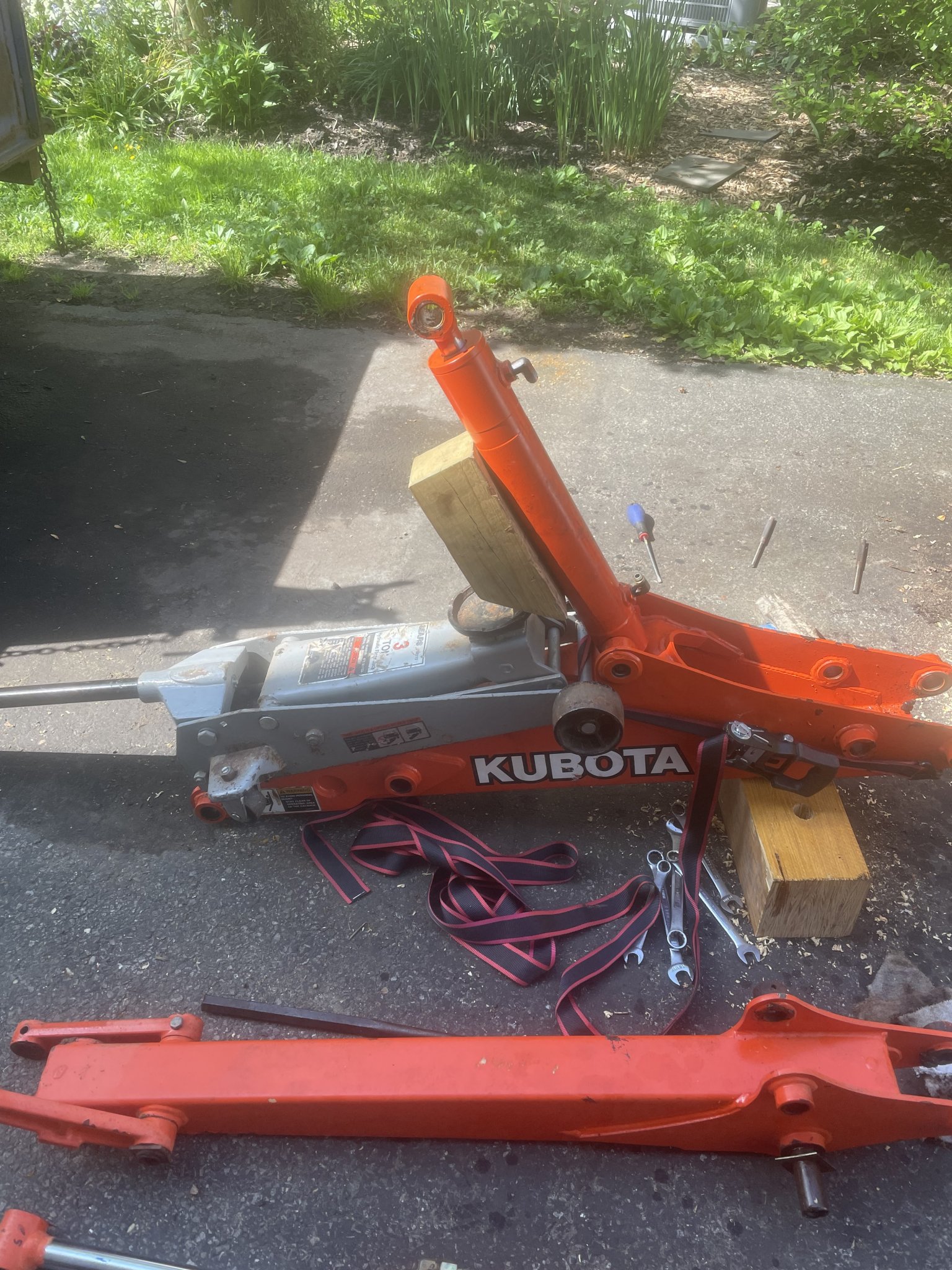

I just read this entire thread as I am diving into the BT600 on my BX22. I appreciate all the teaching, support, and encouragement here.
I acquired it over a year ago, after it had been sitting out under some trees for about 4 years. I got the fuel tank drained, new fuel filters installed, new battery, new fan (and CV joint boots while I had the drive shaft undone) and it started! I replaced all the hoses on the loader and those for the steering as they were dry and cracked. The backhoe hoses looked to be in better shape, BUT - once it was running the first time I tried to use the backhoe it blew a hose. It sat for quite a few months while we were out in California helping to care for a grandchild.
Now that I am back I dove back into it. The main boom cylinder pivot was dry and crusted to the pin, which likely didn't help the weak hose. I've attached photos of my process so far. You'll see I had to be creative to get that pin/cylinder broken free. I numbered the hoses and made a template of the order that they had laid them in for that tight bundle going through the lower channel. I know I have some hefty cable ties like they used to pack them down tightly.
I'll be ordering hoses from DHH next.
I have one question at this time:
"The external hoses at the top of the boom that arch over to the dipper stick:
75598-64550 and 75598-64560 currently have metal spring protectors on the length of them.
Unless I am just missing where they have them listed it appears that DHH seems to offer just spiral plastic or nylon protectors.
Would that be adequate? Or should I look further (Messick, etc.) ?"
