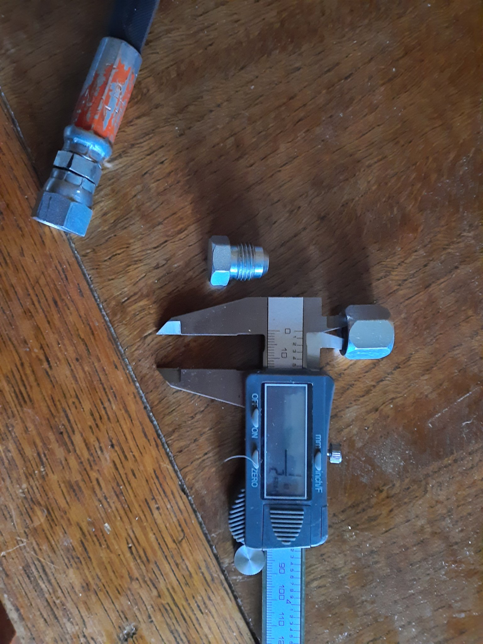

So, I've measured those...female cap is 1/2" ID; male plug is 17/32". I've taken a picture of that and maybe it will tell something. In looking at the chart at DHH in the thread guide section and those sizes don't seem to fit together. Here's the picture with a similar hose and fitting, the stop fluid bolt and the fluid cap with the caliper showing 1/2".
TG
I can see we need to talk about measuring threads. Thread sizes are given as the size of the OD on the male component - called the thread major diameter. In that picture you are measuring the inside diameter of a female thread. That will be the diameter of the root on a male thread = called the minor or root diameter. The root diameter will always be 2 times the thread depth smaller than the major diameter. In this case I think we are looking at a JIC-6 male fitting (based on the conical end) with a major diameter of 9/16 (,562) and a JIC-6 cap with a root diameter of .495. Assuming the swivel on the hose is also JIC it should have the same ID as the cap.
And JFYI - the female ID numbers given in the DHH thread chart are actually the pitch diameters which is yet another specification that falls in between the major and minor diameters. Online charts need to be taken with a large grain of salt, Here is my reference data - fvery reliable and chock full of all sorts of "interesting information.".

WE are having fun and you are catching on to the Swahili of hydraulic fittings.
Bwana will translate:
  1. You have JIC fittings.
  2. Based on your measurements they are dash size 06.
  3. You have 1/4" hose which is dash size 04.
  4. The correct hose end would be a 04-06 combination
  5. The hydraulic Swahili for a straight 37 degree female JIC swivel hose end fitting is FJX
  6. The hydraulic Swahili for a 90 degree female JIC swivel hose end fitting is FJX90
  7. A 1/4" hose with one female JIC 6 swivel end is specified as FJX-04-06
  8. A 1/4" hose with one 90 degree JIC 6 swivel end is specified as FJX90-04-06

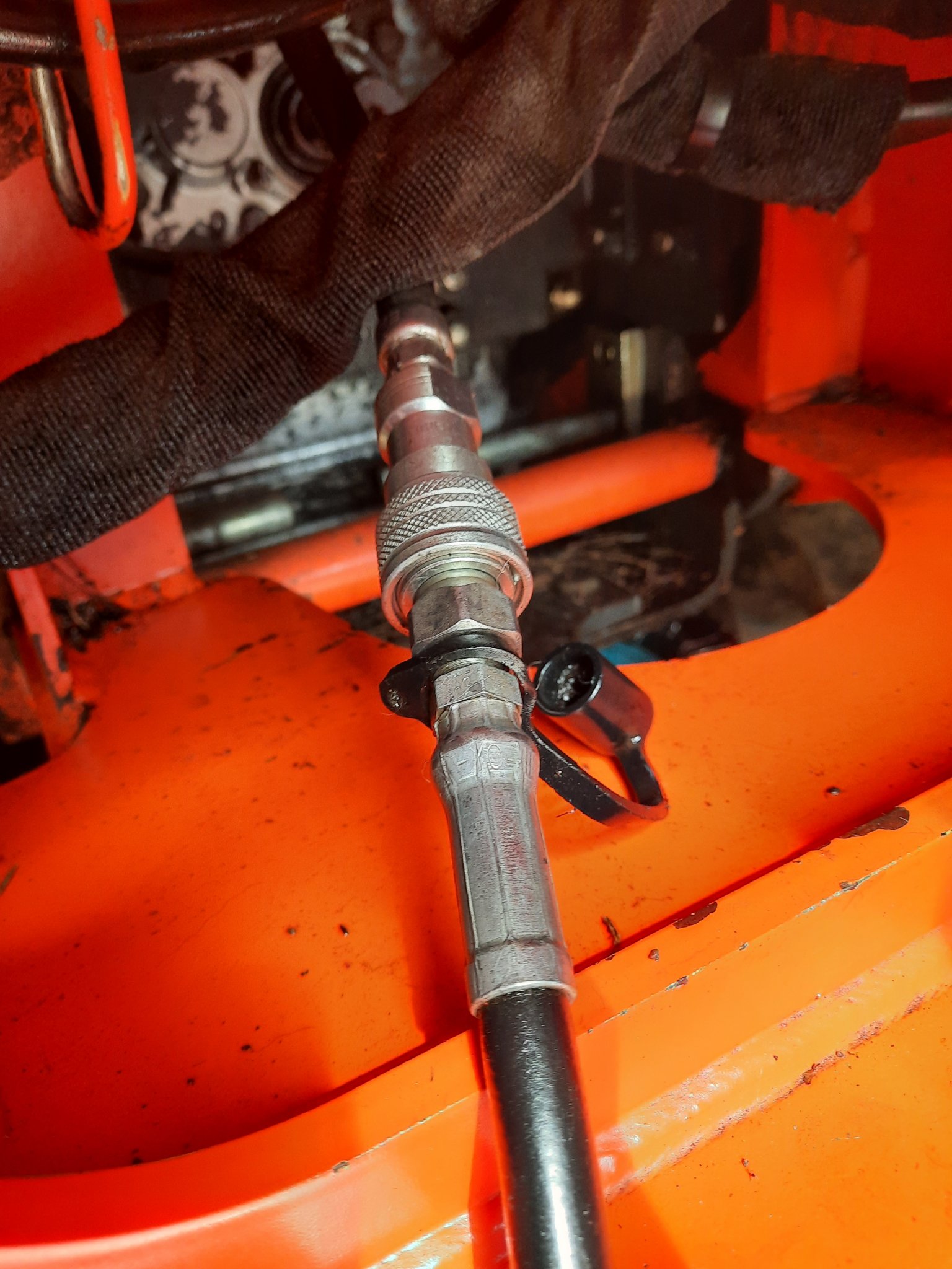

Here's a picture of the disconnect for the BT600. This line is the output of fluid to the backhoe. Obviously I didn't disconnect so I hope it's enough to give some info for identification.

The couplers have a female port that screws on to the end of a hose. Couplers with SAE ports seal withban oring and are easier to connect. Couplers with NPT ports require thread tape or sealant and are more difficult to connect.
Your couplers look like they have NPT ports. You will understand what I mean when you transfer them to your new hoses.
Here is a link to 1/4" couplers with SAE 6 ports.

Those couplers just screw onto the end of the hose. You will take them off the old hose and hook it to the end of the new hose.
Looks like the hose with male tip has male pipe thread end and is screwed directly into the tip.
The female coupler is harder to see. It may have a male NPT x male JIC adapter in it and the hose end is a female JIC swivel. Need a better view to be sure. If that is the case you need a hose with a JIC female swivel on one end and rigid male pipe on the other. Or keep the adapter and use a hose with JIC swivels on both ends.

Yes, that's NPT thread where the coupler screws onto the hose. If you measure the thread O.D. at the black plastic dust cover, we can determine the size needed for your hose. You can reuse the coupling. Be forewarned, it may be on tight. Most people recommend using liquid Teflon instead of Teflon tape on those threads.

Yes, the coupler does screw onto the hose. I replaced it once because it seemed it was leaking and it was quite a process to get it off, especially when I don't have a permanent vise. I'll give it some more thought today.
And, because it screws on to the current hose fitting, I'll just measure at the black cap to get the right male fitting assembled onto the new hose.
